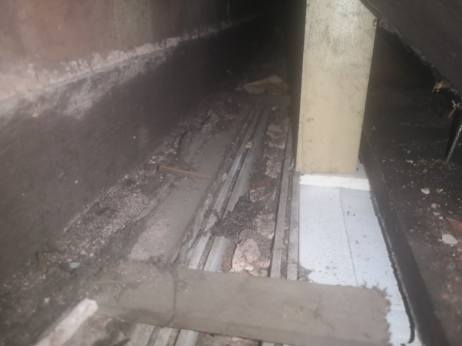

I have a 1930's build. When I moved in it already had old PVC windows.
In one upstairs room, I noticed a gap emerging between the top of the window and the ceiling. I figured I would replace since I'm getting condensation on the inside (not between the panes ,just on the inside of the window).
I'm currently having a new roof and I can see there is literally nothing above the window. No bricks, no lintel, no anything... just air! There's no wall plate on the external wall, only the internal.
I'm assuming originally there would have been a wooden framed window with bricks on top?
My question is, should I just replace the window and use trim to seal any gaps? Or should I really fit something above the window to screw into?

It doesn’t sound like a big deal
Usually the roof rafters birdsmouth over the wall plate and thus the soffit line ends up lower than the wall plate - so I would’ve expected there to be something between the wall plate and window on the inside so the window re RAL is below the ceiling.
Anyway in regards to your query, you can put in a length of studwork like say 4 x 2 to fill the gap- if there are rafter above you could screw it them to fix it in place.
Just one thing to note: if you are going to have side hung windows, be careful the top of the sash doesn’t hit the gutter…..I use to survey windows and it’s an easy thing to forget to check. If it’s a problem, choose top hung instead….although then there’s a problem screwing the sashes in.
Also I prefer to make the window a bit shorter as it looks better if the window head finishes below the soffit level…and trim the gap. (Be careful on egress compliance)
Hopefully this is clear enough. On the left you can see the interior wall and wall plate. In the middle is the top of the window and right next to it is the newly fitted soffit.

What i think i might, at this point, is take the window out. Remove the lathe and plaster. Add a bit of4x2, if I'm able to screw it in. Add new window. Foam up the void. Add some plasterboard.
