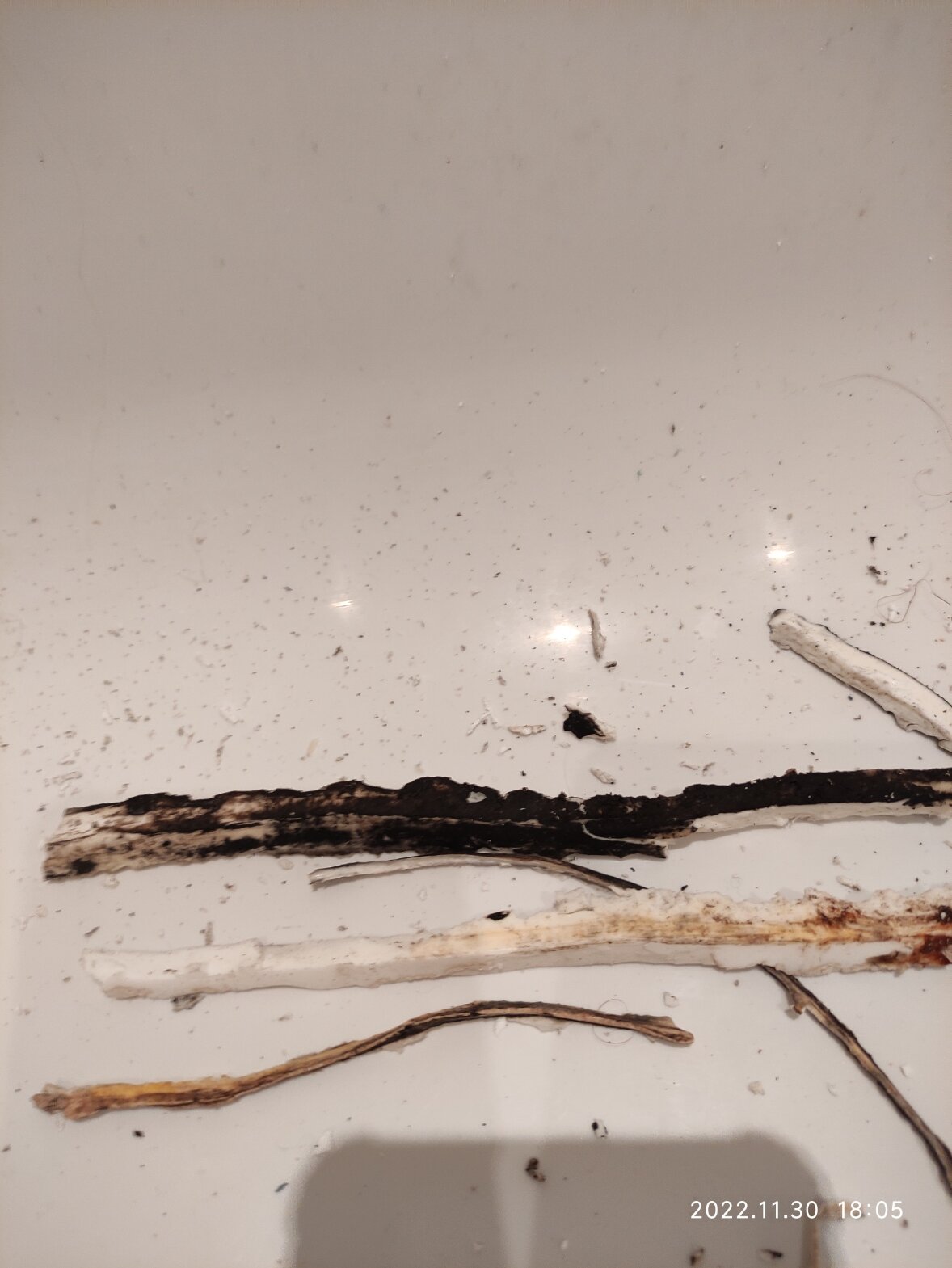

When I pulled some of the old sealant out (it's very satisfying when I manage to rip a big strip out in one piece!), I was shocked to see the back of it was almost entirely black, as you can see in the attached photo.
The bathroom has an exterior wall, which is solid brick so no cavity insulation. I'm wondering if this is just something that is going to happen until such time as we get external cladding fitted to insulate the wall?

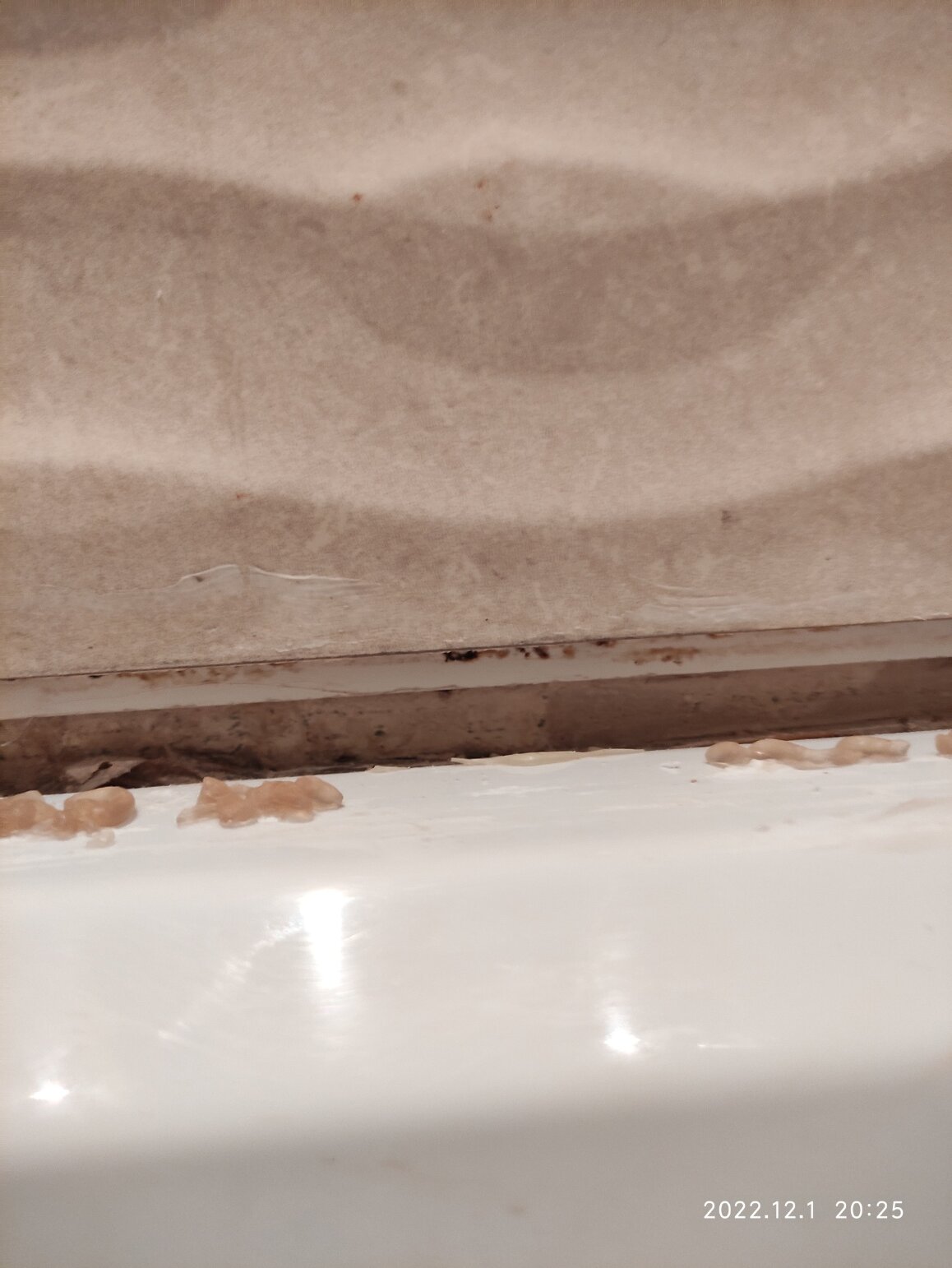

I've attached a second photo which shows the gap between the tile and the bath where the sealant was. It's quite deep, so might it be possible to just put a thin layer of sealant there to seal the gap between the tile and the bath to stop water getting in, but without filling the depth so the sealant isn't touching the wall, and would that prevent it getting mouldy? Or is there something I could line the gap with before filling it with sealant that would isolate it from the wall and prevent it getting mouldy?

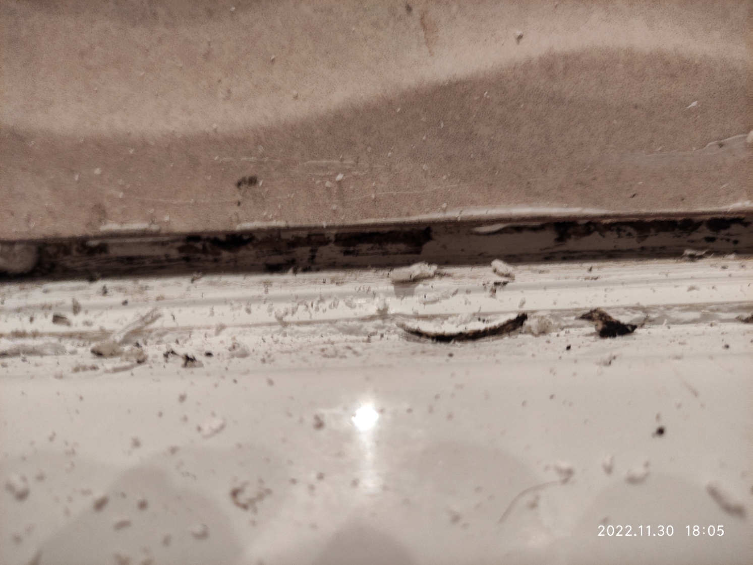

Can't really see what's what from the picture but sealant isn't a gap filler. You'd be best filling that gap (filler, plaster, sand cement or whatever you have to hand) flush to the surface of the tiles including removing the plastic strip if it's suspect. Then go to a uPVC supplier (eg Eurocell) and buy a length of trim tall enough to overlap the tiles by 10-15mm, stick it on and silicone top and bottom with a fine bead - you probably won't even need to trim the nozzle.
I've cut the horizontal part of the strip away from the vertical (which I can't remove as it sits under the tiles), so it looks like the attached photo now.
If I'm just going to stick a vertical strip on top of the tiles and then seal top and bottom, is there really any need to fill the gap first?
Sort of depends how well your dad fixed the bath and whether it will move in that void.
He's fitted some sort of thick sealant (more rubbery than normal sealant) between the edge of the bath and the wall, so hopefully that will keep it in place but to be safe I'll buy some tubes of plaster filler and fill in the gap before fitting the strip on top.
If the bath wasn't properly fixed in place, surely the plastic strip and sealant on top of it that was between the bath and the tiles wouldn't have been sufficient to stop the bath moving?
I assumed that the void that is now exposed was fully filled with the original sealant.
Yeah, more or less, apart from the space that was taken up by the plastic strip, then it was just sealant above that up to the tiles.
I've discussed it with my Dad now and he says the bath is solidly fixed in place, so we don't really need to fill the gap. His choice is to stick a 20x20mm plastic angle over the gap and seal it along both edges, but we're going to fill the gap level with the tiles first anyway, just to make it easier to stick the strip down with some double-sided tape to keep it in place when sealing it. It might have been possible to do that without filling the gap, but the strip only covers the tiles by a few mm so it may have been tricky.
