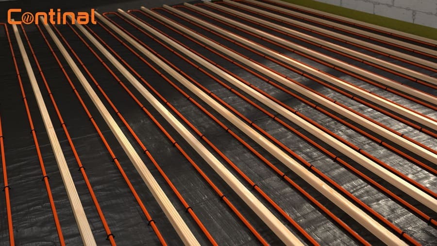

You could replace joists with bigger ones or sister existing ones then use a PUG / dry mix for your underfloor heating
or you could use aluminium platens

https://www.continal.co.uk/system/pug-dry-mix - this looks like a good find, thanks Notch7
