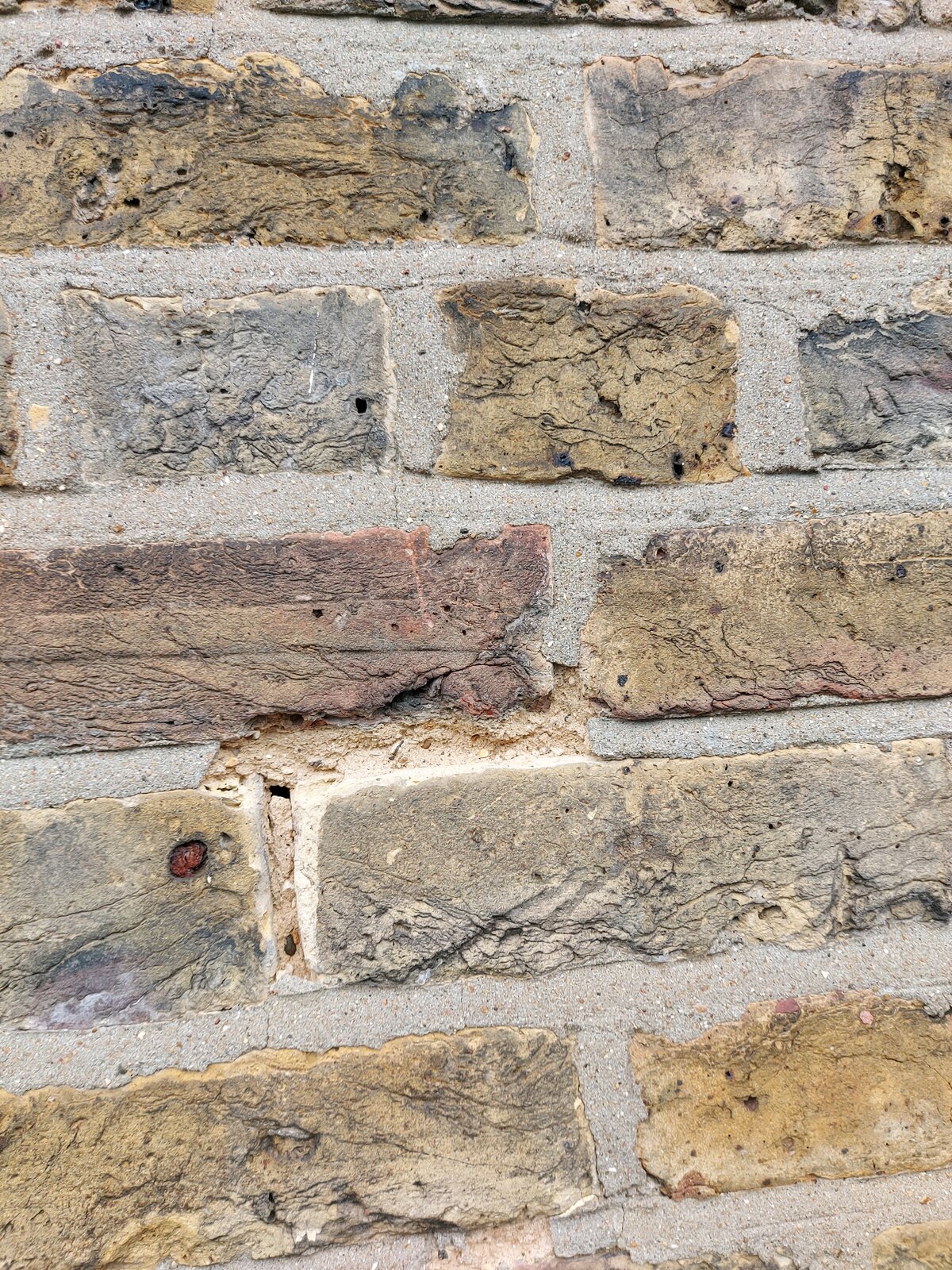

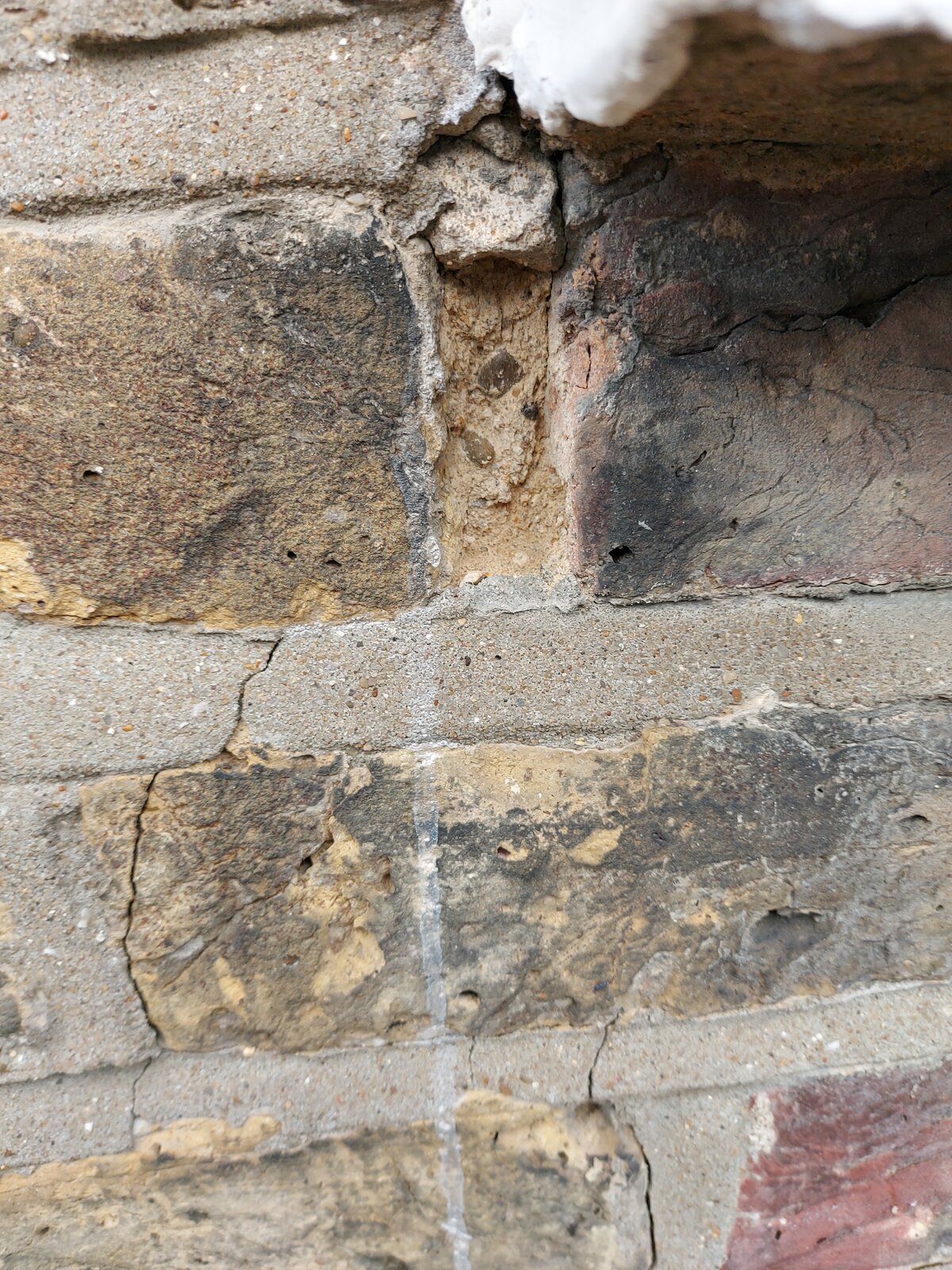

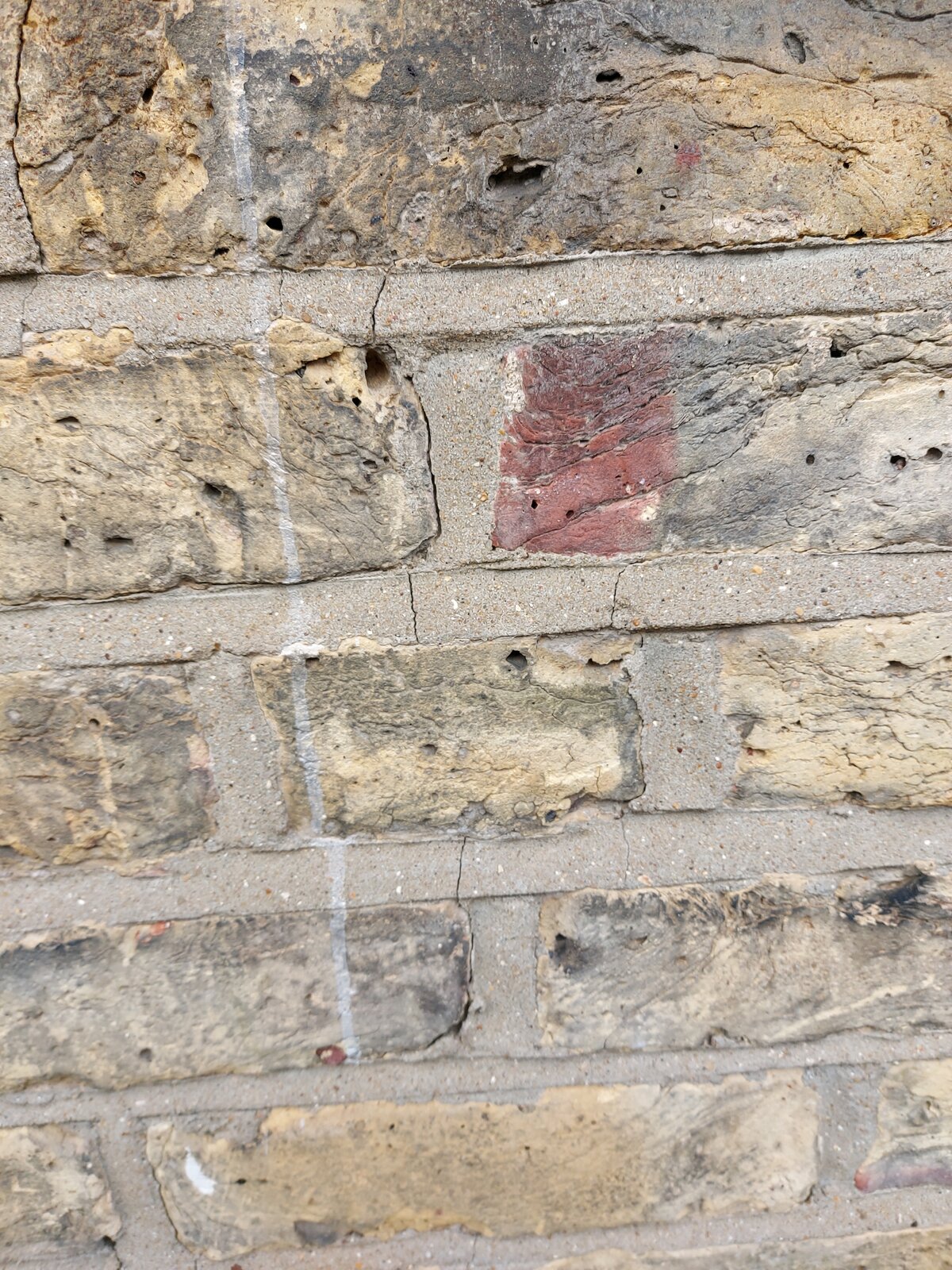

Thank you, some of the mortar has come out. I've attached a few pictures of the loose mortar areas. I don't think a repellent would work. This side of the bungalow takes a severe bashing on this side when the rain comes in.

Looks like it's been 'repointed' before. In the last image, you can see the lime mortar underneath the more modern mortar.
It wasn't raked out properly last time, not deep enough.

Does this definitely look like lime mortar underneath? I think if this is the case, the modern stuff stops the wall breathing - is this the case? Do I have to get everything done again? Or can I just have those damaged areas sorted out?
I would say it looks like lime based mortar, cement based tend to look more grey on average. Apparently you can tell if there's lime present... by dropping a bit of mortar into some vinegar, if it fizzes a fair bit, it's lime based, cement may fizz slightly. I've tried this before, but couldn't really tell the results.
Most folk will just rake out the affected area, perhaps you need to post a photo showing more of the wall.

It does look like lime mortar, over pointed with a strong cement mortar
The issue is not one of breathability but flexibility, and that's why the mortar has cracked and even cracked come of the brick arrises.
Continual cracking is a risk as long as the cement mortar remains, and so consider changing all of it for a lime mix. Raked out at least 20mm. Look for posts from Stuart45 who is the oracle on lime pointing for more details.
