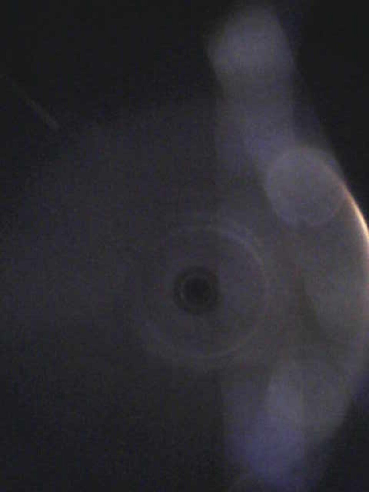

I don't plan on a header tank, just taking water from well below the top of the tank, probably from the pressure relief valve pipe. My only real issue is that I dont know enough about the baffle or bubble. I put an inspection camera in but does seem to help. How do I disable that?

I don't think the Unistor has an internal baffle, I believe it uses an external EV.

"I don't think the Unistor has an internal baffle, I believe it uses an external EV"
That kind of makes sense as this is the photo from inside looking up at the main draw pipe. The centre pipe is only about 5" long until it exits. It doesn't look like a baffle and has nowhere to move, however it doesn't look like the top of a tank either.

Ah yes, after a bit of research you are right! The uniSTOR does have an external pressure tank and no baffle/bubble - which is great news! That means the tank is not an unvented tank, just that it is strong enough to be used in an unvented system. There's nothing stopping me using it as a vented tank for gravity fed system.
