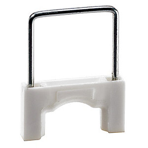

I wonder if they are also going to try to 'ban' plastic pipe clips in some situations, for similar reasons?I thought it would be something like that. i.e. To do with the new focus on non combustible materials.
Kind Regards, John
I'm surprised they haven't made another re-introduction with amendment 3,
Yes, but only for cables in "escape routes" which are "liable to collapse in the event of fire" ('Note 2' of new reg 521.11.201) - so it doesn't really apply to very much.So are non combustible/melt proof cable clips a requirement under the new amendment ...
I can but presume that they are talking about cables high up in escape routes which could fall down and impede escape if their attachments (plastic clips) melted.And dare I ask how and what "escape routes" and considered liable to collapse?
You may rightly argue that fixing cables to ceilings with clips which give way in a fire is irresponsible and against present regulations but that is nothing to do with amendment 3.
If future requirements extend to the likes of this then that will be then.
Would it?An escape route would definitely cover hall/landing and stairs.
Would it?Beyond that, it would depend on the layout of the house.
Would you?If you needed to go through the living room from the kitchen to get out of the house, then you'd have to include that too.
422.2.1 says nothing about cables that may "collapse" due to clips etc. melting in a fire. It talks only about the wiring system not being 'fire propagating'.Does 521.11.201 not just refer you to 422.2.1 which was there previously - before amd3?
AIUI, and as has been said, conventionally it consists of halls, landings and stairs - and becomes particularly important, regs-wise, when there are more than two stories.As you implied, what is an escape route in a dwelling?
What do you mean by 'conventionally'?AIUI, and as has been said, conventionally it consists of halls, landings and stairs - and becomes particularly important, regs-wise, when there are more than two stories.
