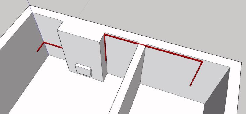

Hi all, I'm just about to buy a new house and have a lot of changes planned. The first step is replacement of a back boiler/tank heating system with a combi-boiler. Ideally I'd like to install the new combi at the rear of the house but the gas supply is at the front - I was wondering whether it is possible to run the gas pipe inside the house (under the floorboards) as shown in my second diagram.
Here is the existing layout (as best I can tell):
There is a gas meter on the front wall of the house, the gas pipe runs inside the wall until it enters the chimney breast (which is on the party wall - the house is a semi) where it feeds a back boiler and gas fire. Then the gas pipe runs up the side of the chimney to the ceiling, over a supporting wall into the kitchen where it feeds a cooker.
I would like the pipe rerouted as follows:
Up the wall (either outside or inside) of the house until it reaches ceiling height, then through the ceiling void until it reaches the point where the joists are already notched out for heating pipes. It splits into two, with one leg heading off to feed the cooker. The other leg crosses the joists using the notches before turning again and heading off through the ceiling void to reach the new boiler at the rear of the house.

All sounds generally reasonable.

Bear in mind, the length and number of bends used will determine the size of pipe needed, which will in turn affect the size of boiler you get.
Hmm, I hadn't considered that either. In the new layout the run from the gas meter to the tee is 18ft. From the tee to the cooker is 12ft. From the tee to the boiler is 28ft.
I was thinking of getting an intergas boiler and asking the plumber to advise on the size based on the eventual layout, which is going to be: One upstairs shower room (no bath) with basin, a downstairs toilet with basin and a kitchen with basin. In terms of size the house is a small three bed semi with seven radiators.
I was hoping to get away with fitting the 24/18 model, would I have to go bigger because of the gas pipe?
Your gas fitter on site will advise, if anything the gas pipe could restrict the size of boiler.
Ah, now I understand. Long runs and bends restrict the flow so it becomes harder to feed appliances that consume a lot of gas. Hopefully my boiler will be quite small but, as you say, I'll get the fitter to advise on what he thinks best. Thanks for your advice, gigz.
As a VERY rough guide a 24 kW boiler can be fed with about 20m of 22 mm tube.
But it needs to be calculated EVERY time by the Gas Reg engineer who is going to fit it.
Longer and part of the tube will need to be in 28mm. Most effective to do the bit near meter with many elbows in 28 mm.
Tony
It sounds like I'll be okay, I was a bit worried for a moment that the distance would mean that I'd barely get enough gas trickling out at the far end to boil a kettle!
