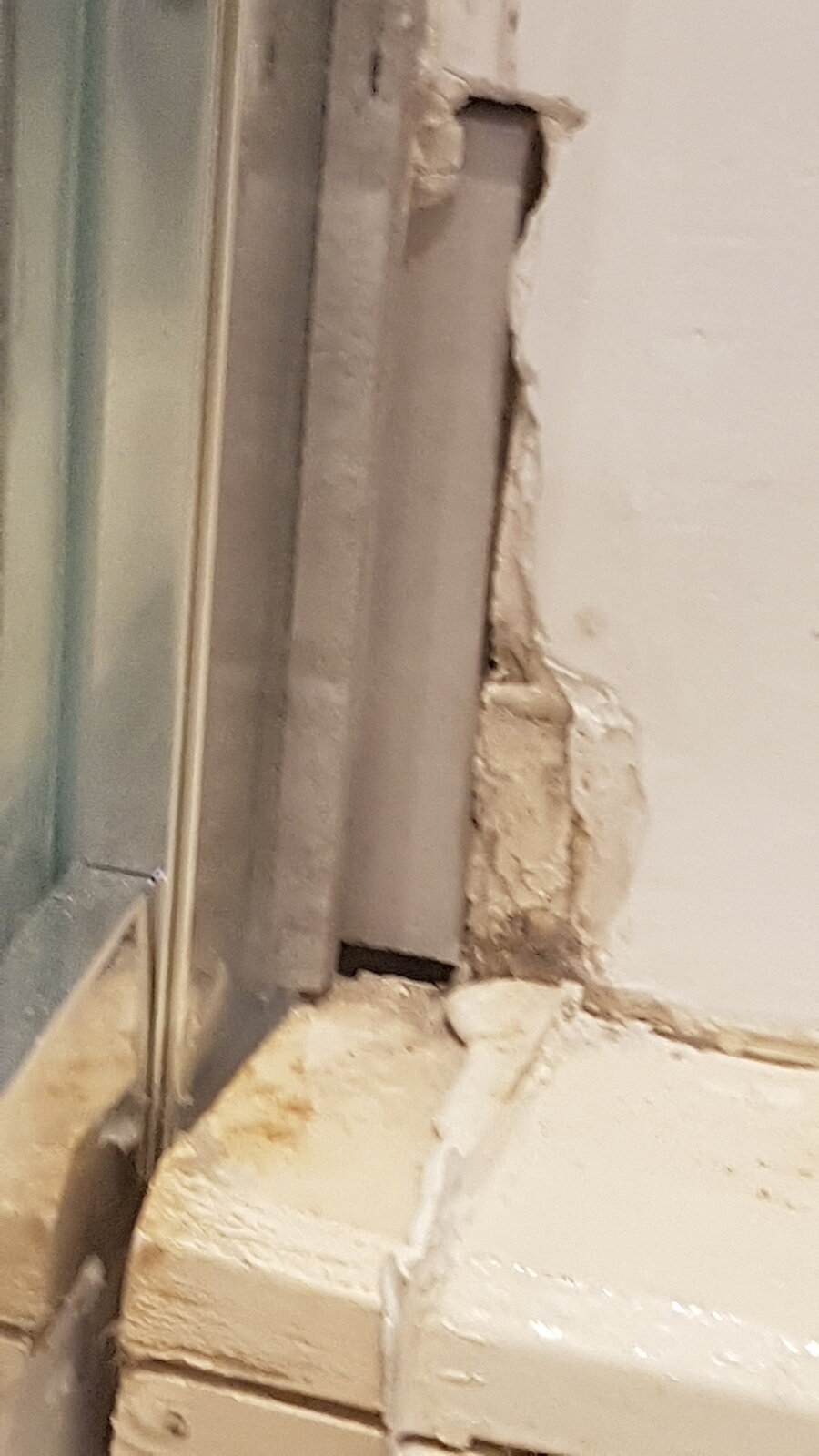

Nope no need for a raised edged deep tray, but the wall board does need to be down past the edge of the tray so when you run silicone along both tray edges and then push it against the wall it fully seals along those contact edges.
All they needed to do was run the board on the left down to the floor and the tray would then fit to that and square to the right hand wall. All that could have quite easily have been avoided by a 200mm piece of plasterboard!
If the tray doesn't have that complete wall seal then I can just about guarantee the shower will leak at some point in the future. It also ensures that if the wall is square then the tray will be too.
I'm sorry to say that I wouldn't accept that if I was the gaffer, I'd have it pulled and re-done.
Yes I will definitely be having a word with him tomorrow! Just want to be fully aware of the situation first and you've definitely helped me there :)
So you say they should have run the board to the floor on the left and then fit square to the right hand wall - but would the wall on the right still need plasterboard over what the tray is up against at the moment? From the attached pic after it was all ripped out, it looks like the right wall did have an additional layer of plasterboard that didn't go down to the floor, possibly down to the tray which I think had a lipped edge (the previous tray was higher also). It's just that an additional layer of plasterboard on the right I assume is prevented from going to the ground by the piping.
So in a nutshell the board on the left in that pic, they seem to have done the same on the right, but the error is pushing the tray underneath the board on the right, rather than boarding down below where the tray would sit (if not to the floor, at least down to the bottom of where the tray would sit) and putting the tray flush against that?
Sorry to ask so many questions and hope I'm understanding it right!

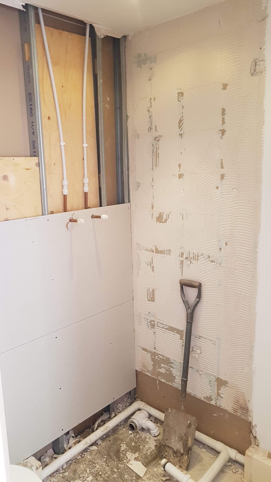

Going by the picture in post #24 they have left the right hand wall as it is, once the tiles were removed and the left hand wall has new plasterboard but with a gap at the bottom.
Now if the tray has been pushed up tight to the right hand brown wall and against the metal framing on the left, not a piece of plasterboard, when tiled the tray would be out against the finished tiling. How high does the riser kit lift the tray against the size of gap at the bottom left and does the tray edge sit above the gap?
That why I asked about the sizes, you said there was 30mm either side of the shower tray lip to the tiles which would suggest it's square to the corner and each side but then you said one edge was longer than the other. If it was a normal quadrant tray then the square sides should be equal, therefore if the tray was square to the corner then the edge length would be the same as well as the gaps and then the enclosure should fit.
If one edge is longer than the other then the tray isn't square to the corner. Hence the need to check if each edge is tight against plasterboard on each side. You shouldn't be able to get anything (a screw or similar) into the gap between the tray and the framing if the tray is sitting tight to it. If you can then the tray's is sitting on the board higher up.

Ah yes I see - I think they did put new plasterboard on the right side too judging by this current pic (see attached) - that plasterboard seems to be what the tiles are attached to (and that plasterboard then sits on top of the tray, and the tray goes further back and is flush to the brown wall (as mentioned I can't touch the back of the tray on the right side at all), explaining why there's not enough room for the enclosure as too much space is lost.
The left side is definitely pushed to the metal frame and I'm 99% sure plasterboard is sitting on top of the edge of the tray, hence why I can put my hand behind the tray on the left side and feel the enamel on the back, then move my hand up to the plasterboard in a totally level motion (i.e. no bump). So the plasterboard seems to be sitting on top of the tray, like the right side, but it's flush to the edge of the tray whereas it goes further back on the right (I assume because the studs stopped them doing that on the left).
Obviously it's the fitter's job to sort all this - I just want to make sure he does it right next time! I assume I need to tell him to:
(a) rip it all out
(b) plaster down to the floor on the left or at least so it will cover the back of the tray (is there any need for it to go to the floor as long as the tray sit against it?)
(c) plaster as far down as possible on the right again so it will cover the back of the tray (to the floor doesn't seem possible due to the pipes)
(d) walls tanked (is this essential?)
(e) fit the shower tray flush against the plasterboard (not underneath it...) and seal
(f) re-tile
(g) fit the enclosure and seal on the outside only as the instructions say
Sound right? Thanks so much for being so helpful!

Basically it needs a completely square/flat corner, top to bottom. (I then tank it)
The tray then fits flat and tight to both of the walls, edges sealed up tight against the walls. Tray should now be nice and square. Tile down to the tray and then seal again. Fit enclosure (is it the right size?) and seal externally.
It isn't really rocket science and he should know when it's wrong and just get it fixed.

Well, the situation can be rectified by cutting out the bottom run of tiles, take the tray out, replace the board, (tank?), refit the tray (alter the waste) and seal, refit the tiles and seal again. Are there any tiles left, if not then the old tiles need cleaned back and reclaimed (fun fun, dusty and time consuming)

Apologies for butting in with more bad news - did not see anyone else highlight this issue (amongst all the others) --
To boost its height the tray leg appears to be standing on plasterboard! Worst material ever as a spacer/shim.
