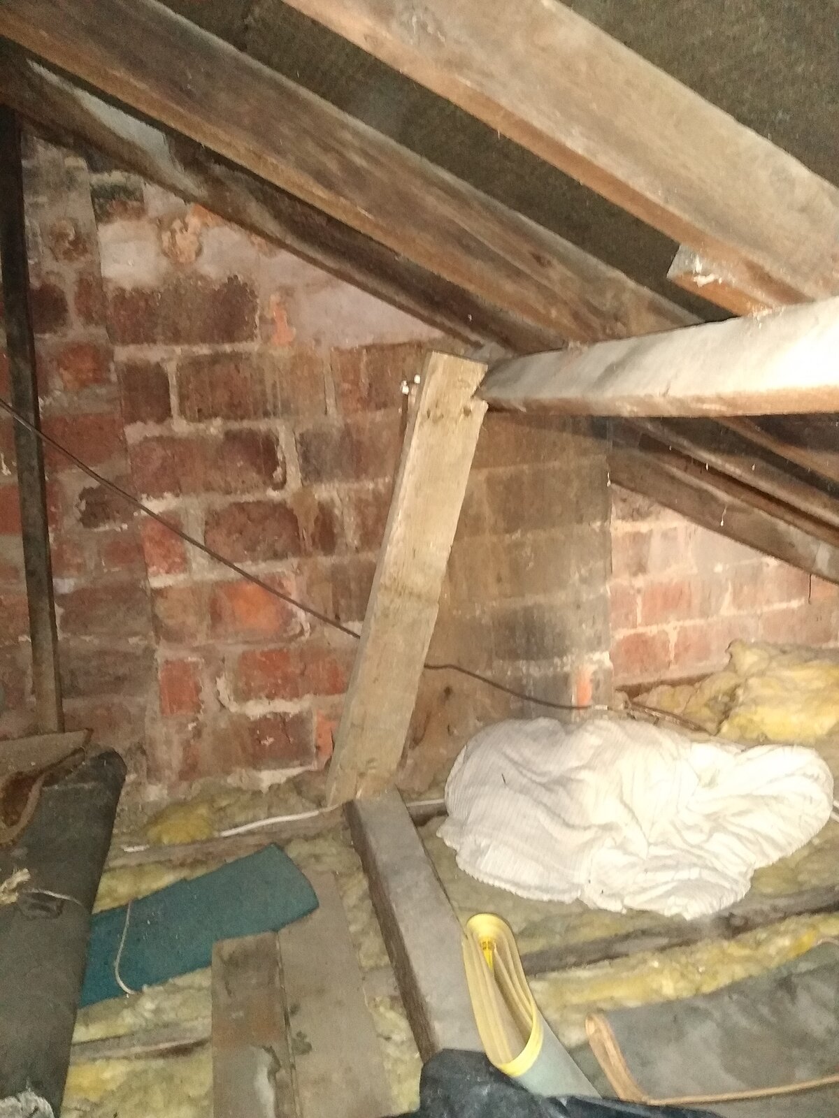

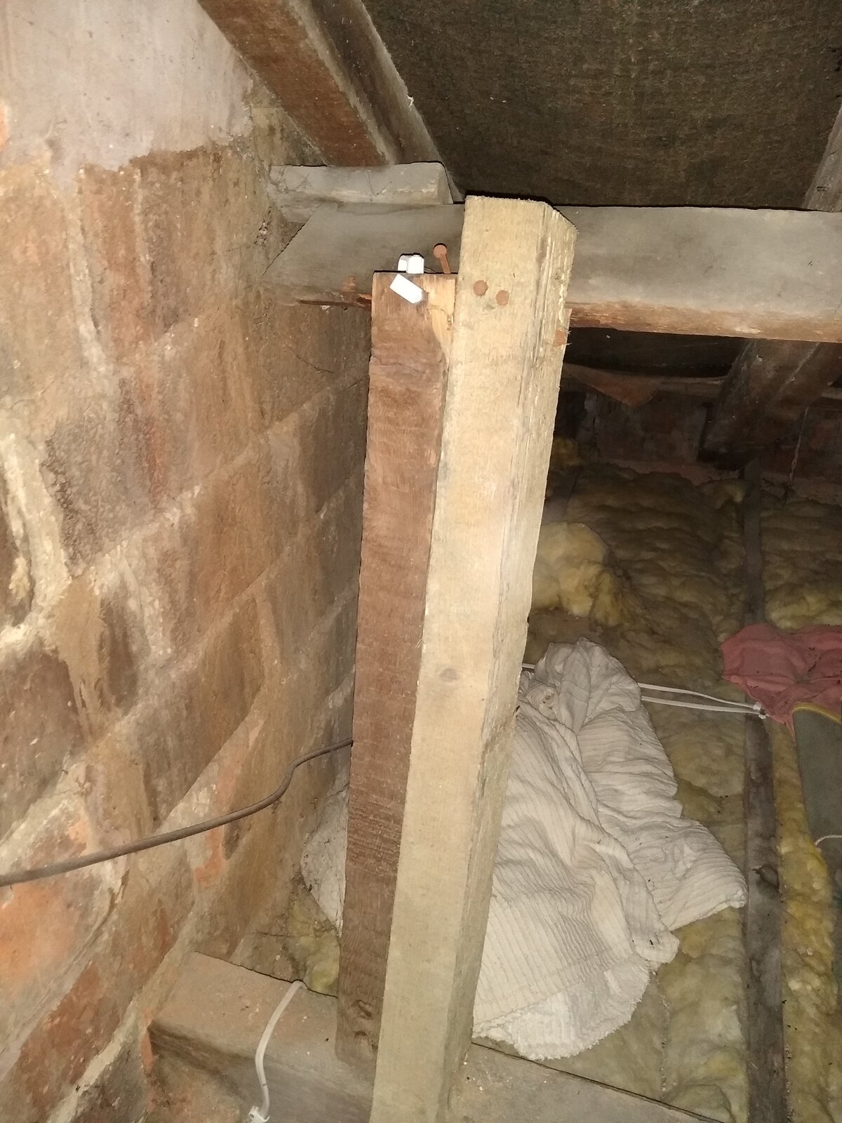

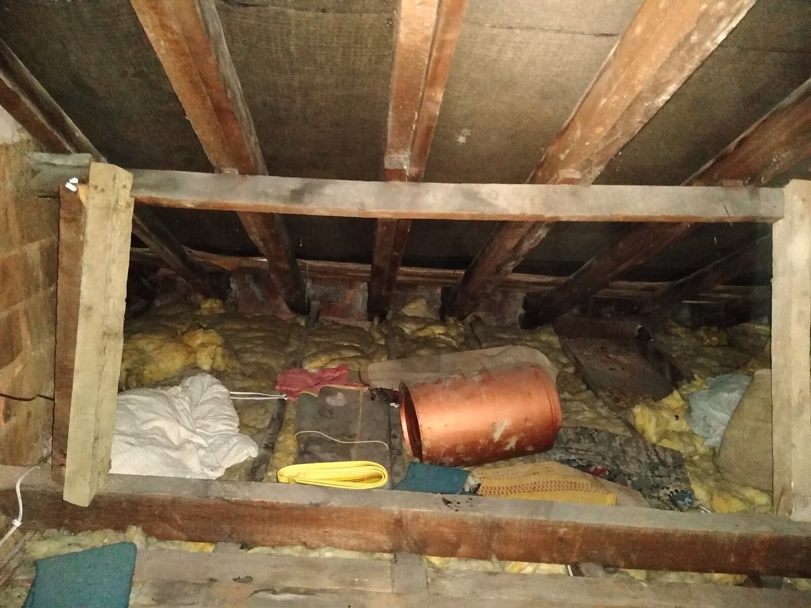

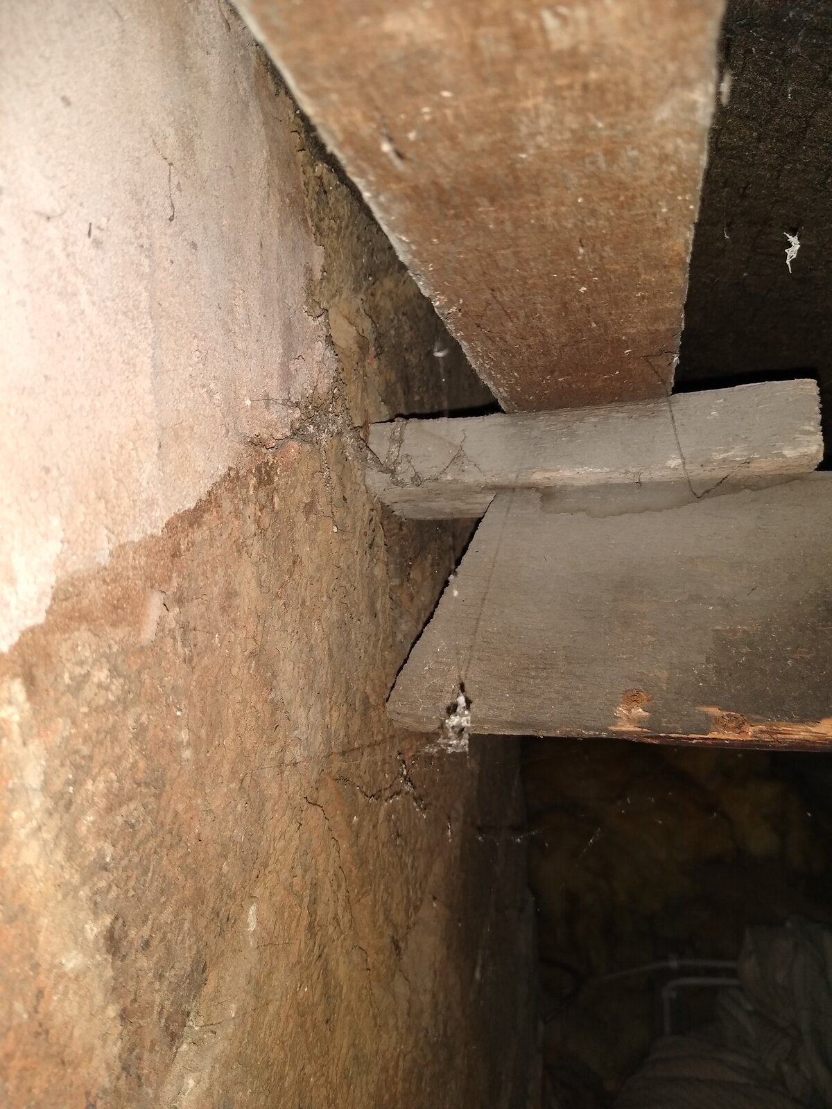

- Photos included for this. 1 of the purlins is supported by angled trusses anchored to strut and by being embedded in both the joining walls with neighbours. However the other is only supported by the trusses, one side is embedded into neighbours wall, the other side of it is the thick stone chimney breast and it hangs loose there. Is it possible to add a bracket for the purlin into the chimney breast for extra support or will it not have the integrity to take any weight?

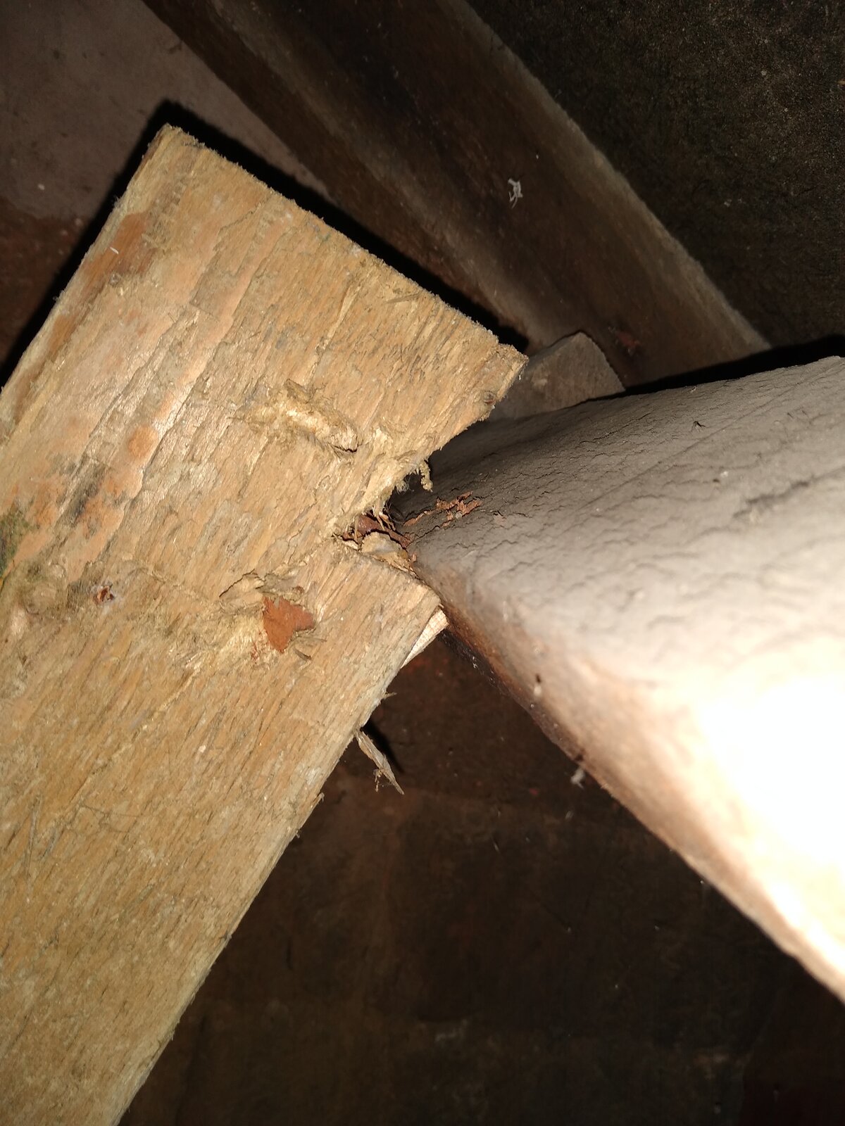

- The truss on the unsupported side seems to be a cowboy job and it's just sitting on the strut rather than being anchored to it or the floor in any way. It has clearly slipped at some point or is slipping slowly and coming loose which is obviously a massive worry, especially with the possibility of extra weight. Will the roofer be able to replace this safely or does it need another trade?

I have to say the roof looks fairly dodgy already, with a very undersized purlin and rather suspect struts. Even if you replace the slates with modern artificial slates it would probably be worth getting someone to inspect the roof timbers to check their adequacy and potential repairs/strengthening.
That has to be one of the smallest purlins i've ever seen in my 110 years of practice.
It won't collapse, but concrete tiles will turn that into a banana-shape.
