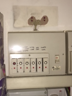

How hard would it be to DIY retrofit RCDs to a quite old consumer unit?
I attach a photo, I was thinking is there a matching RCD to replace the main on/off switch? If yes, how would I bypass it if it tripped all the time?
The photo shows the left hand side consumer unit, it does the lights and the washing machine, whereas there is a larger one on the right which does the power sockets etc.
You could not safely do anything with that board, it would be pointless
No sensible way to fit RCDs to all those circuits without replacing the consumer unit(s).
Considering those were the most common consumer units, you can't get RCD main switches or RCBOs to fit.
You could fit stand-alone RCDs outside of the board, but a new board is the answer.
MCBs are available to fit those boards, but not RCDs. MCBs wouldn't provide RCD protection, so MCBs would be pointless.

I have done just that with a Wylex board like the one you show, I have an 8 way DIN rail box above the two Wylex boards and two RCD's in that box one feeding each board, this was done back in 1990's when RCD consumer units with more than one RCD were rare, I did not want a 100 mA RCD and I did not want whole house on one 30 mA RCD so this allowed me back in the 90's to have a board similar to what is fitted today, I have a modern board ready to replace it when I get time.
The work fitting a box and RCD's and wiring it all up today is a non starter, the ready made consumer units are now made of steel and have all the buzz bars and rails built in, when I did it I had never seen a twin RCD consumer unit, and RCBO's were always two modules thick, and the RCD was four modules thick, in both cases now half the thickness.

I was hoping for a one for one replacement of the existing switches with an RCD switches to make it an easy job...
per the above, there is no such thing for your ancient board. If you need RCD protection then either replace the CU for an RCD one, or add RCD(s) externally to circuit(s).
