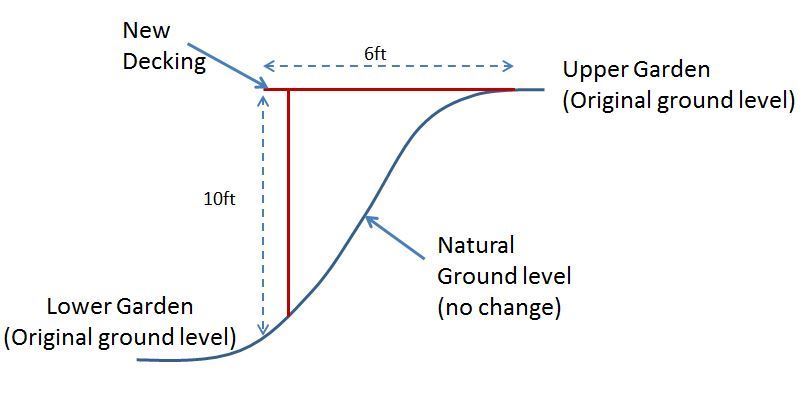

In response to the other question, the end of the new decking that is connected to the upper garden is level with the natural ground level of the upper garden. Therefore yes the decking starts off at natural ground level.
and with the powers of modern technology I bring you...... (my best endeavours)
I've found several other "internet sources" including enforcement complaints that say the advice in this thread is wrong and that the 30cm rule isn't applied from the highest natural ground point. I'm not suggesting they are reliable, but given planning law is as exciting to read as the traffic signs and general directions SIs I'm trying to find something where someone else has done the leg work..

As long as a part of your decking is no more than 30cm above the natural ground level, it doesn't matter about the height-difference elsewhere, even if there is any overlooking.
DON'T fall into the trap of applying for planning permission - they will take your £172 and then issue a refusal.
Leave the ball in their court, but if they do issue an Enforcement Notice, you would have to appeal it otherwise the Notice takes legal effect at the specified time.

You measure from the highest point wherever that may be that part of the development springs from. Look at the diagram in the loopholes doc.
Are there rules around size of decking? I know there are issues with permiable surfaces at the front of houses but i do not think we have a surface water issue. The garden is quite large and this is a small % of the overall size of the garden (<50%). Its also not attached to the house so it is not an extension.
Sadly I have not got a picture from the lower garden only from the top which doesn't show anything helpful and it's been a little dark by the time i get home to take one the last few days.
There is no limit on the superficial area of the decking, just that it must not be more than 30cm above the natural ground level, wherever that is; we can't seem to get to the bottom of this!
