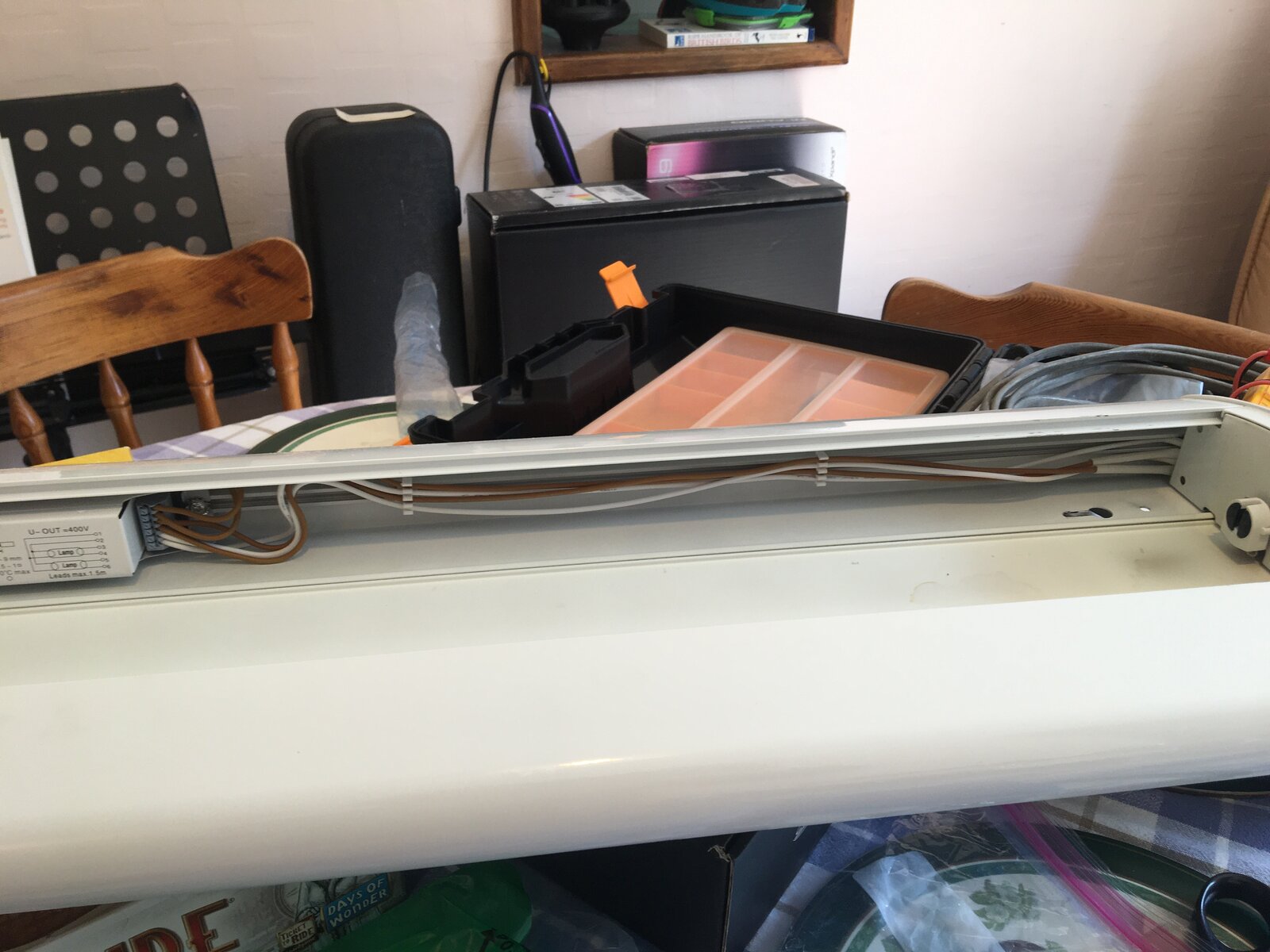

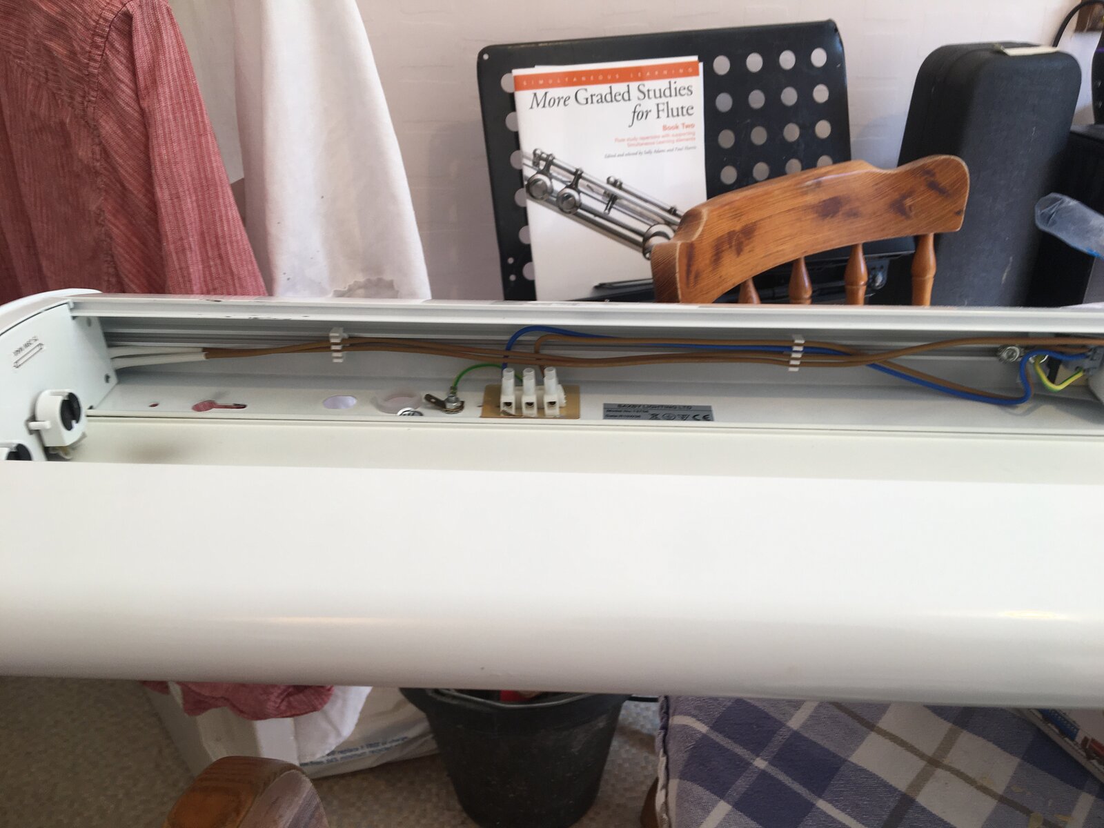

Both bulbs failed at exactly the same time, and there was a bit of a "pop" sound when they did.

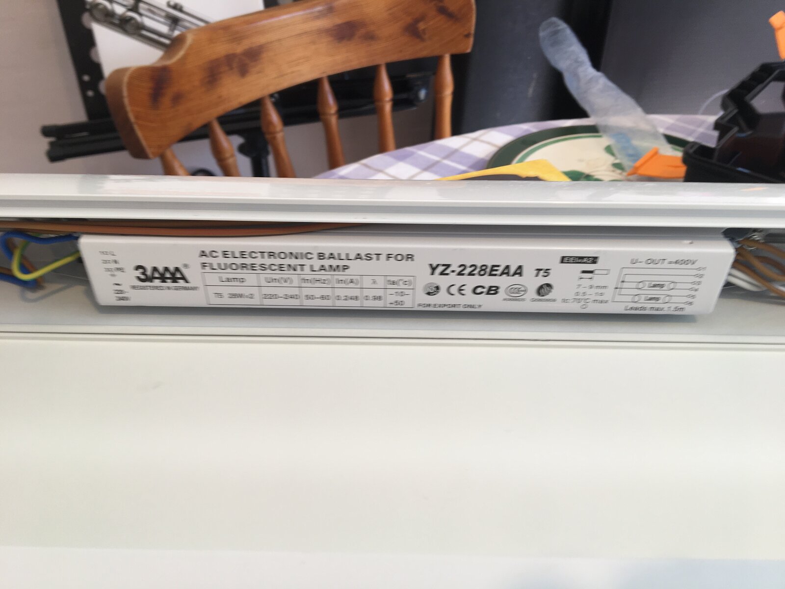

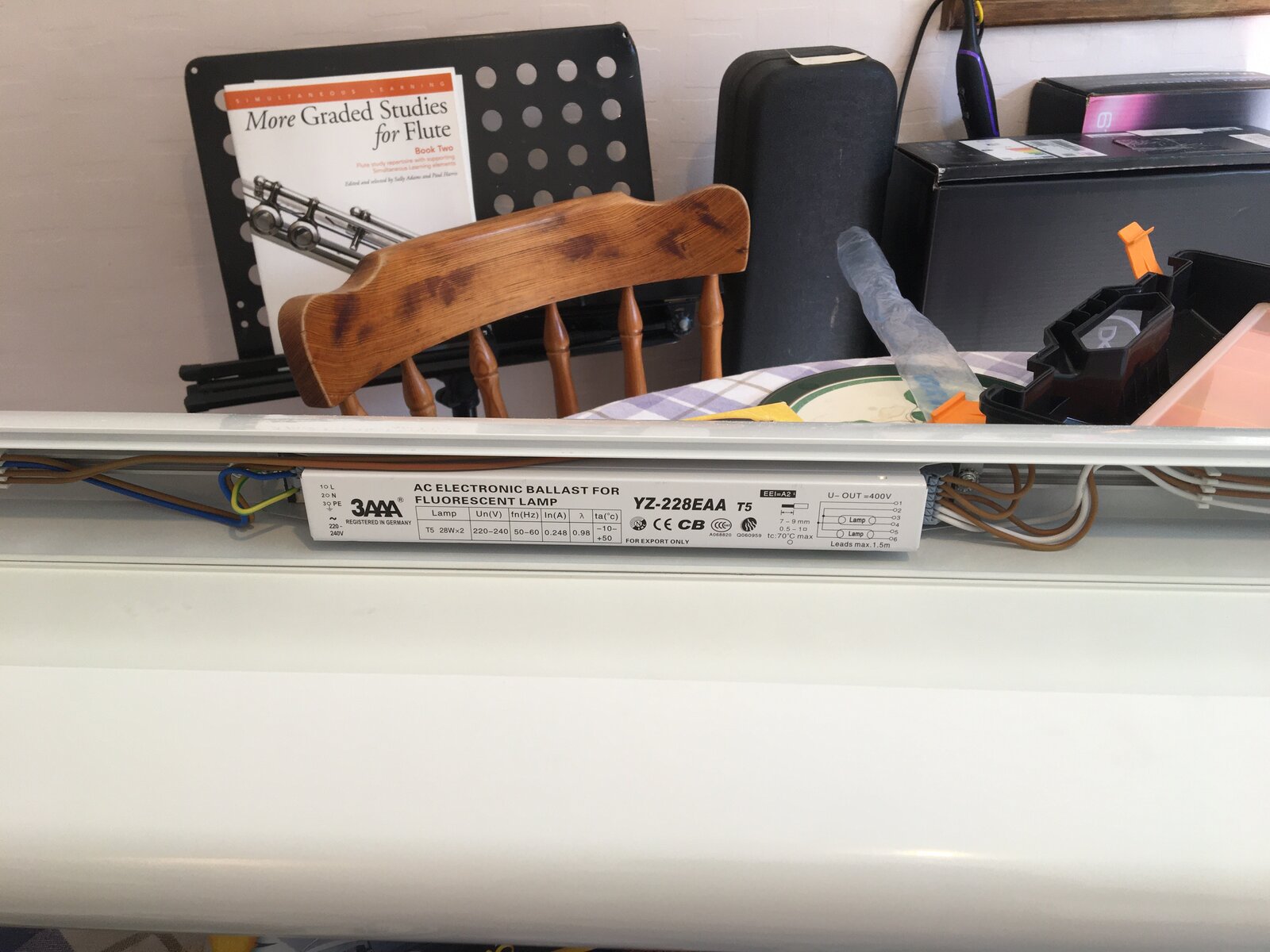

There's another fitting on the same circuit, on the same switch, which works fine. I've just put a meter across the leads feeding the fitting and got 241 volts. So I'm assuming that the ballast is kaput.
Replacement ballast seems to be about £35, and is maybe a bit fiddly to replace (are those wires easy to get out and back in?).
How would I rewire this to take LED T5 replacements?
It looks to me as thought it's wired so that it will take two types of bulb - either L and N at the same end, or L and N at opposite ends. But I'm just guessing.
I'm not sure about the colouring of the wires coming OUT of the ballast. Is brown live and white neutral?
As far as I can tell from search all I have to do (hah!) is join all the lives to the live feed, and all the neutrals to the neutral feed.
Or of course I could put a new LED fitting in, but it would look a bit cob, as there is another identical fitting in the same room.

The electronic ballast is got rid of, one side only of the LED tube is power in, the other side is a short circuit, so line in to one pin at one end, then a wire from other pin at same end to a fuse which is same shape and connections as a starter, then other side of fuse to pin other end, and remaining pin to neutral so all pins wired in series, that way it does not matter which way the tube is inserted.
I wired line and neutral to one end only which does work, but if some one replacing tube puts it in wrong way around it is a direct short circuit, so not a good idea.
Adding to Eric's comments just label the end up with the Power, when you insert them the Tubes are marked. You don't necessarily have to remove the ballast it just needs by passing.
If it's disconnected and by passed it will just sit in the fitting!

You would probably be better served to replace the fitting with something designed to sink the heat away from the LEDs. Is there a reason to keep the original fitting?
Thanks for all the answers folks. Sorry not to have replied, or acknowledged the answers earlier. For some reason I wasn't getting the notifications.
In the end, given that a new ballast was going to be £35, or the fact that T5 "shaped" LEDs don't seem to have quite enough output, I just installed a new LED fitting. One of these:

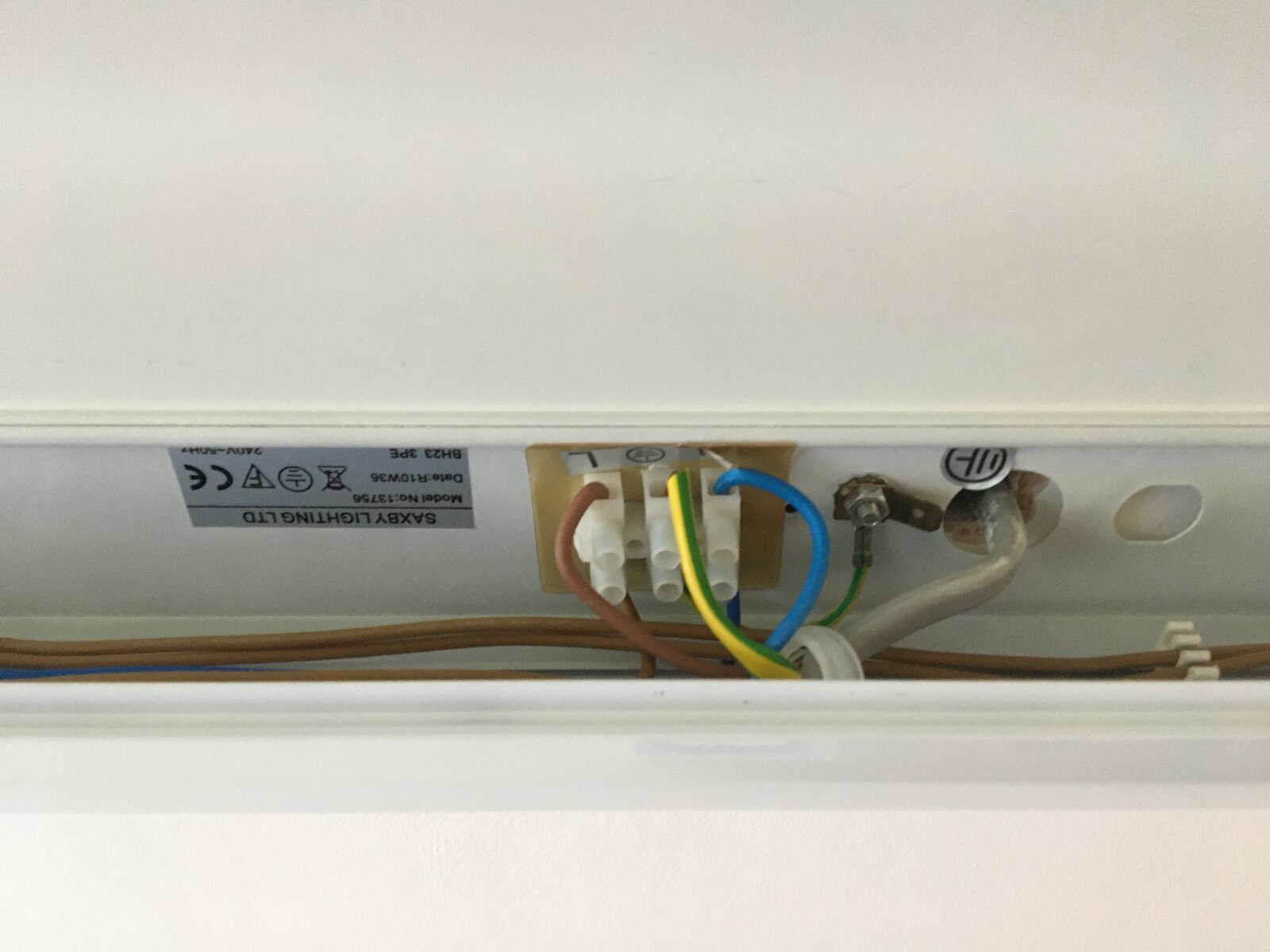

One question though - the supply was twin and earth. The fitting only has live and neutral, and it came with a snap-in fitting to join. On the supply I bent the earth back and taped it with electrical tape. Is that OK?
