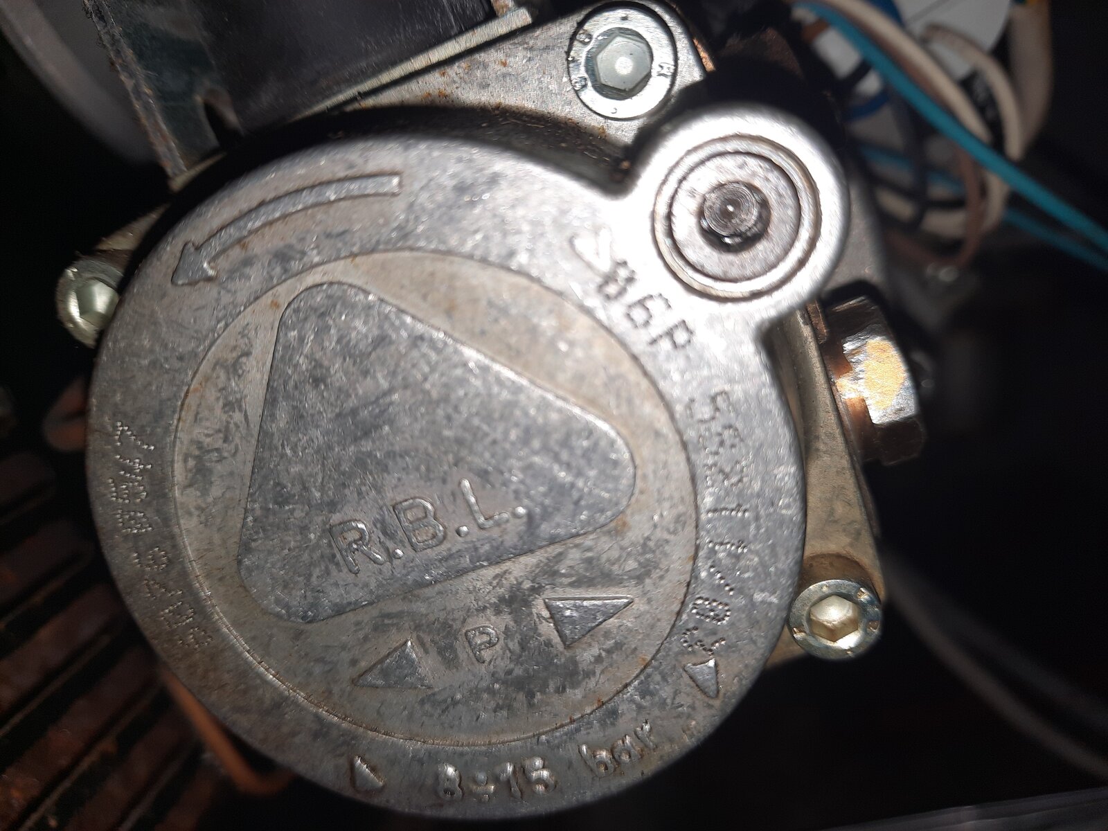

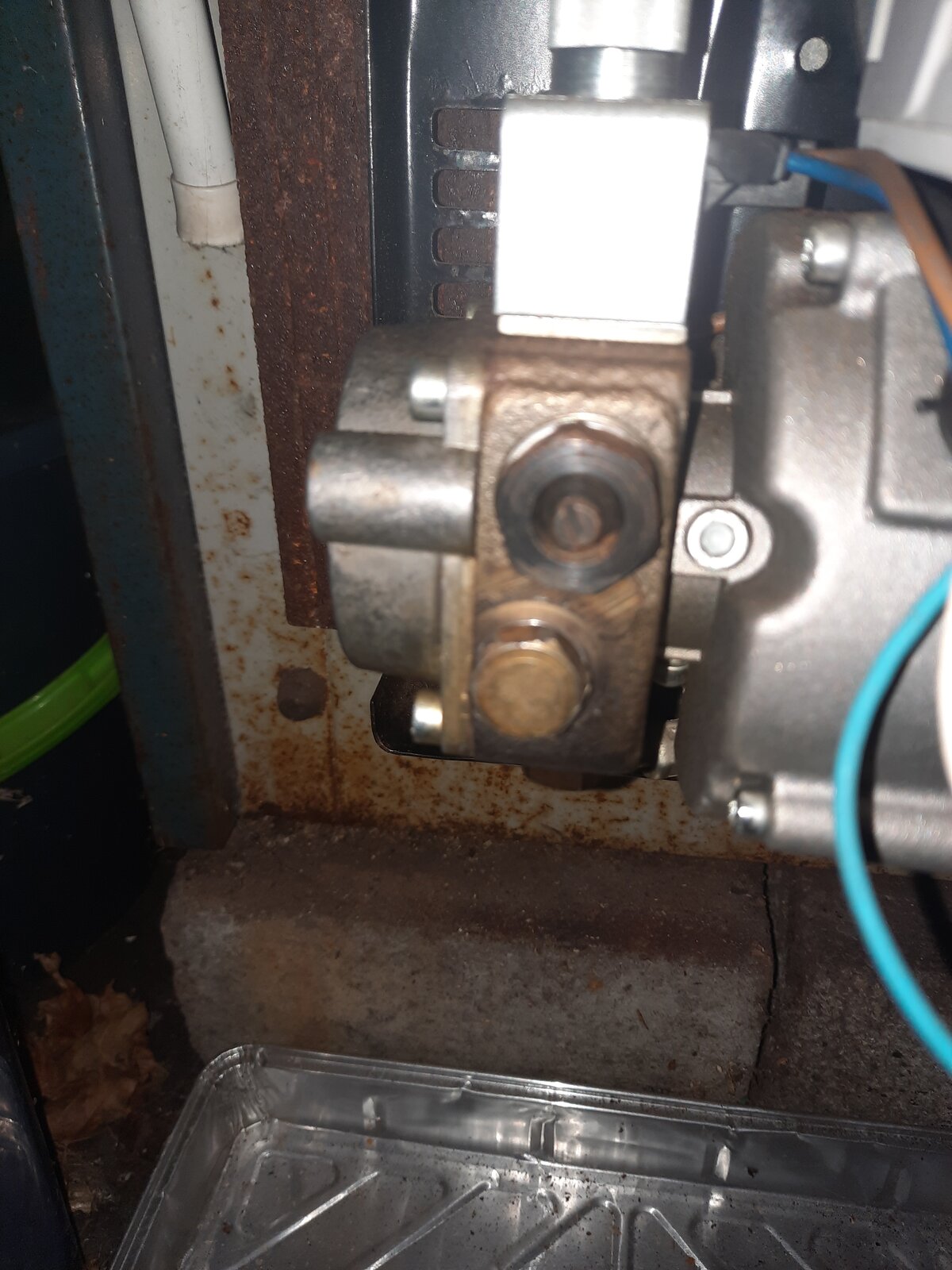

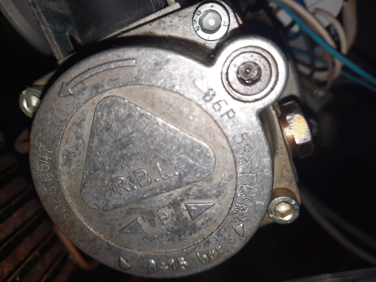

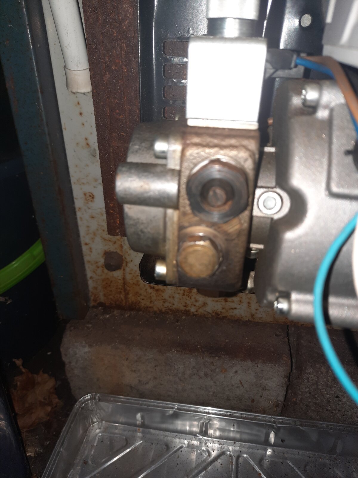

Hi,
Not sure if this is the right place for this but would be grateful of any help! Trying to bleed a Riello burner and I'm seeing loads of different instructions online so not sure whats relevant to my own. Can anyone let me know which part needs loosening from the images below? I think its the second one (side of pump) but want to be sure.
