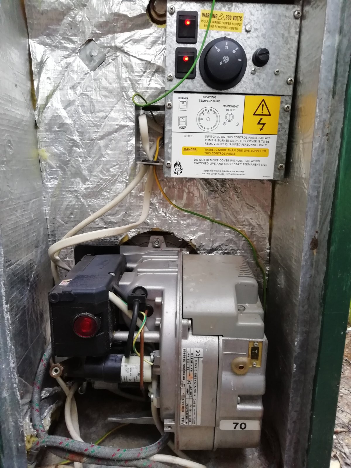

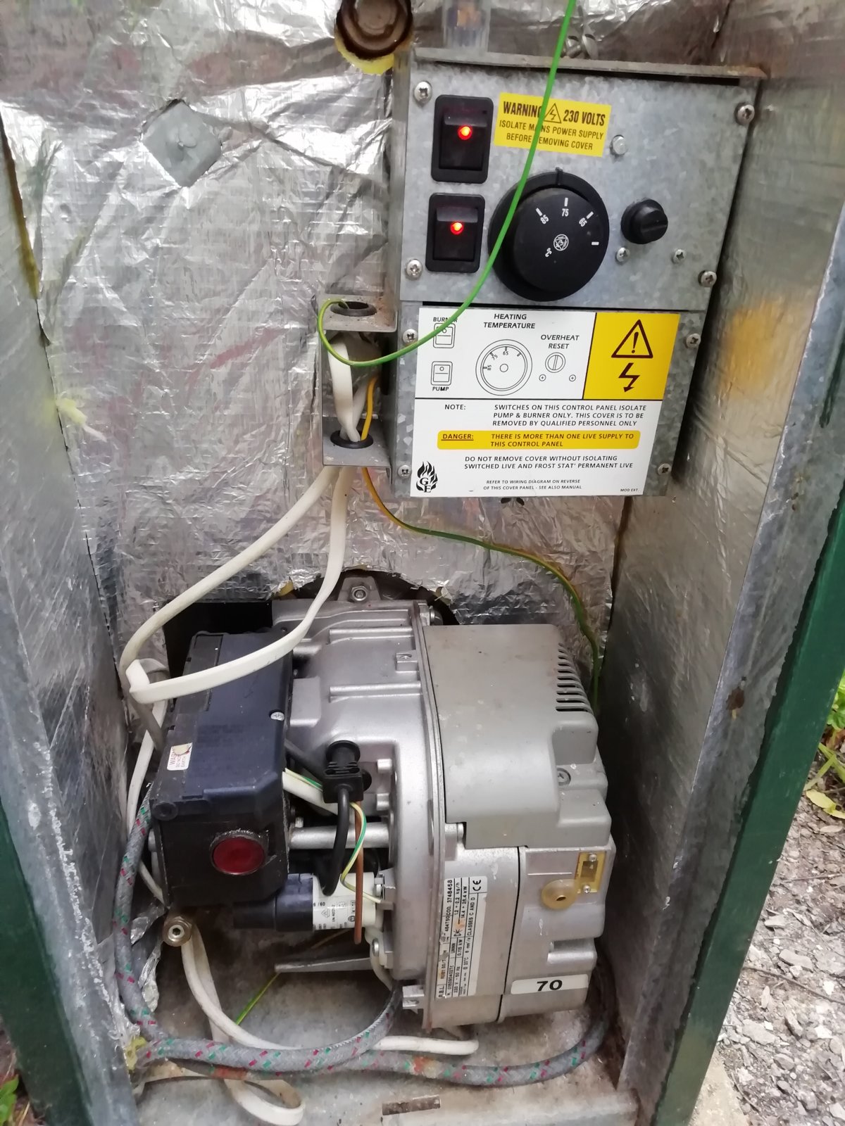

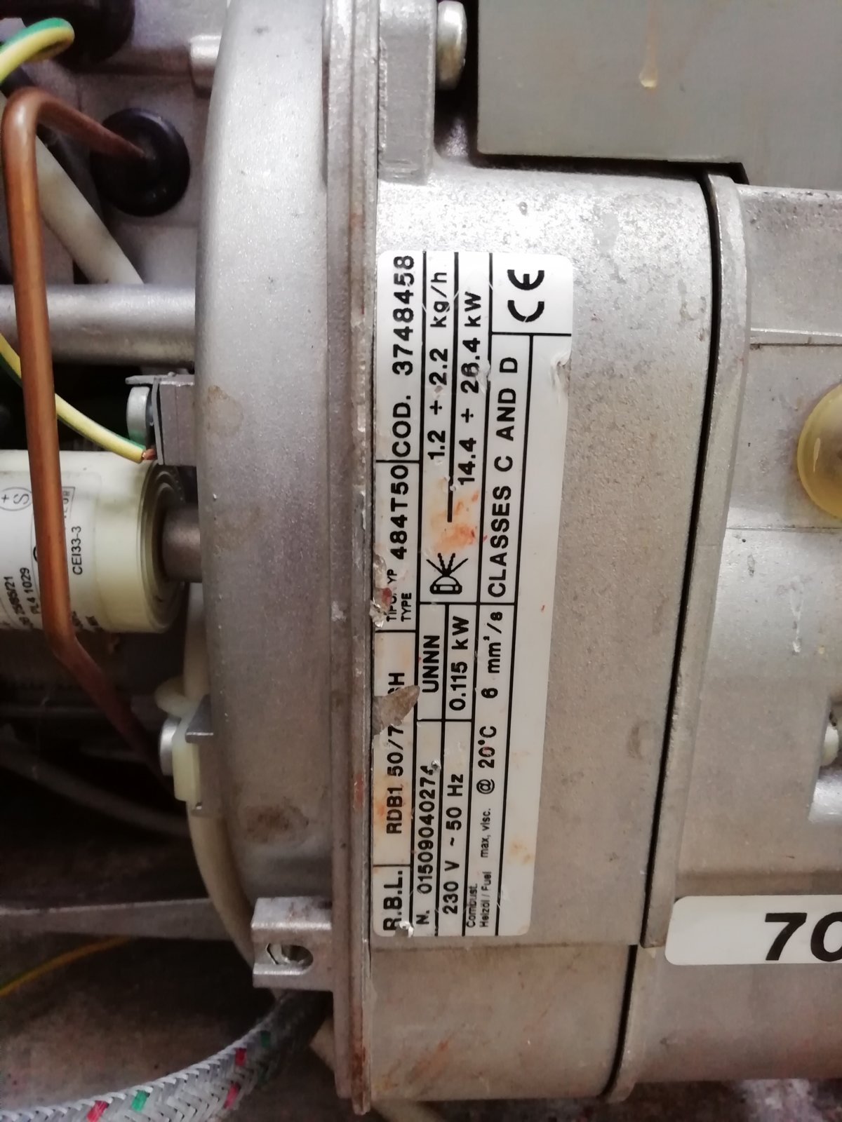

Hi, I have an external Grant Euroflame Oil boiler with Riello RDB burner. Recently it has started to lock out occasionally but then be okay for a while. Having not had it serviced for a number of years i decided to get it serviced. The combustion chamber was cleaner out, nozzle changed, pump pressure and emissions checked. Worked fine for a day or so and then locked out. Pressed reset button and took a few attempts but did fire up, but then within the hour it had locked out again. I reset again and same thing happened. Now it just won't even begin to fire up. I press the reset button and it buzzes for a while, then clicks and makes a louder buzzing and then resets again. Can anyone help? (We have plenty of oil) Advise very welcome as I'm so fed up with this boiler now. Thanks in advance!

Check out the capacitor and replace. The service bod should have tested this
on the service.

Now and again when I press the reset button it sounds like the air purge fan motor is stuck. Other times it just starts.
It might be the capacitor, if it is, you will get a buzzing sound for maybe 10/12 seconds and then stops/locks out.
If you can see the fan, ensure boiler switched off and get a small screwdriver or the like, insert it in the fan impeller (vanes) and try and turn the fan back and forth, you should feel a fairly light resistance as the fan motor also drives the fuel pump, whether easy or not to turn, get a tin of WD40 and squirt a little around the fan casing and see if this helps. If you can't access the fan, just give a few squirts (sparingly) of WD40 into the air intake slots the next time it fires up.
