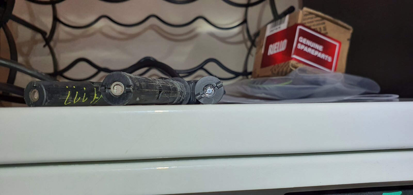

The first photo shows a new analogue photocell (on the right) .The "eye" is different from the old ones on the left.Would I expect to get similar Kohms/Mohm readings in light/dark as I would with the old
style analogue?

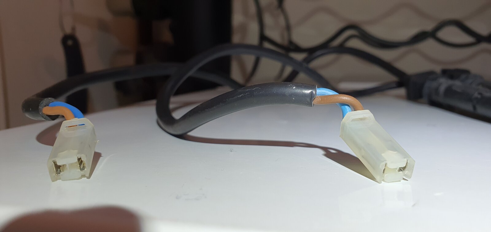

The second photo shows two old style photocells but the wiring is reversed on one set(i.e on the molex connector).Are these photocells "pole" specific or can they be connected into C/box either way.
Thank you again.
Riello photocells have changed. If you've bought a new one, then fit it. If it works , then OK. Stop overthinking such a simple problem.
