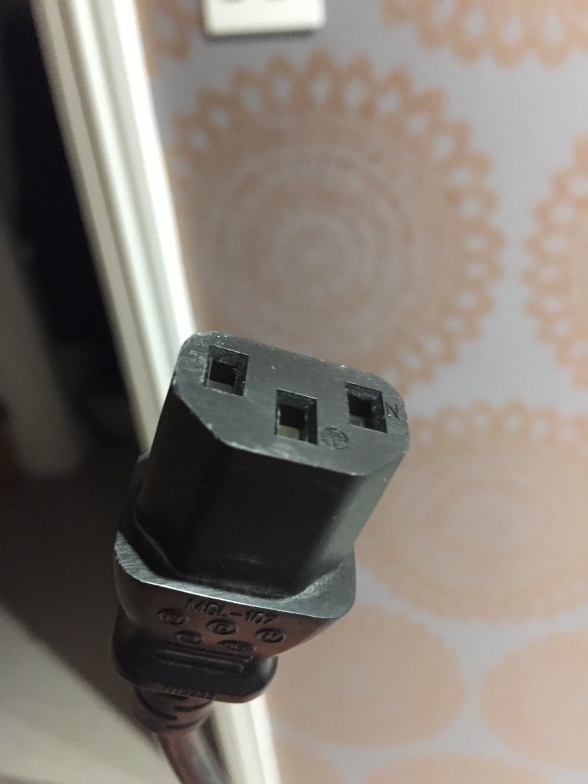

Thanks. I’ve got a 3pin end on the TV.

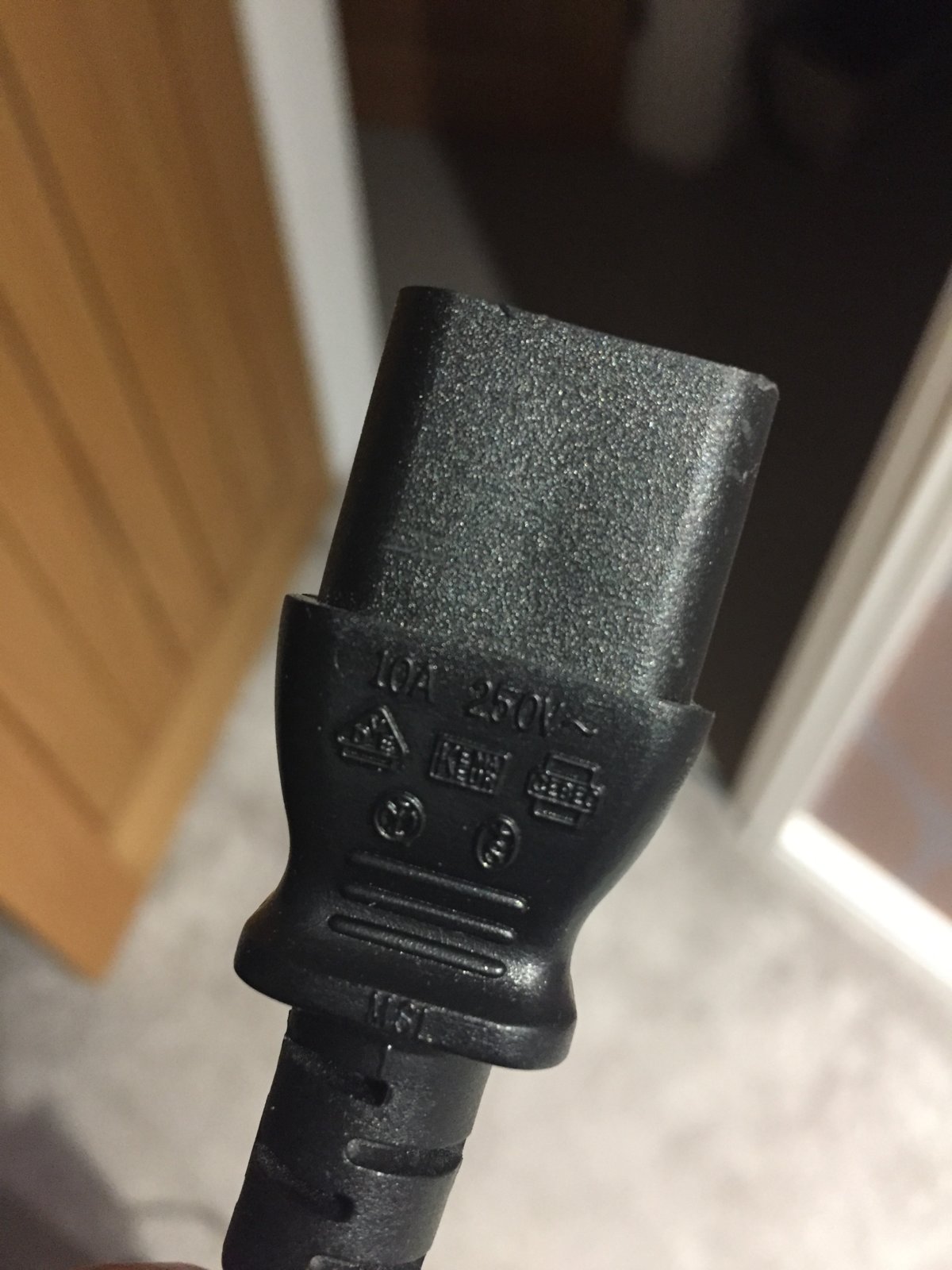

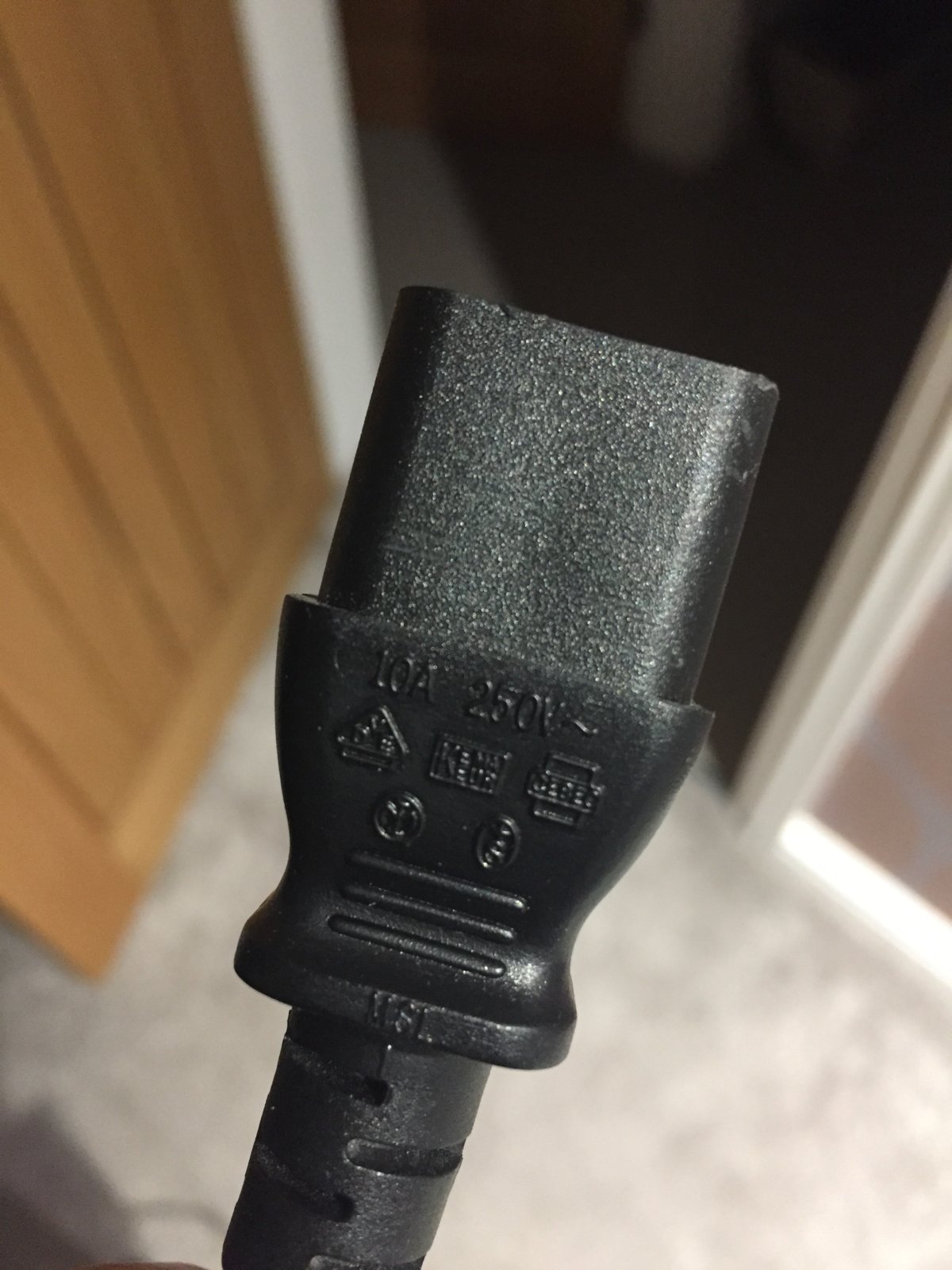

Sorry, no longer have a right-angle C13 cable! Must have given it to someone. However, I would suggest the right angled plug sticks out from the appliance by about 13-15mm and, excluding the cable entry, is about 15-19mm across. HTH
Hi All, can someone please provide a steer on the above? Thanks in advance
Thanks @OwainDIYer. I've placed my order for this.
do I need a 10 amp fuse in the plug for this connector?
As the connector is rated at a max of 10 amps that would do. Though outside the UK it would be used on a 16 amp circuit so probably not a problem with a 13 amp. The TV of course will have it's own internal fuse so don't worry about that.
