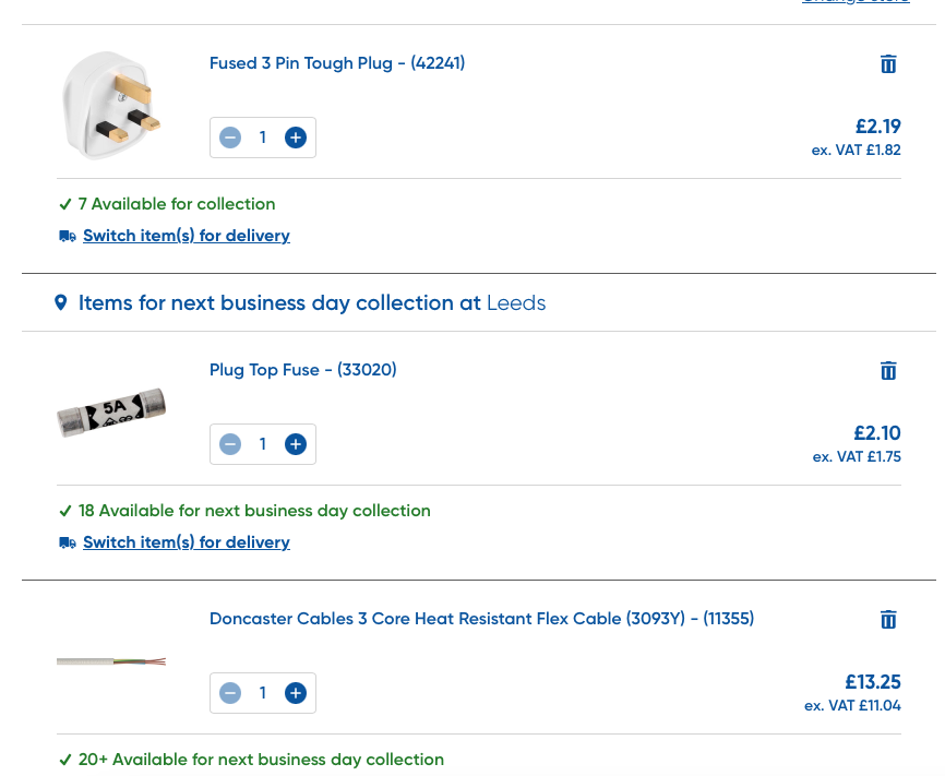

I have just bought a Ring Floodlight Cam and am hoping to install myself. I plan to fix to an external wall, drill a hole through to inside. On the inside is a plug socket (quite hidden in a cupboard so not easily accessed). Can I just purchase the following to wire it together, or should I be getting an electrician? Also what fuse should I use, is 5a ok?

0.75mm cable will deserve a 3amp fuse.
A larger cable is ok with a 5amp fuse.

Thanks for all the advice. And just to confirm I can run the cable straight to a plug (with 5a fuse) with no issues with the Ring Floodlight? I read lots about using a fused spur, but is this no different apart from it can't be easily unplugged/switched off?
This is what I think I'll need:
That cable is much larger than you need and will need a larger bend radius. As already suggested, 0.75mm is all that is needed.
Buy this:
Doncaster Cables 3 Core Heat Resistant Flex Cable (3093Y) 0.75mm2 Coil (94276)
THREE amp fuse:
Plug Top Fuse 3A (62399)
You don’t need an expensive tough plug. Save yourself some money:
Product code: 74540
Fused 3 Pin Plug Top 13A
