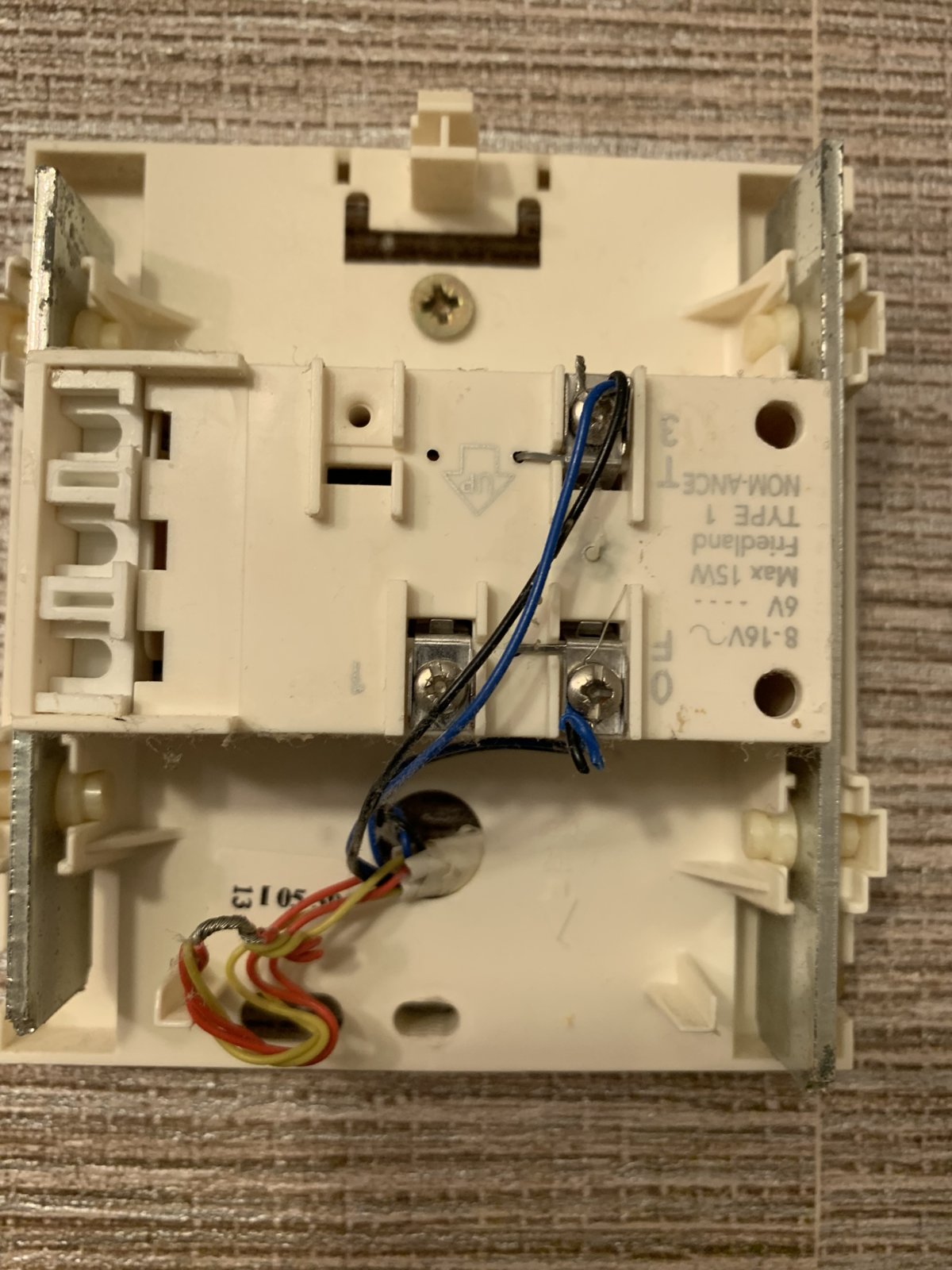

Hi all,
I'm after some help installing my Ring Pro Doorbell.

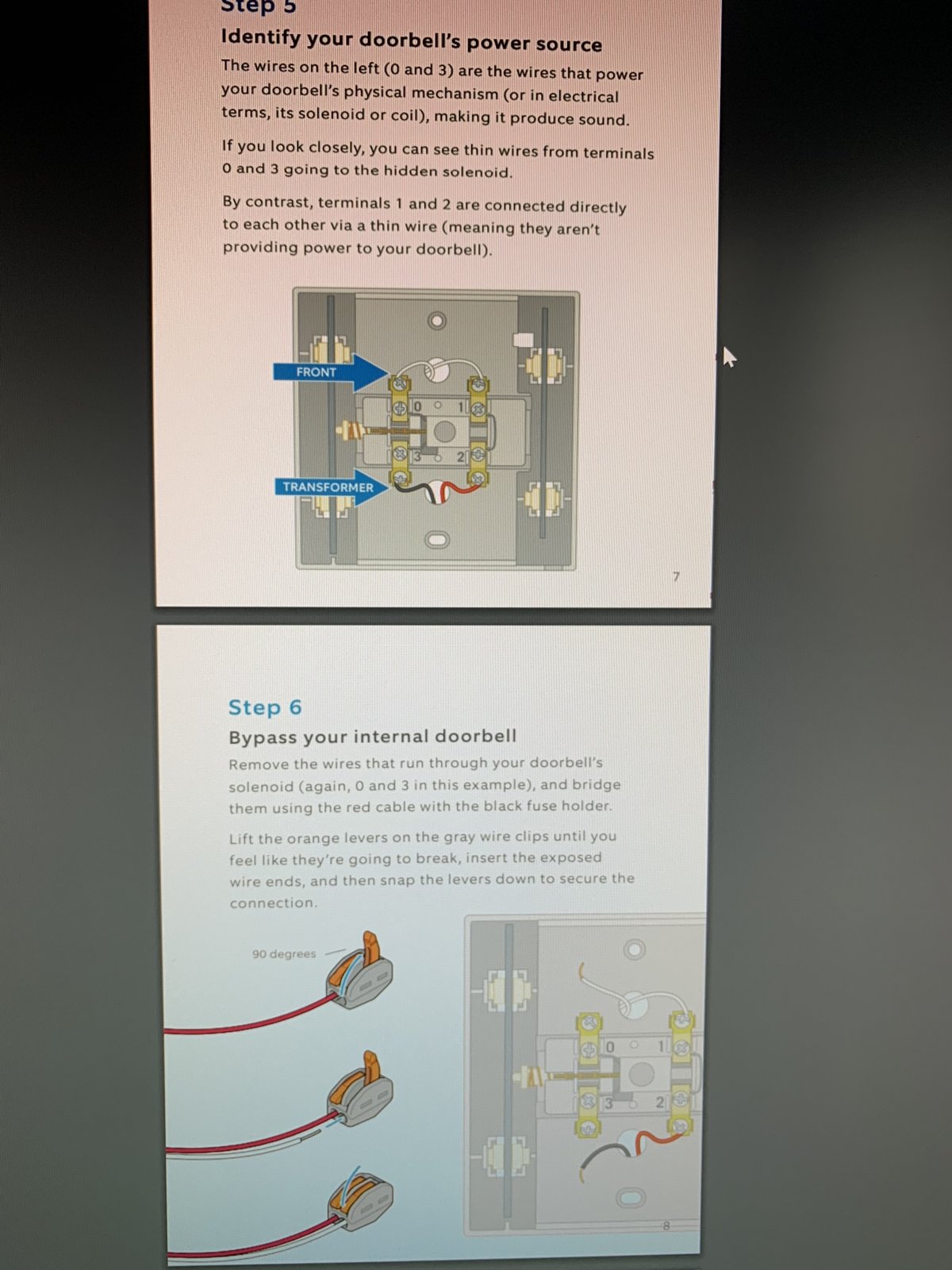

I'm at the section I need to bypass my doorbells transformer but I'm unsure of the wires to connect.
I have attached the photo of the wires 6 wires I have. The wires that lead to my doorbell are 1 yellow and 1 red to one terminal and 1 blue and 1 black to the other.
I'm thinking I just need to connect the Blue and Black wires from 0F and T3 using the bridging cable but just want to double check.
Many thanks in advance
