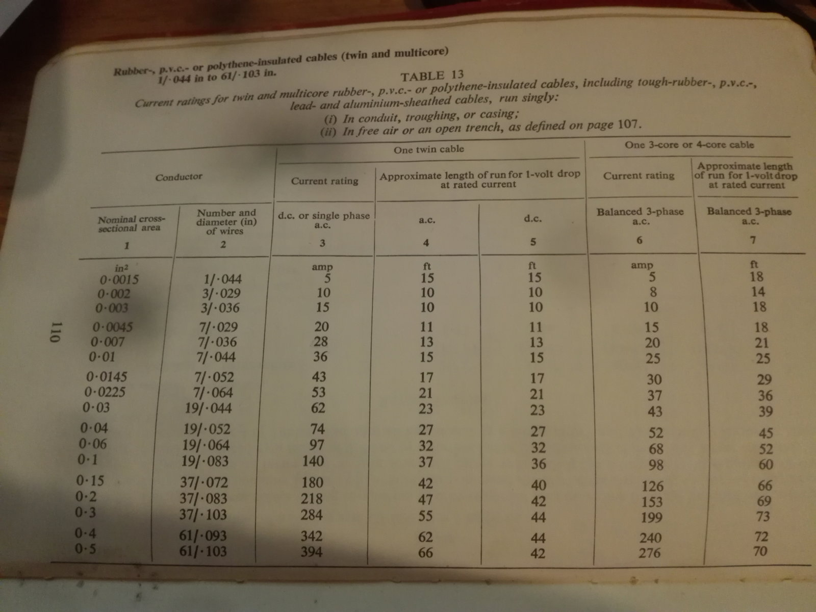

I've just noticed that the CCCs in that table relate to situations in which there is "coarse extra-current protection" and that one can multiply them by 1.33 to get figures for situations in which there is "close excess-current protection".
On that basis, with "close excess-current protection", the CCC for 'clipped direct' 7/0.029" would be 30.67A - similar to the 30A figure I 'deduced' from the table I linked to.
However, can anyone tell me what "coarse" and "close" excess-current protection were, or do I have to ask Mr Google?
Kind Regards, John

"Coarse" = 3036?
That was also the first thing which occurred to me. However, if "coarse" was a 3036, what would have been "close" in (it seems, from filename) 1966? Were MCBs around then?

This is from 13th Ed., 1st September 1955:

This is from 13th Ed., 1st September 1955: ...
I don't quite get that. It gives a CCC of 20A for 7/0.029", but says that it relates to
(i) In conduit, troughing or casing
(ii) In free air or an open trench
Only the one figure (20A) is given, but it surely does not apply to both those installation methods, does it?
Kind Regards, John
... These definitions appeared from the 14th Ed.
Thanks - so BAS's and my 'first thoughts' were correct. As I said, I was doubtful that MCBs were around back then, but clearly they were!
So, these figures of 20A - 23A we're seeing for 7/0.029" correspond to 26.6A - 30.67A with MCBs - similar to (maybe fractionally higher than) 2.5mm².
