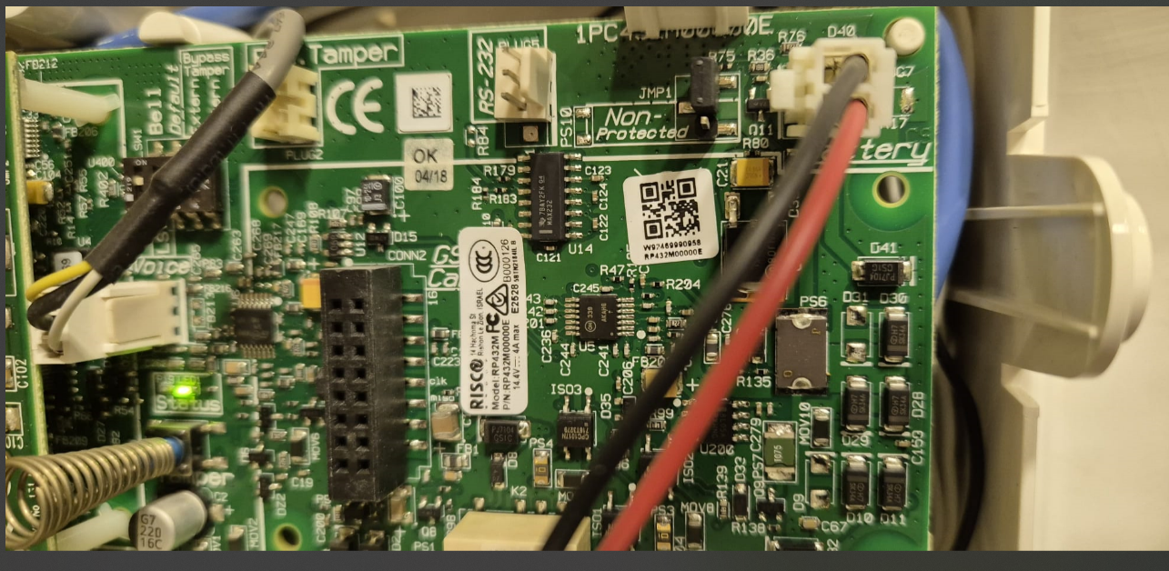

Hello,
I have a risco Lightsys alarm. recently we have removed our phone line. Alarm now comes up with a fault as in the heading - Media Loss - Com. Module PSTN
I know the installer code and have been going through the options however i cannot see one for the PSTN module. The Alarm was configured to call if it was to go off.
I would be happy to arm the alarm with the fault if thats an option.

To go forward take pictures of the pcb and any add a ons. Depending on the version you have things maybe slightly different.

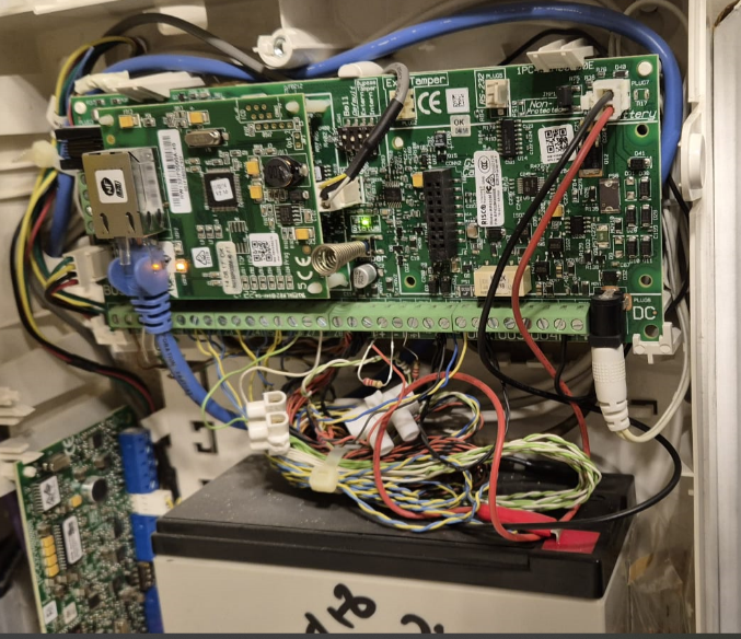

Thanks @secureiam. I am far from an alarm engineer. Will the alarm go off if i take of the panel cover? If so Is there somewhere where i would disable this?

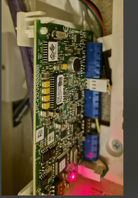

Hoping these pictures help.
If there is an option to arm despite the PSTN fault i am also ok with this.

Down power unplug the pstn power back up.
The fact it’s not on the list though in the menus suggests it’s not available anyway
Thank you. Powered down the unit. Unplugged the battery backup. Alarm went off! Unplugged pstn module after googling what it looks like. Powered back up. Turned off the alarm. I am now able to arm my alarm system. Thank you. I'm sure it does need some professional tweaks at so e point however for now I am good.
