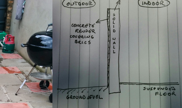

Hi, thanks.. this is the best pic I have of outside wall at the moment.
it's a solid wall and floor is suspended. The floor level is just above the ground level.
I tried to remove the concrete render but it's almost impossible as it's rock solid and I would just destroy all the bricks under.
So I'm trying to find out where to put DPC layer knowing that the outside render (or plinth) has to go all the way to the ground level and how to isolate render/plinth so it doesn't bridge DPC layer.
Your outside GL has been raised by the flags. Damp, degraded render can be seen at the wall base. I dont see a plinth? More pics please.

By Solid wall I mean this, the outside render is less that 1inch thick.
There are a few questions still outstanding?
The wall is solid as in the lower pic?

Yes it's solid as on the lower pic.
