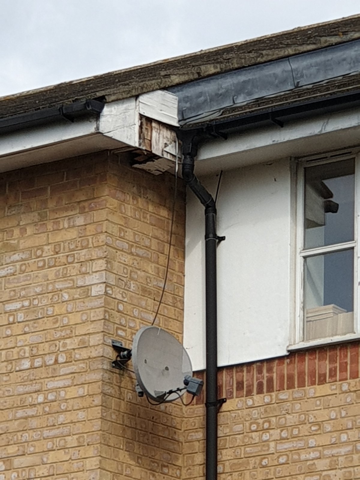

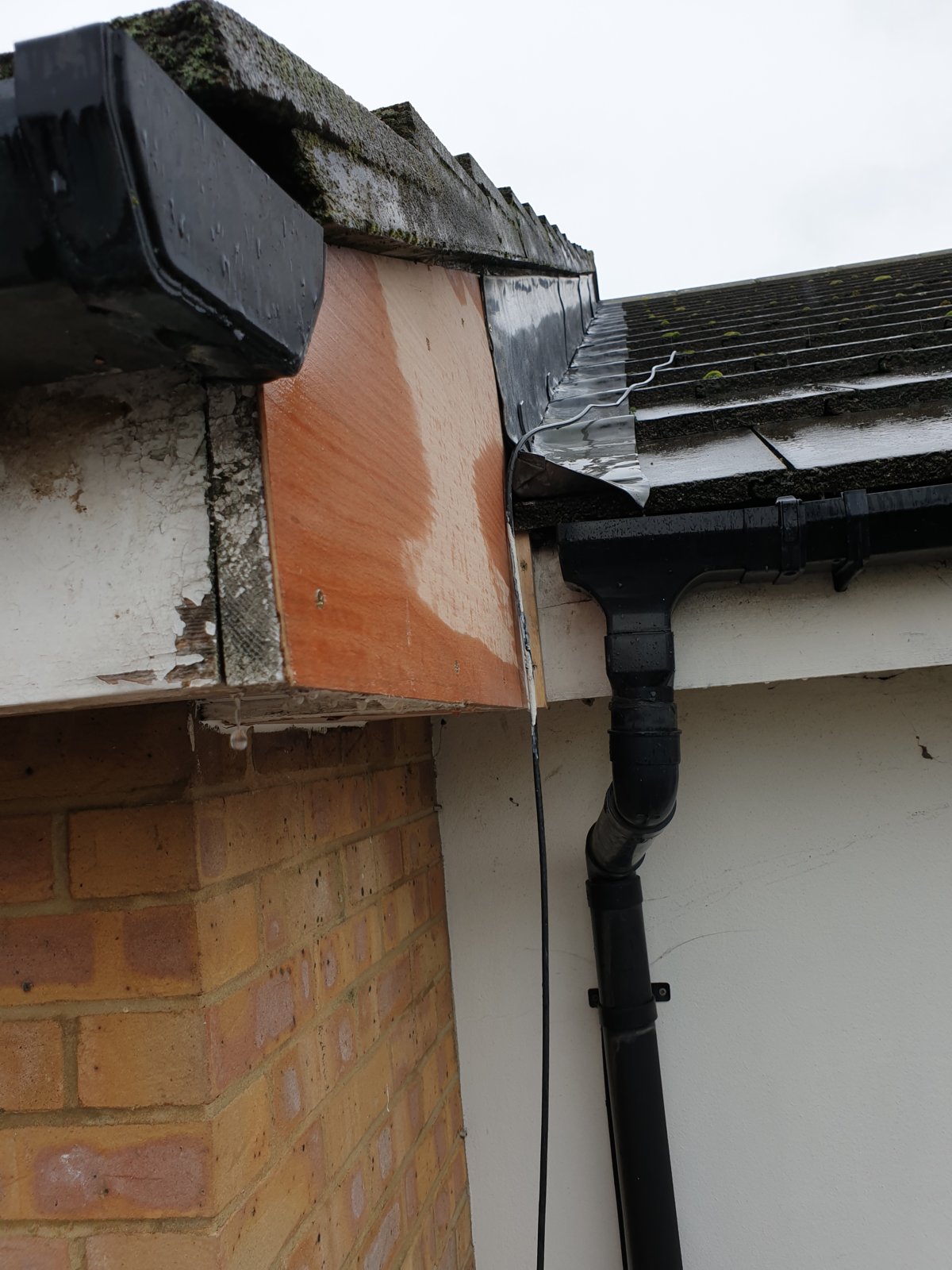

Roofer has done a repair. Looks a bit flimsy to me. What do you think ?
He has arranged for decorators to come and paint it, but they are held up by the rain.
So in the meantime, I am wondering if there is anything that could be undertaken to improve what he has done OR is there a protective substance that I could apply before the decorators come and paint it over.
Help needed
Please see "before" and after "pictures". Thanks, Zena

The original "problem" appears to have been water damage, due to water coming down the roof and wetting the timbers in the area concerned.
The roofer has attempted to fix this by adding a flashing "dam" at the end of the existing flashing, to direct the water flow into the guttering.
However, it appears that he has not attempted to repair the rotted timbers but has merely added a cover-up in the form of some ply-wood!
It could be argued that the problem has been corrected and that all that is now needed is a "cosmetic" repair of the affected timbers.
(To do this properly it may be necessary to replace the timbers - which could be a costly exercise.)
If the water intrusion has been corrected, it may be sufficient to
clean away all the rotted parts of any timbers
apply an appropriate anti-fungal treatment
apply an epoxy resin coating to the timbers - to prevent further water penetration
apply a suitable epoxy or polyester "filler" to the timbers to build them up to the proportions of the original timbers - before they were rotted
sand down and
paint.
This could all be done by a knowledgeable "handy-man", with access to the appropriate products and tools.
However, all these steps may take several days (due to drying times) and the location adds to the problem.

the "dam" can be googled as a "kickout diverter" - clear diagrams are available showing how its installed and how it works. after installation it should have been water tested before carrying out further repairs.
i dont think that's ply - i think its three or so fir boards that have been edged up together & covered with a laminate sheet.
The whole thing will have to come off and be repaired and waterproofed by a joiner experienced in remedial work.
OP, your first photo shows water damage to the verge rafter and soffit at that corner -
and possible damage in the soffit area behind the gutter and down pipe.
someone should go into the roof space or spaces and investigate.
the left hand fascia paintwork needs sanding down and re-doing.
any new materials should be pre-painted before final fixing.
OP, none of the above is a big deal its run of the mill repair work.
fwiw: the work or damage provides no open access to your property for burglars.
To be honest t looks like its been bodged before
The modifications made to the flashings are useful,
The gutter could be adapted better with a running outlet and a stop end rather than the stop end outlet fitted.
The piece of thin ply is a waste of time.
I would get a chippy up there to cut out the rot, a good one would at least preserve/prime any new timber ready for decs

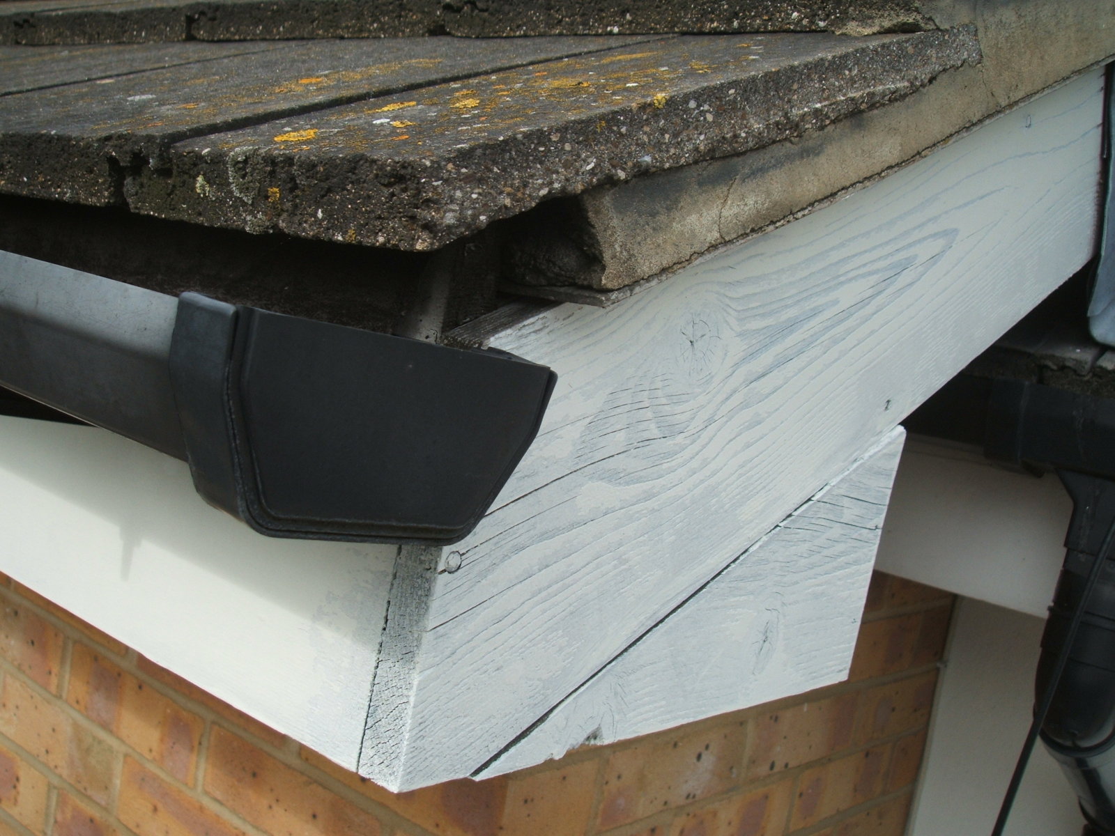

Datarebal: you might be spot on about a previous "botched job" - which I feel I should have noticed. I've just found a 2016 photo: shows a single, long, diagonal piece of timber. Whereas the photo showing current rotten wood shows a small horizontal piece has been added ! I clearly need to be more vigilant about any work done (& who does it) ! I attach 2016 + previously posted Oct 2019 photo to compare, so you don't need to refer back to original pix posted. Am asking friends for recommended joiner. best wishes & tx, Zena

Fascia boards and the like are often covered with PVC panels, which are weatherproof, provided water can't get under or behind them. better than ply if exposed to rain. If I was putting a wooden piece up, I would rotproof and paint it before fitting (much easier on a trestle in the garden than when perched on a ladder)
Comparing the 2016 photo with the more recent one appears to show that a section of the original timber supporting the edge of the roof has been removed and replaced with plywood (or, at least, overlaid with plywood) which has since rotted.
(I did not realise this from the initial photos posted, so significantly more than the "cosmetic" treatments which I suggested may be required.)
Because of this "repair", it may be that this edge section of the roof is now unsupported and is in need of attention.
Its probably me, but i dont understand how the old pic and the recent pics and the present day pics fit together?
so, why not hold fire for the moment on getting in a joiner, and instead why not contact a Pvc fascia and soffit installer to have a look?
but first google pics of "Pvc fascia box end" to understand how much better things could be, & look, with custom Pvc parts.
the plastic laminate you see pinned on to some boards has no relation to custom Pvc parts.
your neighbour is, probably unknowingly, responsible for all and any damage to your property.
the only ply i can see is damaged ply in the box end pic?
