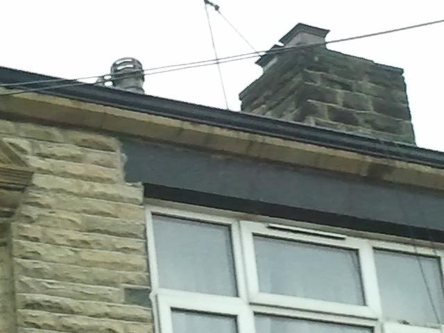

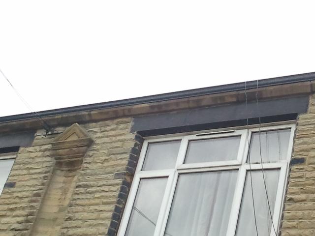

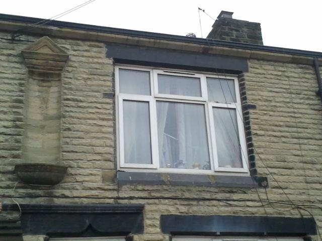

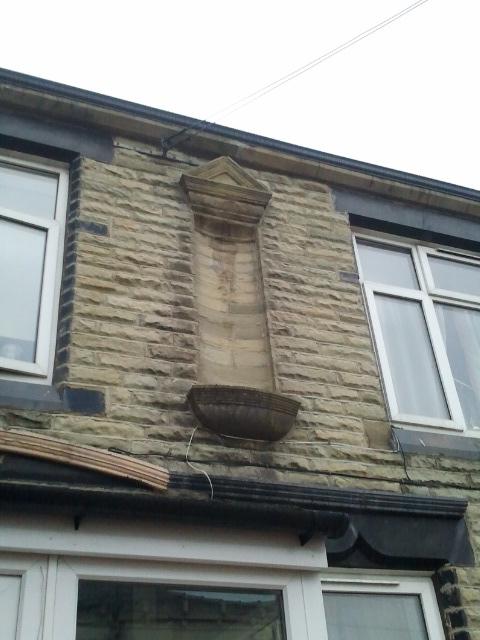

Hi, can anyone please tell me why I am getting water onto the stone work under the guttering? Is this a roof problem or guttering. Any help appreciated.
The gutters may be blocked causing the rainwater to spill behind the gutters and then onto and over the plinth.
check the tiles overhang the gutters enough so that water doesnt back over, also it may be worth fitting eaves trays just to direct water right into the gutters.
Hi, eaves tray have been fitted. So it looks like its the seamless guttering.
