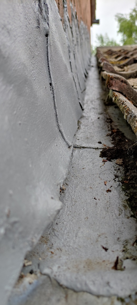

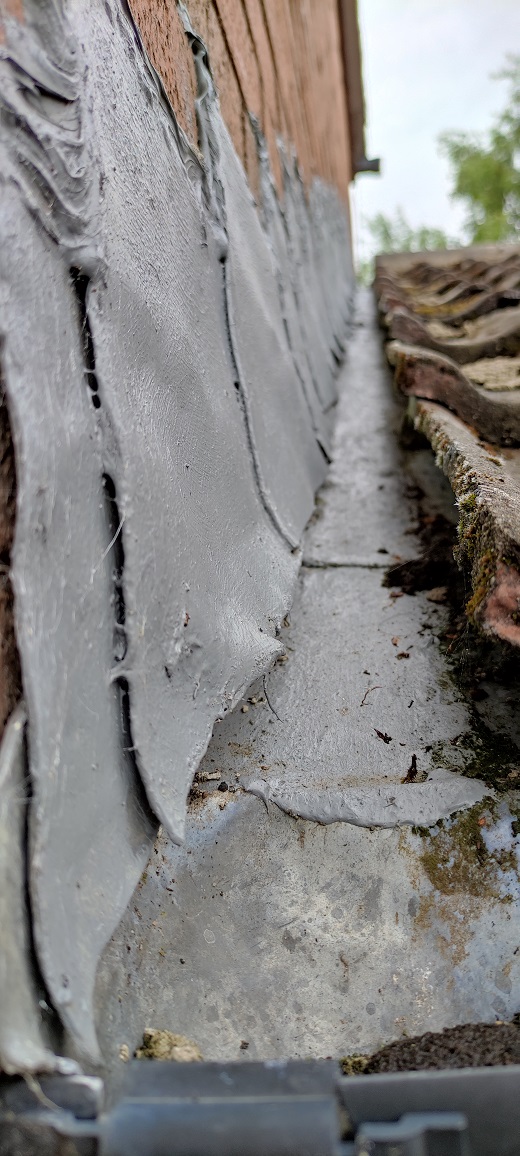

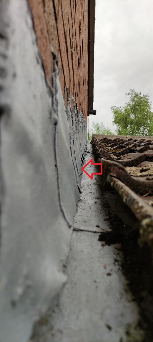

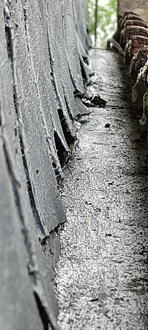

Your problem suggests there is no cavity trays installed.
Was the garage built at the same time as the house?
The people going onto your roof and brushing acrypol all over the place dont know what they are doing...they won't know what a cavity tray is either.
