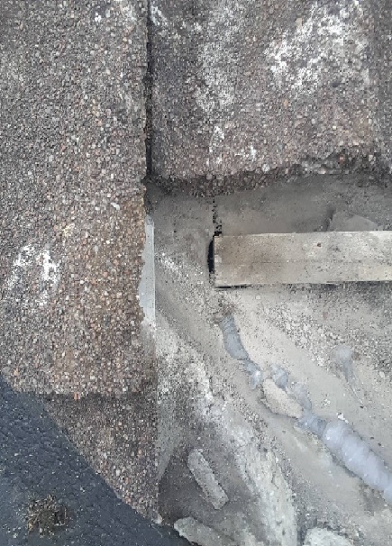

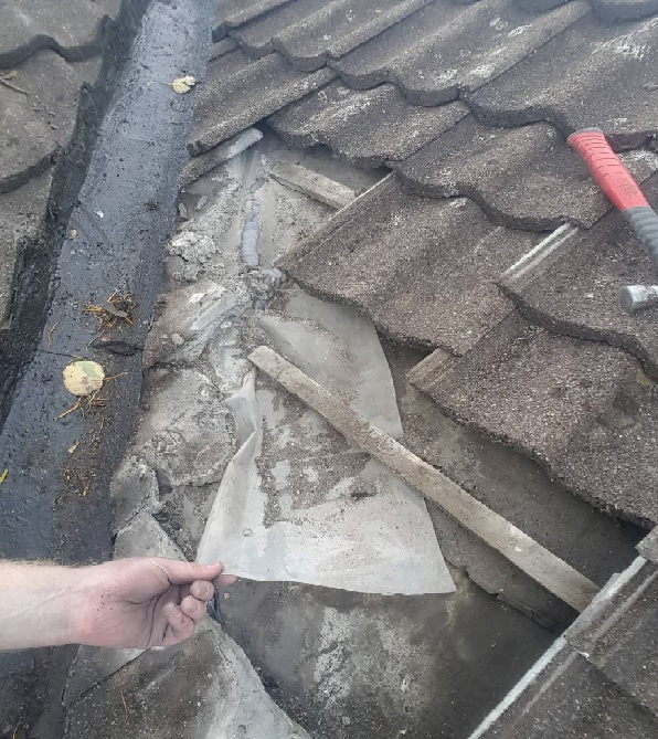

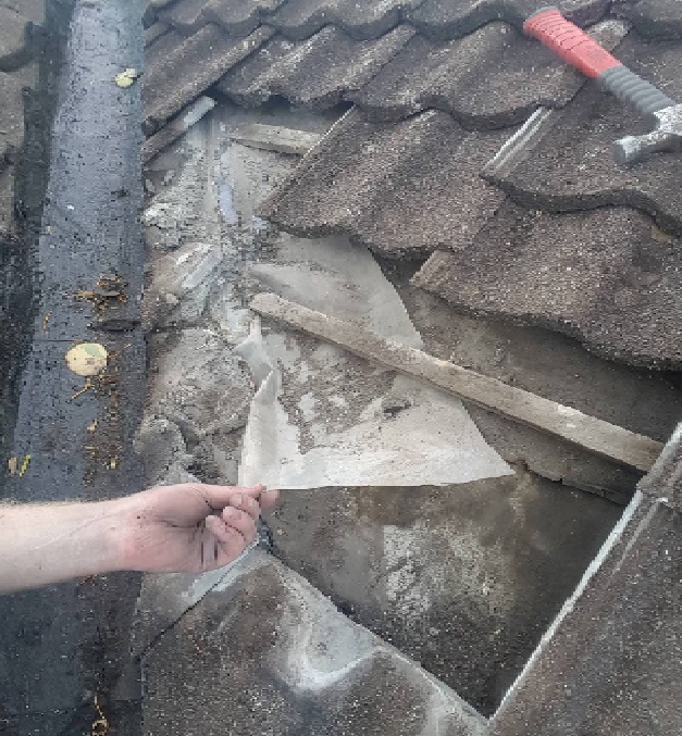

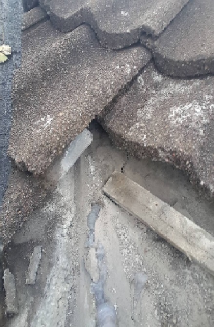

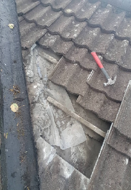

I have recently bought a house (2 months) and noticed a leak in roof when I was decorating dining room.
A paint tray was in roof space when I pulled down plasterboard ceiling???
I have had a roofer look at this and he has stated both valleys need replaced please see pics haven't got a quote yet but he reckons around £1,500 for total job!!!:cry::cry::cry:
Other thing is the seller did not disclose this as he put paint tray to catch leak, could I chase him for cost of work via solicitor??
Any advice would be appreciated.

Catlad roof is good all checked.
Only Valleys need replaced.
Checked by the guy there couldn't tell the valleys were shot? The black jack is a give away..
Ridge bed doesn't look great in the small shot I can see...

****Update****
£4k later both valley's replaced, new lead, new breathable membrane and laths as well as approx. 150+ tiles replaced - problem solved!!!!
