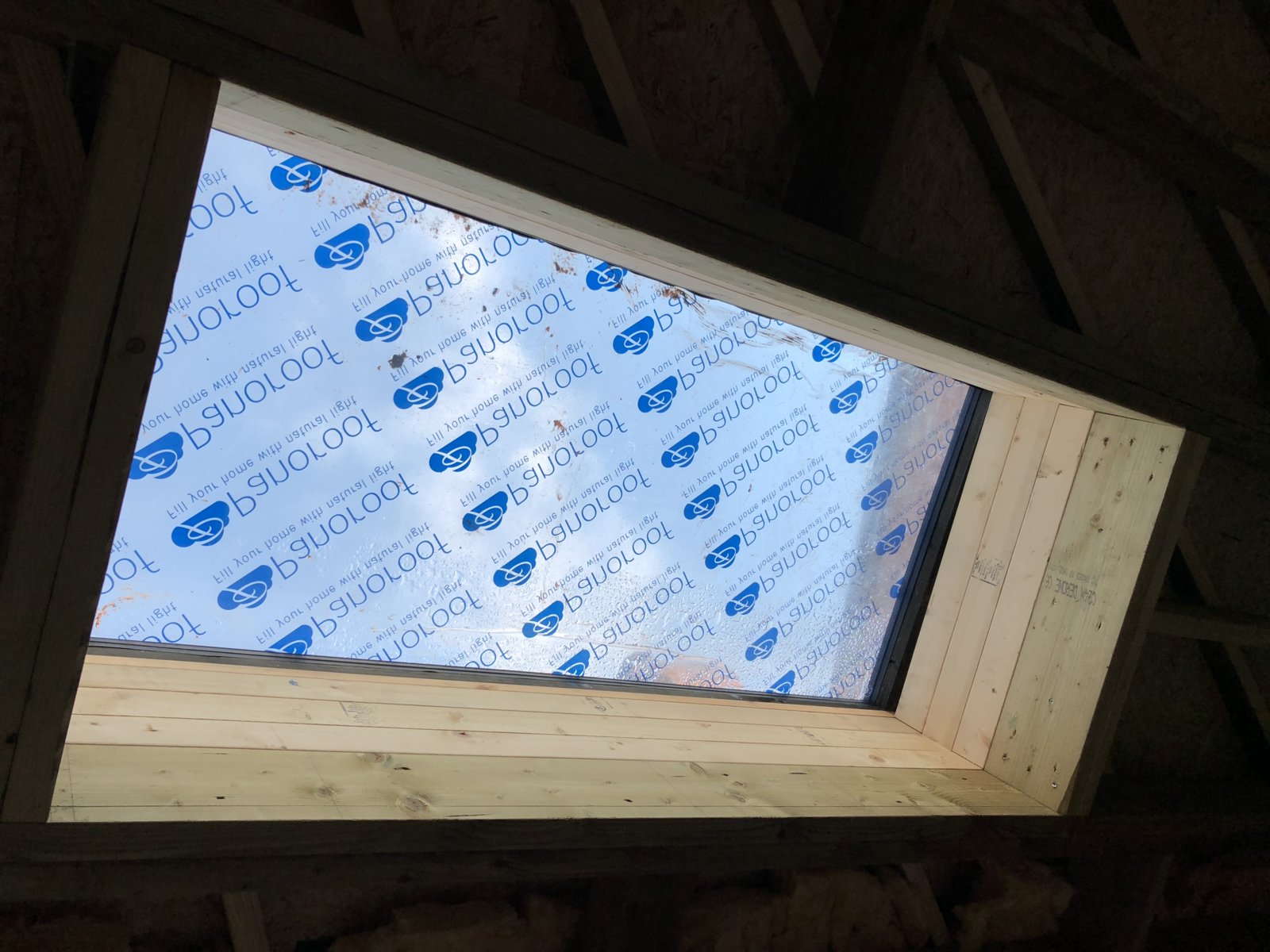

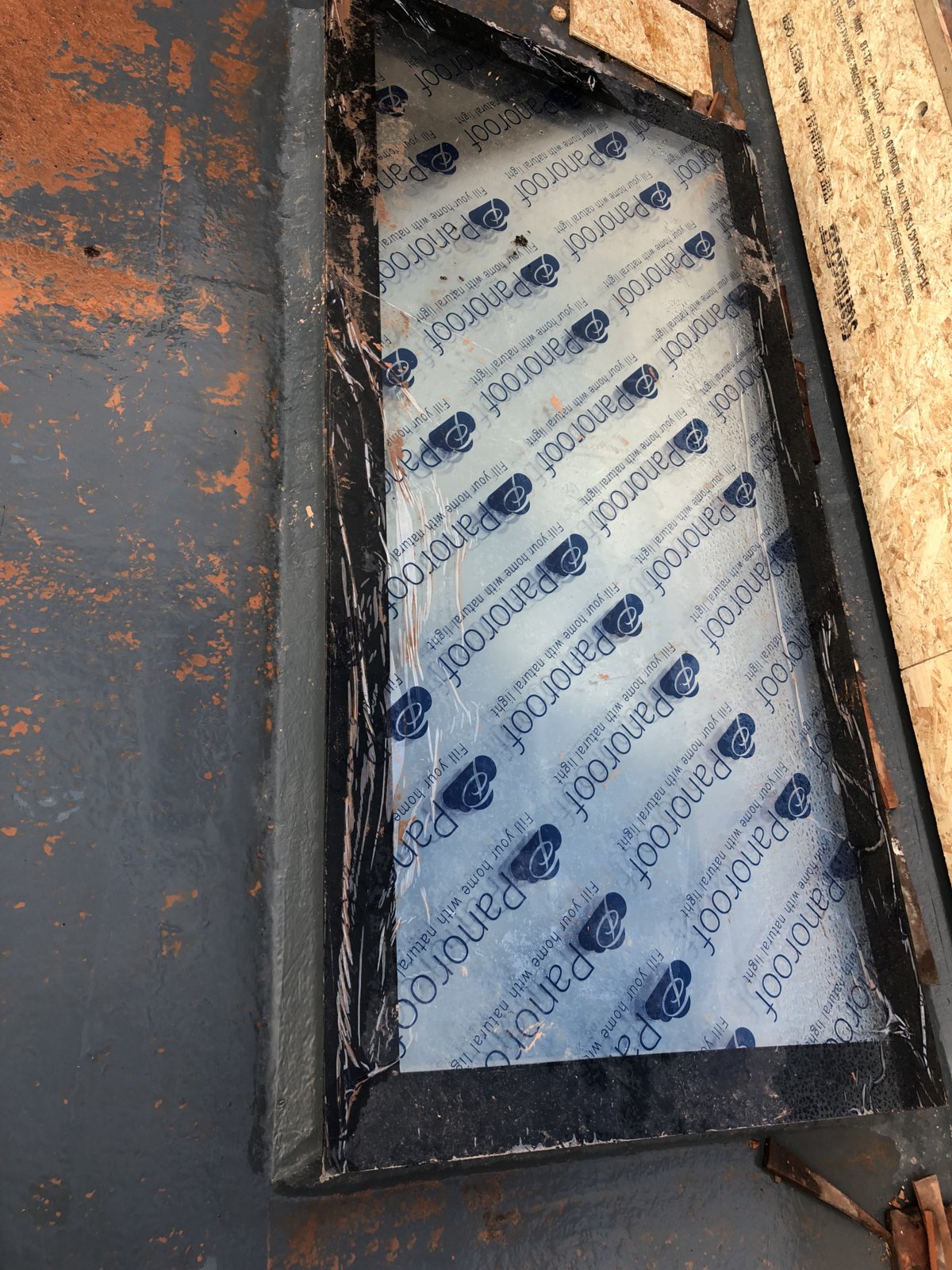

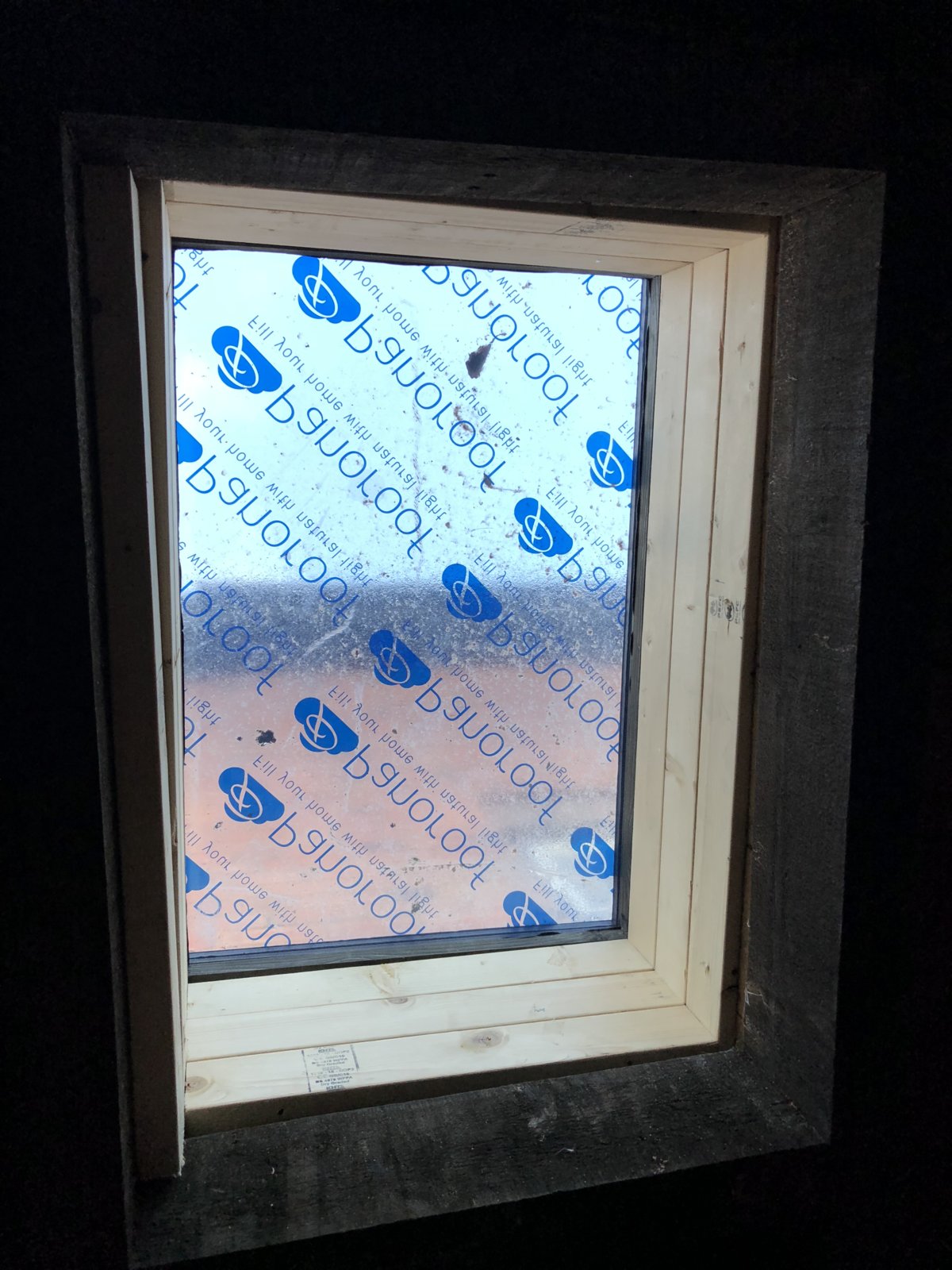

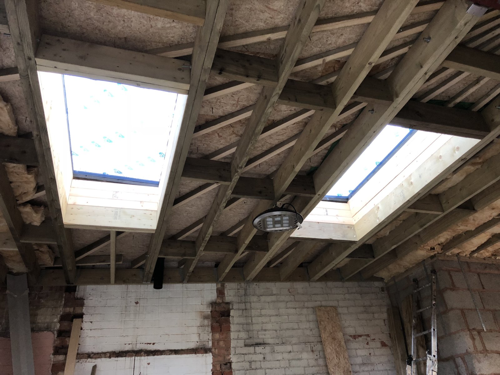

Thank you everyone, pilsbury, any chance of some photos?
Not finished article but you get the jist. Easy as pie to fit although heavy.

Any chance of some photos of the drip detail Pilsbury? What stops the water rolling around the top and edges and causing problems?
I could take pics tomorrow. But grp goes up to top of wooden kerb then the roof light is simply dropped in place with lashings of low modulus silicone. Then the edges where the glass meets the top of the kerb are also gunked up with that same silicone creating a seal.
