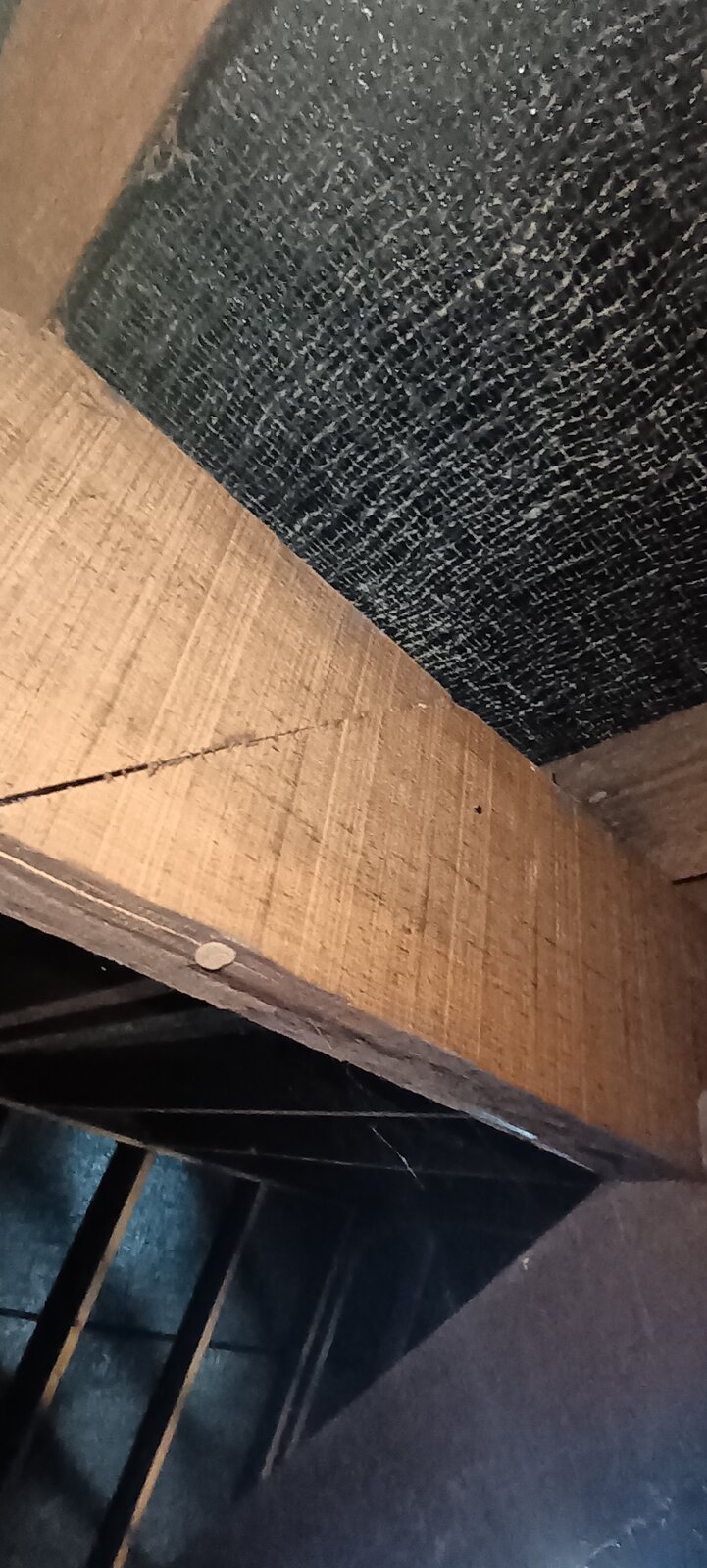

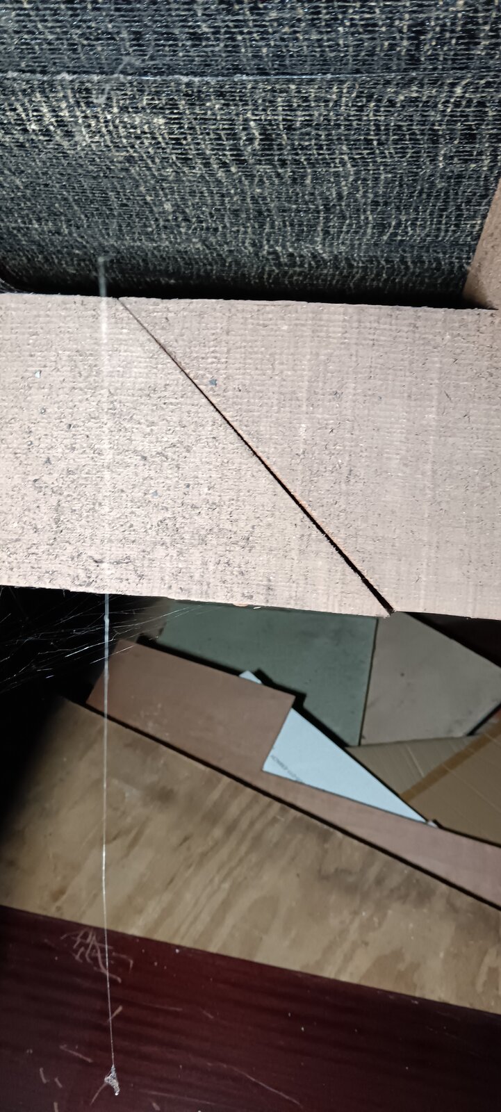

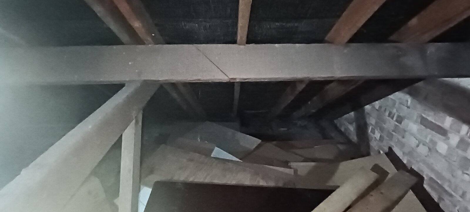

I have just noticed one of my roof perlins seem to be in 2 sections. does anyone know if this is a concern ? The line looks too clean to be a break and a nail has been put through it to hold it together. Can i leave this or will it need additional support ?

That's strange - the vertical saw marks, across each section of the beam, line up perfectly - as if it was one single beam, cut across at 45 degrees. I would guess it was cut, to enable it to be manoeuvred into place.
They are not uncommon. The left hand purlin is overhanging its support and in turn supporting the shorter right hand purlin. If it’s not causing problems after many years in situ I would be tempted to leave it, and keep under review. You could sandwich both sides with ply and screw through
Its just a type of scarf joint, probably used because they didn't have a piece of timber long enough.
Looks like the same length of timber as Harry said. Maybe they couldn't get it up there
I'd be surprised if the only reason they cut it was because they weren't man enough to lift it in place.
It's not a scarf joint, and it's not even a joint! It's just two timbers butted together with no structural strength
Correct. A scarf joint requires some sort of overlap of the two parts, allowing them to be pinned to provide similar strength to a continuous length. That timber has simply been sawn through, with no attempt to join them, as is obvious from the witness marks, from the sawmill, being a perfect match. That right hand section, just rests on the left, and the left is supported by the vertical prop, which hopefully, rests on a structural wall.
