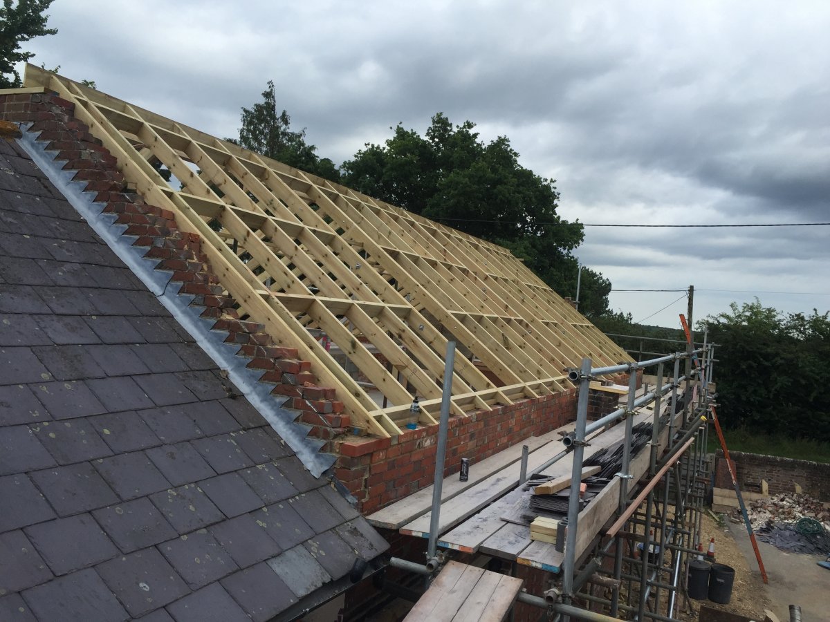

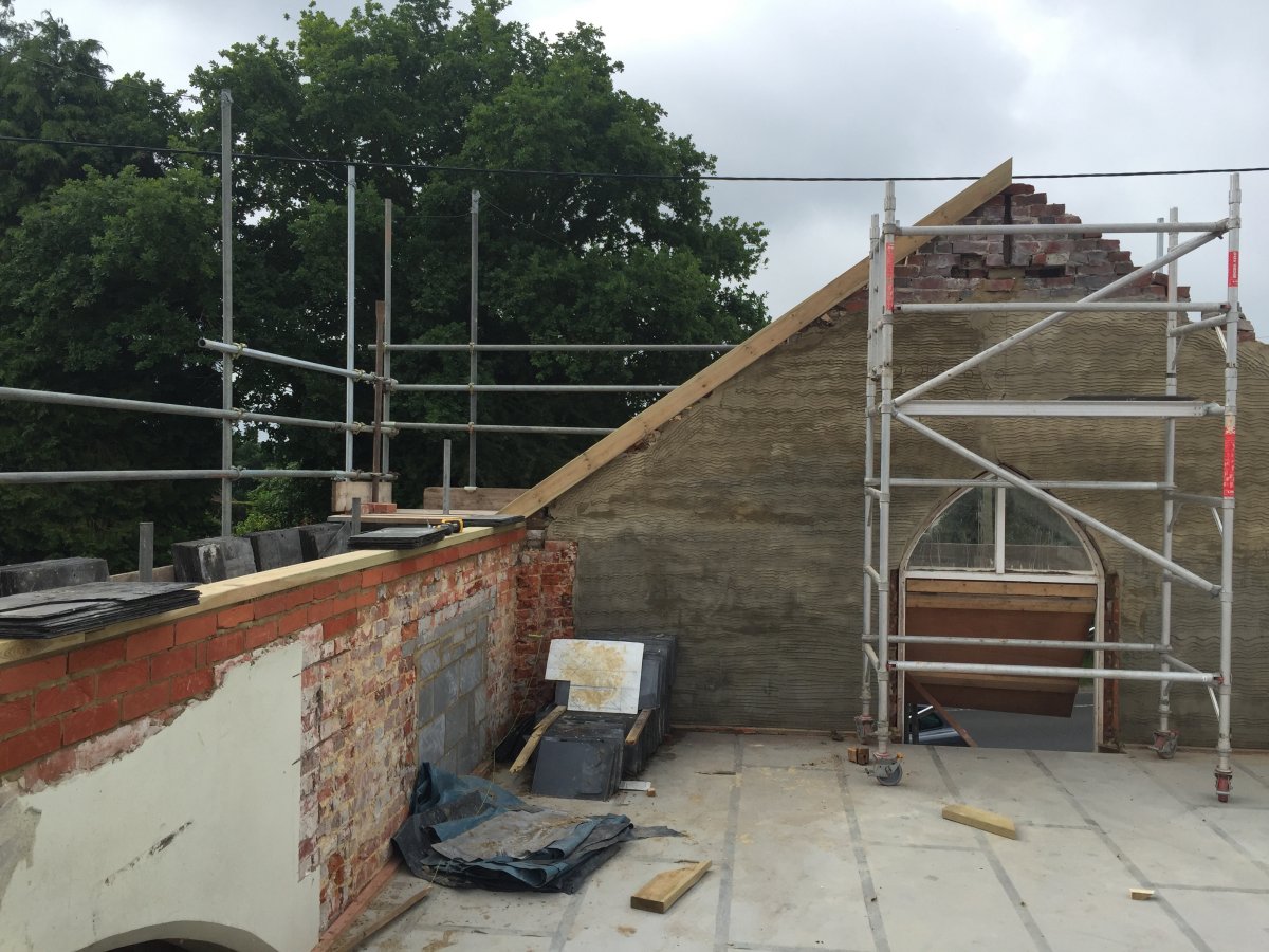

Hi,
I've got a building being refurbished. We have a 40 ft roof that we need to cut and put on. At the mid point (ish) of the rafter we will be putting steel perlins in to support the load.
At the two gable ends we have already placed the padstones (a little lower than we think we need) and have cut our template rafters.
Now, we can cut the whole roof and birds mouth where the steels (with timber plate ontop) will sit and hold the roof up. Then slide the steels underneath and cut the vertical posts holding these steels and then weld in place.
Or should we put the steels in and then put the rafters ontop ?
Our problem is that we have no accurate way of ensuring these steels follow the natural flow of the roof line (building) as it does dip down, by about 1" over the 40 ft. So, by doing steels second, we can crank the steels up to the underside of the rafters and then shuffle the top plate that the bottom of the rafters sit on in an out a little, as the wall does wobble a little.
Your comments would be appreciated.

We set our padders so that they were about 20mm low so that we could acrow the steels into the rafter b/m. Bear in mid though, that once you start lifting the beam off its seat then it will begin to wander. Make sure you have measures in place to mitigate this.

the semi-dropped chimney stack in photo 1. needs work before the finished roofing is fixed.
Given all the work going into this renovation perhaps re-build a traditional stack?
Whatever, the air brick and the flag have to go.

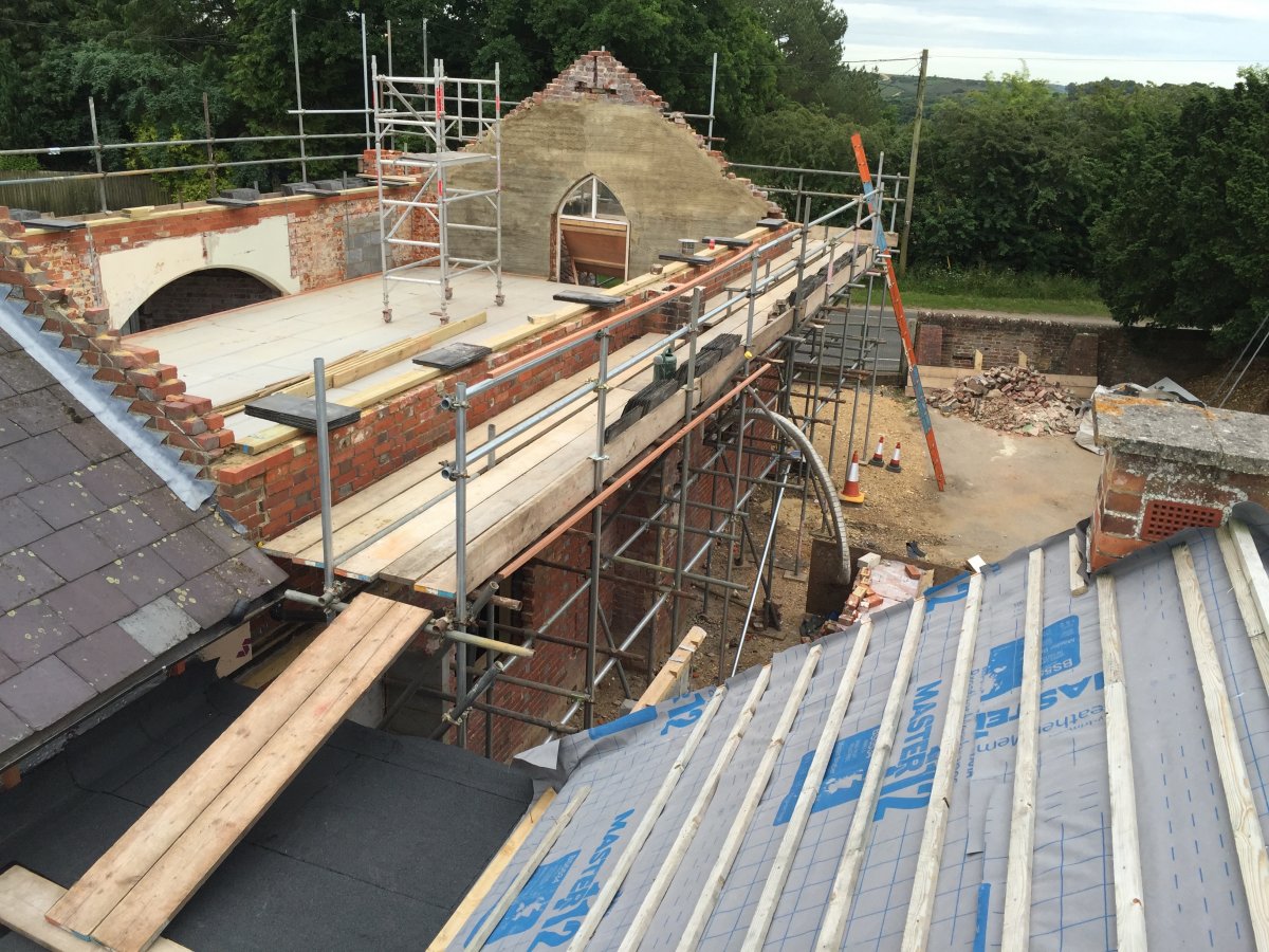

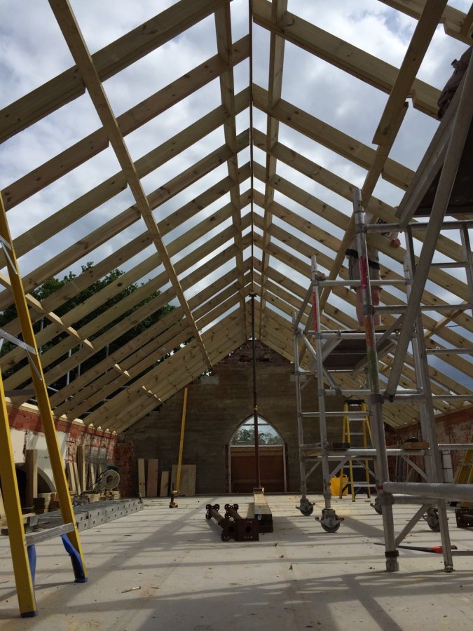

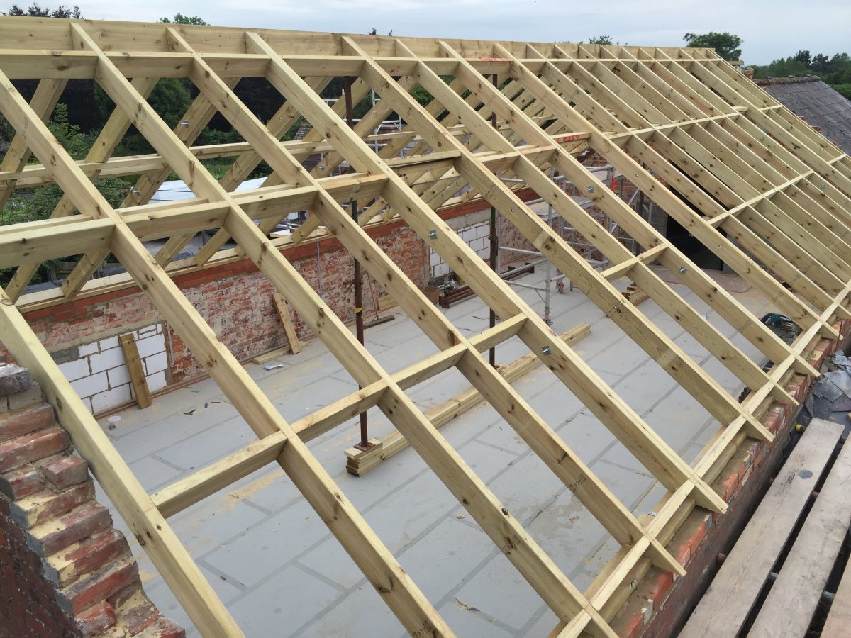

Roof cut. Steel onsite, we will cut and fit on Monday.

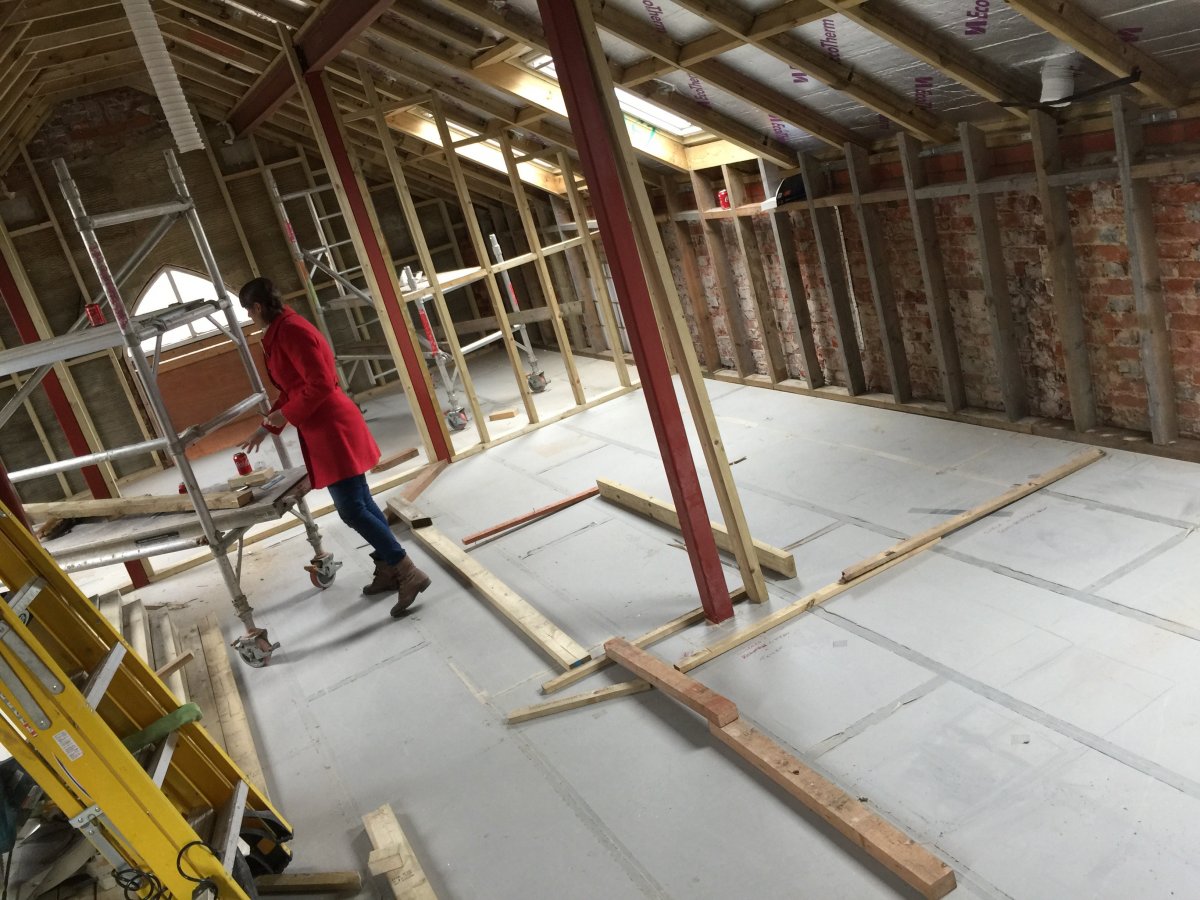

Steels in, Starting to stud out. In the end not so worrying. But thanks for everyone's advise.
