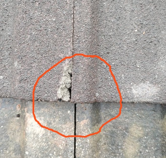

Just had a bit of roof work done near the ridge. The replacement concrete tiles about 2 of them have slightly chipped corners at the bottom. The scaffolding is still in place and the tiles can't be seen from the ground at the moment. My other half went on the scaffolding to have a close look and saw it.
It probably won't affect watertightness but it's really annoying me that a roofer would do this.
What is accepted practice ?

What do you mean chipped? Roof tiles will valiantly continue to do their job, even is they are not shiny and painted.
Are the tiles missing bits of material? Or is this cosmetic 'chipping'?

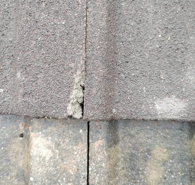

Photo of the worst one
I am no roofer but that wouldn’t worry me.
If I was fitting that and spotted it, I’d maybe put it aside but there may be loads done by the time it was spotted?
Changing one can be tricky
Poor quality tiles. On a big job they'd be used as cuts or even throw outs. I'm guessing he didn't have a lot to chose from or was delivered or picked some duffers from the yard?
Yes not many new tiles needed
I would be more concerned about the lack of bond.
He means the join of the two new tiles is very very near the join of the two older tiles below and that would allow water to leak into the roof space below.

Sorry didn't look at pic properly..I thought they were modern tiles...no half bond needed on the wessex tiles in pic.
