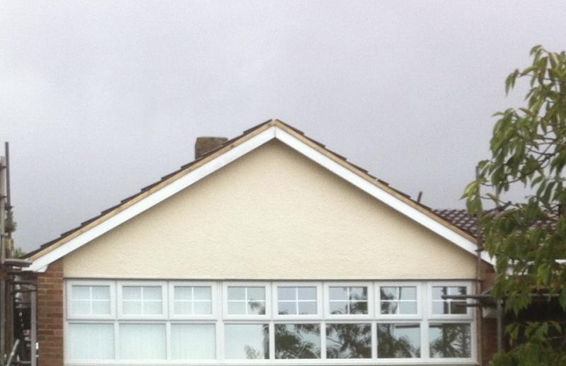

I have just had my house retiled...
My problem being, the roof was retiled and new dry verge plastics put on..
BUT my upvc fascia is different depth either side..
When I asked the roofers they said its just the way the tiles end..
Basically one side of roof ends on flat of tile the adjacent side ends on the curve of a double roman tile so one side is about 2 " higher... which is obvious to see looking at the upvc fascia..
Can anything be done about this to rectify it as it pretty annoying.. In my mind I'm thinking the dry verges should have been pushed on the flat of the tile on both sides and not with a tile ending on the roll of a double roman, it just looks odd.. as it was not like this previously..
Example of roof prior to fitting dry verge plastics..
One side ends on flat prior to dry verge other side ends on the roll of a double roman tile.. so one sides higher than the other, which is visible on the white platic fascia by the gap showing..
More obvious with a photo of everything done..
The devils in the detail! or in this case the setting out.
