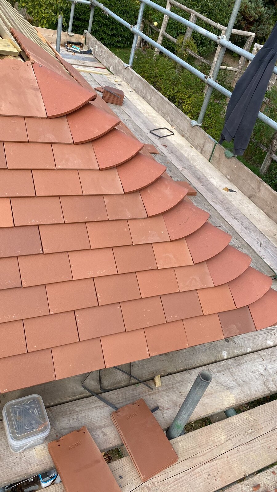

As best practice its best to fit the trays before the felt - but no matter when you would fit the trays in the OP's pic that felt is too short to do its job.
The felt in your sketch is also too short.
Yerss, it was a sketch of how I thought it might end up in this case, but then again it all wasn't to scale/had quite a bit of artistic license with flying tiles etc. I wouldn't be overly concerned if it was a few cm short- so long as it's long enough to have the tile resting on it to keep it in place, any water getting on it should end up on the support tray and be felled into the gutter regardless (and any felt that sticks out into the sun will probably be trashed after 6 months anyway).
I tend to run a line of gutter sealant in the 6" overlap on my trays but even if it wasn't there it'd be quite atypical for water to track sideways 6" when it's on a downward slope induced by the tray -
While not an ideal length it's not an insurmountable problem, worst case it's about 20 minutes to pull the bottom batten off and slide a rip of felt up under the existing then nail the batten back on

Tiled or slated correctly underlay and support trays are surplus.
No trays or underlay here .. no felt even .

Approved Document C2 - Section 6 requires felt below the tiles. (Section 6 FWIW uses both the terms felt and underlay).
Are you claiming to know better than Common sense and a century of UK roofing experience?
Tell that to BCO or a very angry householder whose family have been soaked one stormy night?
That's terrible. Wind blows water upwards. The big holes the corner tiles opened up will result a waterfall inside the house. Might I suggest filling those big holes with hybrid polymer sealant?

There are times when no underlay or trays are what is required and compulsory .. go and google it if you can..
Nut . you're out of your depth. Those that know will know what they are looking at ... jeez
Your own words say that underlay is "surplus" - surplus means the amount left over after what is required has been used.
Why do you try and wriggle away by including "trays"? I specifically mentioned Section 6 referring only to
"felt and underlay"?
