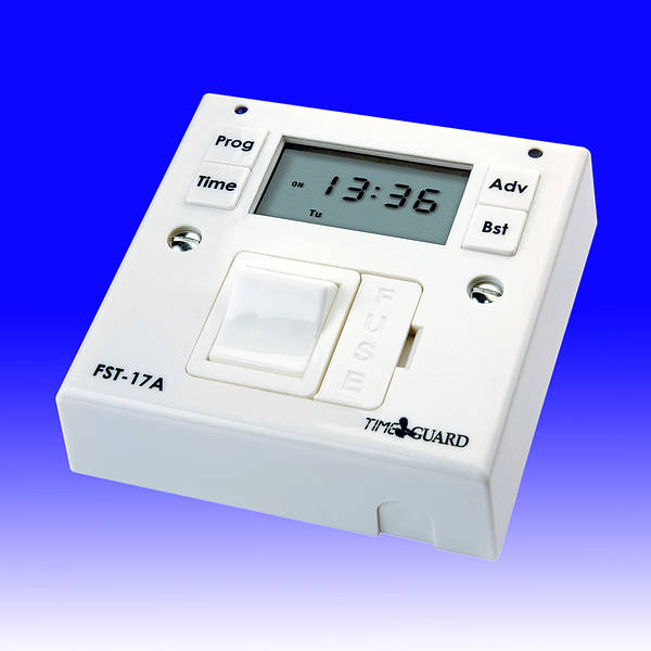

Don't suppose there's room in your CU for something like this, is there?
Alternatively, 2-birds-with-one-stone approach - do you think the kids would mess with something like this?
