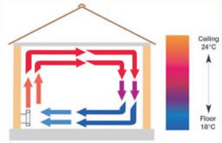

I see the problem, circulation.jpg we are looking at how the air circulates, not just a spot temperature. So heat leaves the top of the radiator, goes along the ceiling down the opposing wall, and along the floor back to the radiator, so the sensor needs to be on that route, putting a thermostat 90° from that path, and it will not reflect the heat of the room.

However, I have one boiler, and 14 heated areas, using the lock shield valves we can at say 22°C in the target area, arrange other areas to heat to a percentage of that temperature, but change it to 17°C in the target area, and all those percentages are out, the TRV (thermostatic radiator valve) can help, we can set 61dmtMm13BL.jpg the maximum room temperature, and measuring near bottom, and to one side of radiator ideally placed to measure the return air, but it will not fire the boiler, you can however get versions
which will fire the boiler through a hub, so what we are looking at, is how far to go. While heating is running, the movement of air means the room in general gets warm, but before the heating starts, so little air movement, we can get cold spots, so against the wall under a window will be colder, if this is where we are measuring the room temperature, then the boiler will start a little prematurely, as to if this is good or bad not sure, but you can get systems where the sensor is not in the TRV, and even TRV heads which also measure water temperature and compensate for heat direct from radiator.
So nothing to stop one having no wall thermostats and use the TRV heads to control the heating in every room, but we tend to look at cost, and also question if a boiler will work well if asked to output just 2 kW, I am an electrician so can't really tell you about boilers, but in my main house, every room but bathroom, has programmable electronic TRV heads, of them only one can call for heat, I also have two wall thermostats, one in living room and one in hall which can call for heat, so three locations in the house can cause the boiler to fire up.
