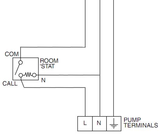

Wiring a room thermostat into a Danfoss 102E5 controller.
Traditional gravity fed system, 1 x room thermostat.
I thought it would be just a matter of connecting the thermostat wires to the controller outputs. So the thermostat turns the controller on and off.
But the Danfoss manual shows a connection to the CH pump. Is this needed for basic system?
If so, it is outside my DIY comfort zone.
The thermostat is used to switch the pump on and off - which will circulate the hot water through the radiators.
The pump N & E are permanently connected. Live is output from controller - thermostat - pump.
If you wire it so the thermostat turns the controller on/off, your hot water won't work unless the heating is on.

If the thermostat you have doesn't require a neutral, then you just need the two live wires.
Yes, that's the same diagram from the Danfoss manual I downloaded.
It doesn't look too complicated if I get a 2-wire stat.
You need three wires and earth cable i.e. four conductors.
Get a programmable room thermostat or a battery operated thermostat and wire that between CH terminal on Timer (having removed the wire from that terminal) and second wire from new thermostat connects to wire that use to terminate at CH terminal on timer. Hope you can understand what I mean.

Mechanical stat invariably needs three cores plus earth (live, switched live, neutral and earth conductors) whereas programmable roomstat or battery operated stats need live and switched live (two conductors only).

If you really can't deal with installing 3 wires, then get this one:
http://www.heatingcontrolsonline.co.uk/siemens-raa20-room-thermostat-p-311.html
which only needs 2 wires - live in from the controller & live out to the pump.

Advice given is based on what I have done many times. As a service/ repair guy I have fitted plenty progstats to old gravity hot water systems. End result is HW works as normal for gravity circulation. CH demand from progstat runs the pump and fires the boiler till ambient temperature reached.

You cannot have CH without hot water on account of way your system is plumbed.
Fitting a standard roomstat will now allow you to control the pump, thus the heating side of the system, BUT the boiler will continue to run for the duration of timer being on.
My suggestion switches the boiler off as soon as thermostat is satisfied UNLESS you already have a HW demand running.
