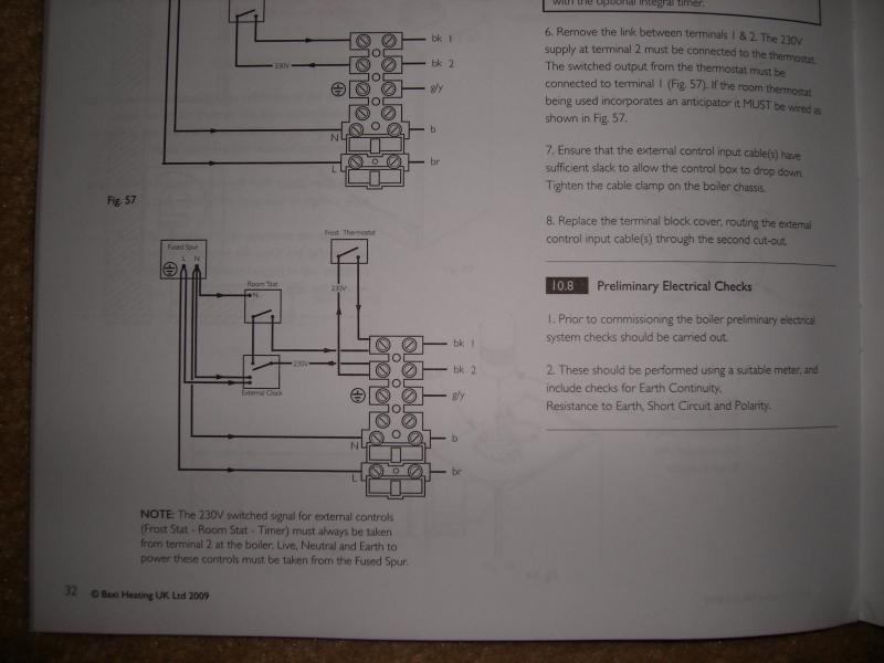

I moved house in 2012, and I'm not now sure the boiler/CH system is working as it should.
House seems warm enough and not had any problems with it stopping functioning - CH warm, HW warm etc, but I noticed the other day that the room thermostat appears not to affect boiler operation, so I got curious.
Boiler is a Potterton Promax Combi HE plus
I've had the front off the boiler today and a pic below:
According to the manual that was left:
I'm thinking the yellow loop at 1/2 shouldn't be there and these should be connected to the room thermostat downstairs?
I'm guessing having this loop in will keep the boiler running all the time the timer has it swtiched on, and so not done me any favours with my gas bill!

Ha ha I like that one, your room stat is a mere decoration unless a manufacturers internal wireless configuration that over rides your external controls link has been used (dont sound like it though) dont go near BG untill it is sorted they will not sort it out without charging before they take you on cover which is only fair to be honest, get an independant to sort it out for you
The link is for running the boiler on timer only. You are correct. You have no warranty without the benchmark. Get the thermostat wired in by a local Registered Gas Installer/Engineer, initially just tell them the thermostat isn't working - it's a small job that you can use to sound the engineer out before you get them to look after your boiler for you. And check their Gas Safe card!

The boiler used to be downstairs in the kitchen, so no idea if the thermostat wiring goes anywhere near the new location in the upstairs back bedroom. Might be tricky finding where it comes out. Will need to do some detective work.
If you actually want a room thermostat cheapest option will probably be a wireless one if the wiring is not already in place but if you have TRVs on the rads then why bother ? correct use of the timer and TRVs is far better than a room stat or do you not have a timer either ?
Don't worry about finding existing old wires, get your man to fit an RF stat.

A salus wireless unit (RT 500 RF) costs about £60 for the programmable room stat and receiver. A programmable roomstat will save even more money. Honeywell have wireless units that are fully programmable for independent days of the week.
If you are happy enough with the timer/programmer that you have and your rads have TRVs then I wouldnt be fitting any type of room stat you are just wasting money by doing that, we as installers have to install a boiler interlock but if it was up to me I wouldnt as it over rides all your TRvs, it is there to tell your boiler that the room that does not have a TRV installed has got to temperature and shuts down the complete system
I don't really see a programmable room stat as a waste of money. They provide an interlock and save money. Not to mention it's a minimum requirement and best practice.
