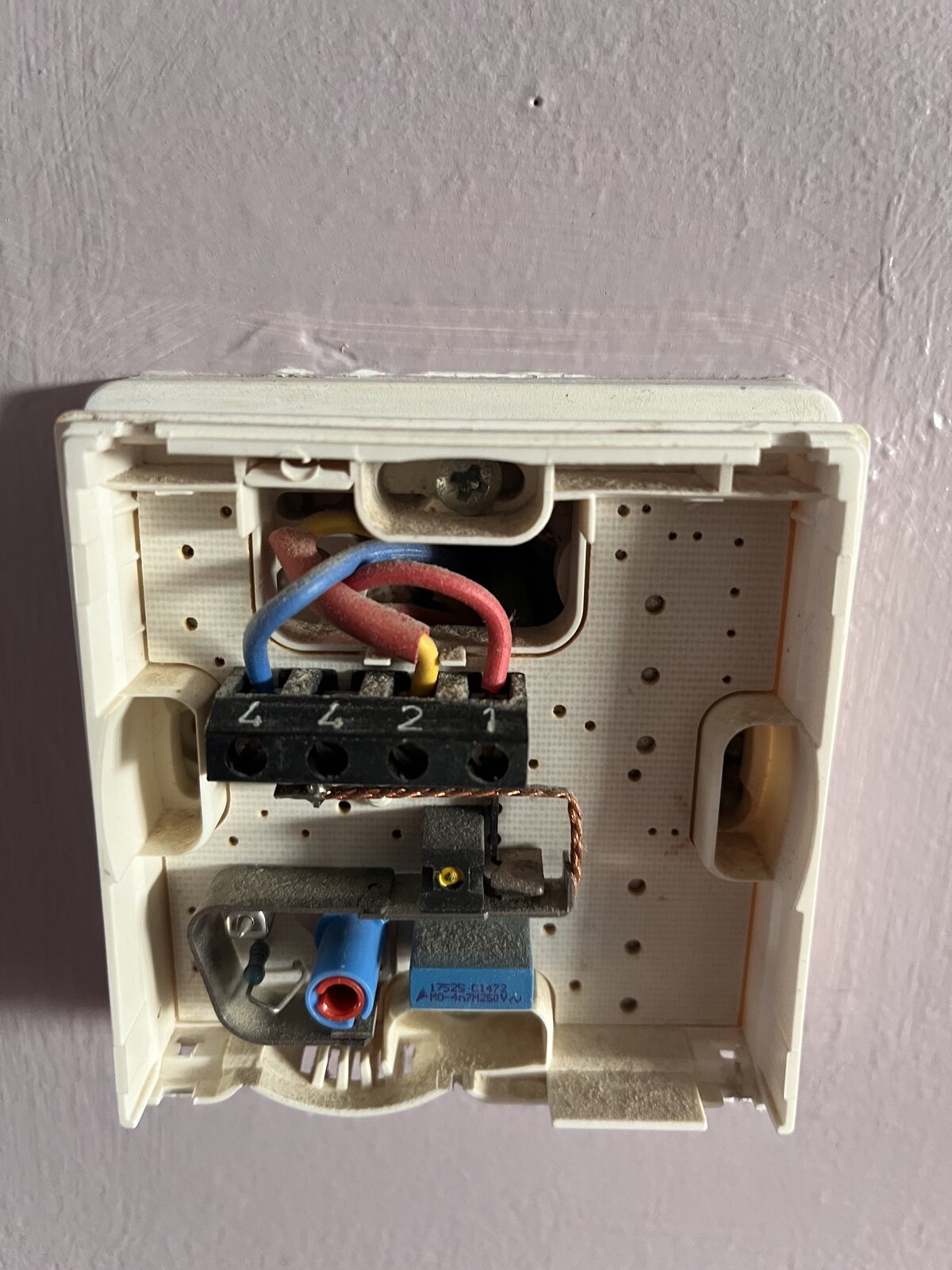

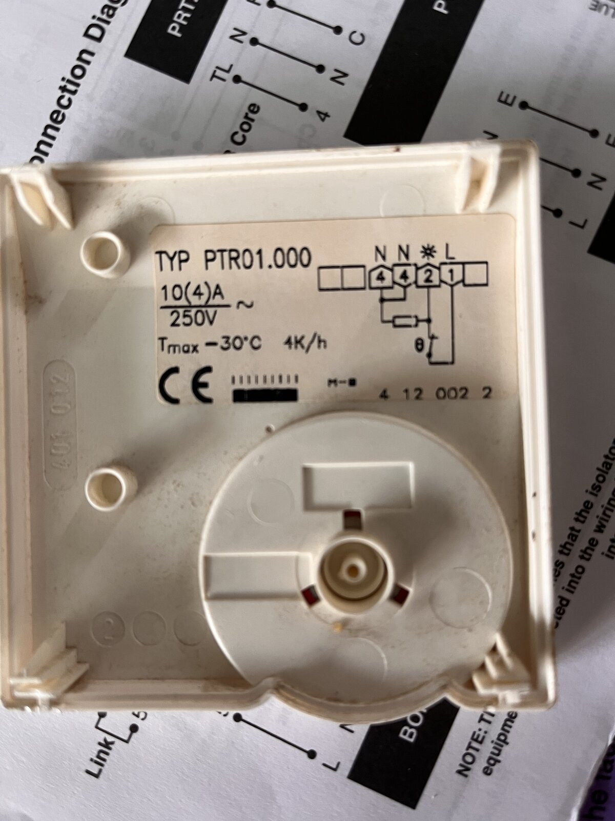

I’m just replacing my old PTR01 room thermostat with a Beok one and just wanted to double check the wiring before I pop something and then have to face the wrath of my wife…
The old wires and diagram:
A4835B22-D1A8-4D20-B9EC-944A71EB5886.jpeg 98A37AAF-A1C8-45EE-B3A0-0F4B01EC4FB2.jpeg

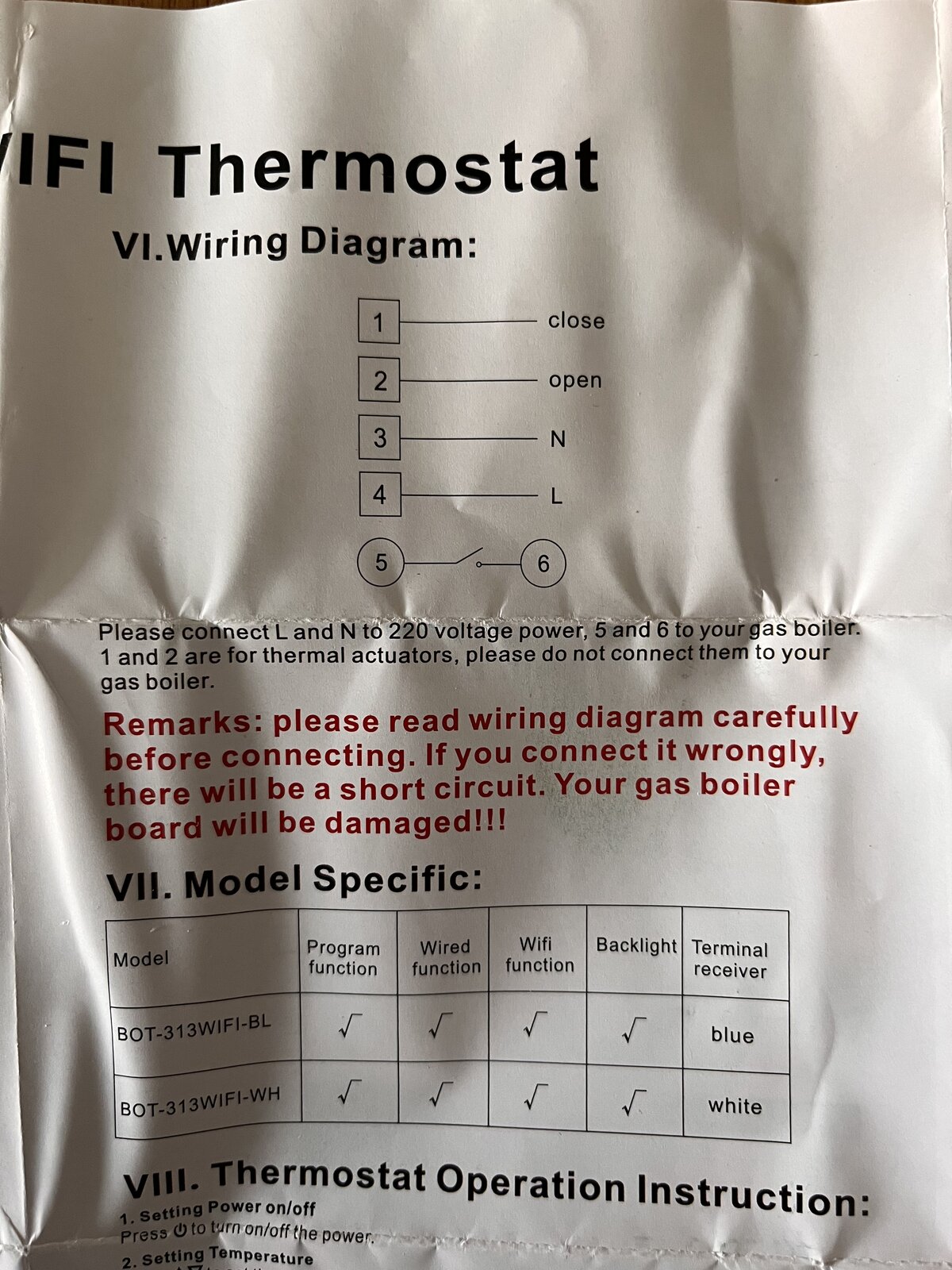

And the new instructions:
My assumption based on this:
Blue (old 4) goes to N (new 3)
Red (old 1) goes to L (new 4)
Yellow (old 2) goes to 6
Does that look correct?
many thanks
It does as far as it goes. Terminals 5 and 6 are connected to a voltage free switch, so you would also need to add a link between L and terminal 5. Otherwise there is no power for the thermostat to switch.
