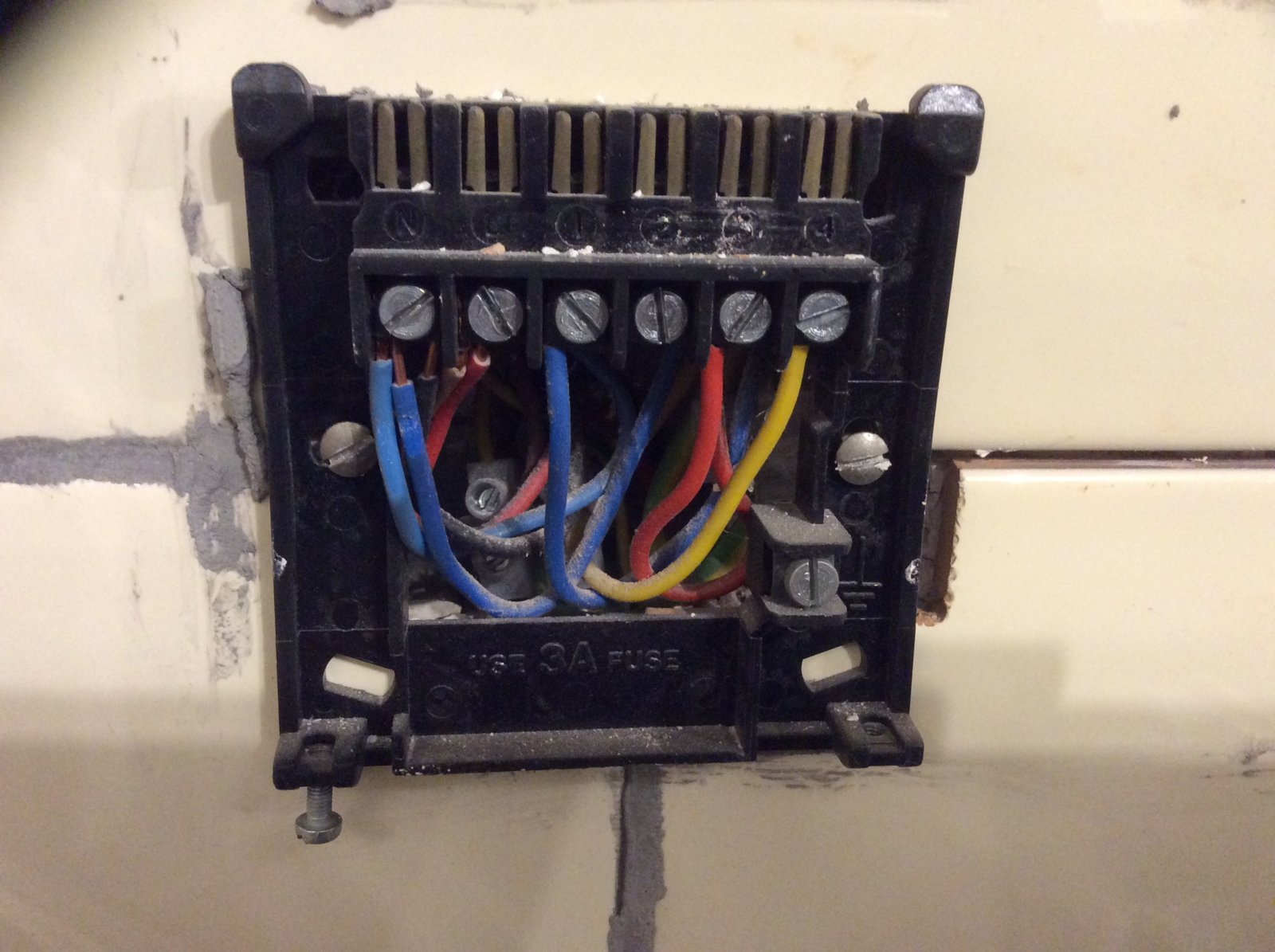

Thanks for quick reply room sat is Drayton I have found a wiring diagram the boiler i will send photos
Hope these help you to help me further.
Cheers.
Thanks. It's a Drayton RTS1 wired as below.
When you have traced and found the origin of the thermostat cable and removed the wires that go to the thermostat (L) and (3) terminals, a link should be inserted to join the 2 terminals together that you have just removed them from.
The neutral wire is just disconnected.
No need for the photo of the boiler wiring nothing changes there.

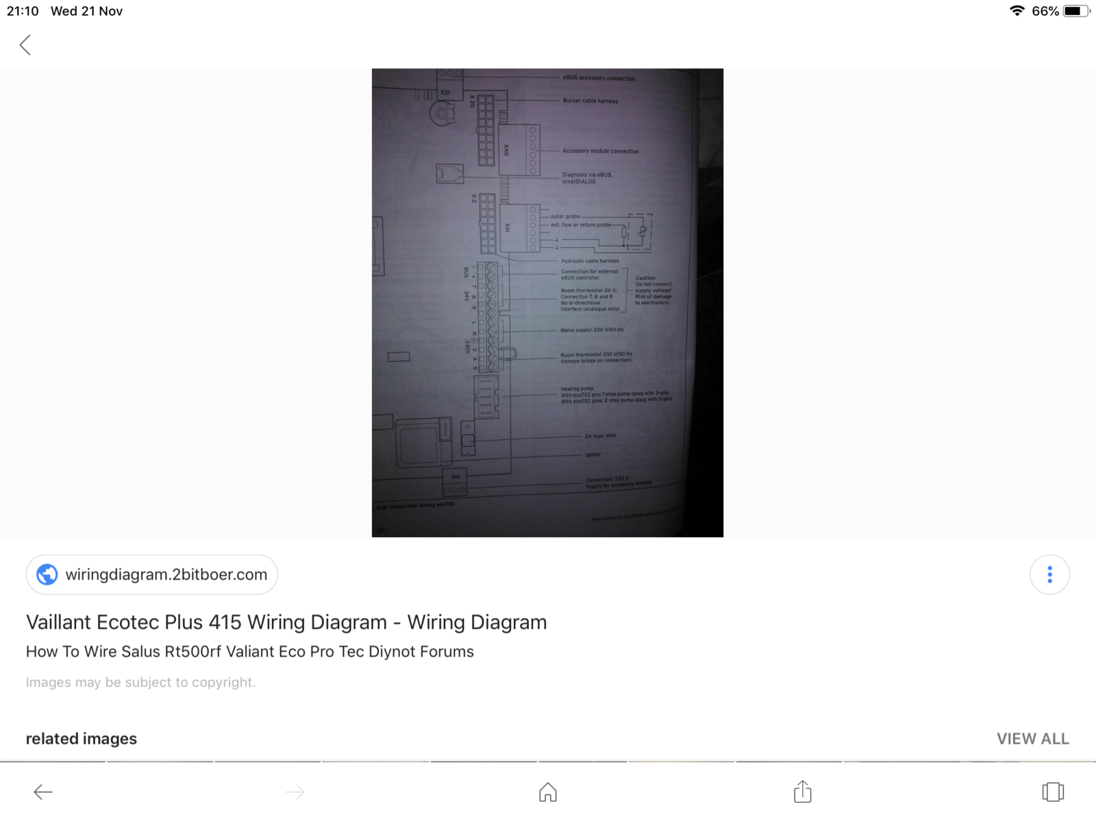

So the room sat does not go to the boiler pcb inside the boiler as the wiring diagram shows then.
That's a bit of a curve ball! You are providing conflicting information.

Then the room thermostat won't be connected to the boiler, you are probably looking at the wrong boiler wiring diagram. The Vaillant Eco Tech comes in several variants.
Hi @stem just a wee note if it is a valliant boiler beginning with a 4 it is a heat only boiler a system boiler begins with a 6 and a combi begins with an 8 the next two digits are the boilers output in KW so the 415 is a 15KW heat only boiler and yes I agree OP was looking at the wrong wiring diagram
That's what puzzled me. I thought that the 415 was a Heat only boiler, but couldn't understand why the picture the OP posted said EcoPlus 4 (heat only) but the wiring diagram showed the wiring for a combi. I had assumed that they were from the same source, obviously not.

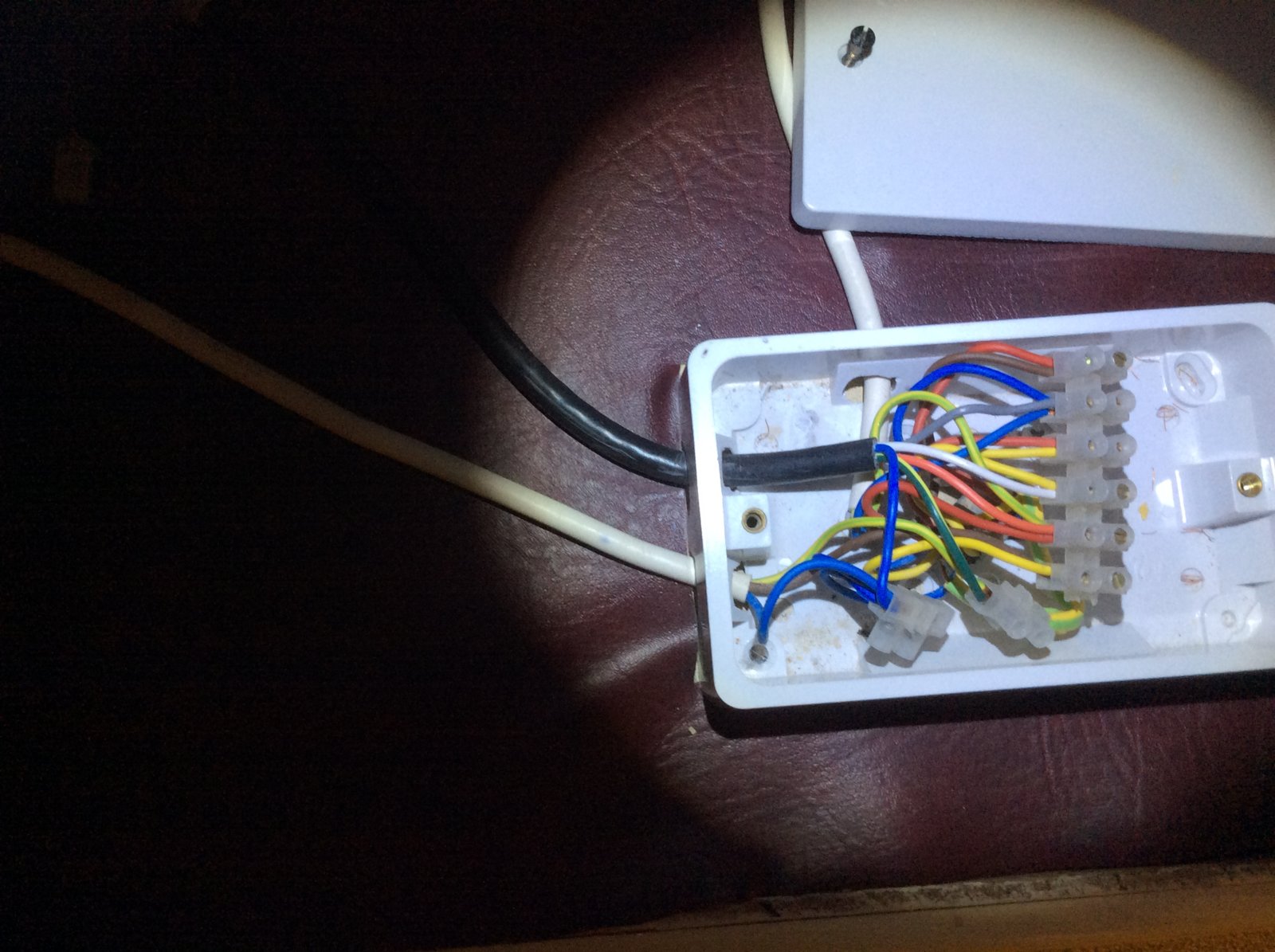

Hi stem I found the junction box I think you referred to and a lot of wires to try and find the room stat
The system is a y system I attached photos.
I can give you a bit of a clue to help you start tracing it.
One of the thermostat wires will be connected to the white wire of the motorised valve. It may not go there directly, but that is where it will end up.
White wire goes the pump black to motorised valve I suppose multi meter and get the wife to turn
The room stat up and down to try trace the correct wires.
