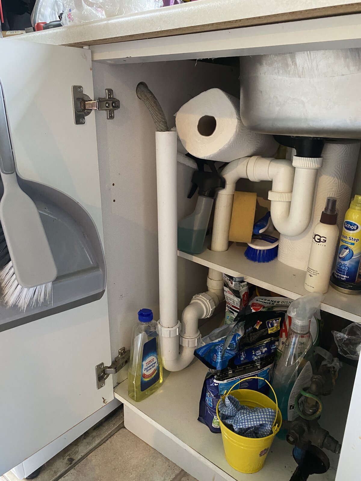

So I have undone the ubend that is connected to the washing machine and it's full of black stinky gunk. I have put a rod down it but didn't seem too clogged up.
How do I clean this out? The pipe goes away from me then left and out of the house.
There is a sink above it - this is a utility room.

Surely both machines have waste pipes that run upwards- meaning that the water in the pipes stops the back flow of smells?
That said, when you empty the sink, some of the water, from the sink will be forced in to the device shown in your photo.
Why isn't there a visible u-bend?

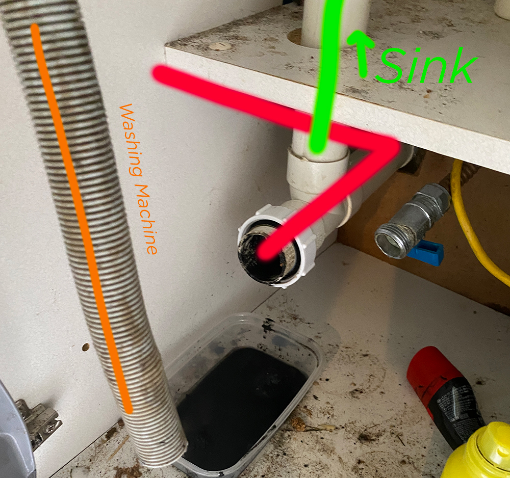

I took the u-bend off to check it. The smell is definitely coming from this pipe in the photos with a red line. I just don't know how far down this gunk goes...
Oh sorry, so you mean that the spigot for the washing machine runs in to a u-bend before it gets to the bit in the photo?

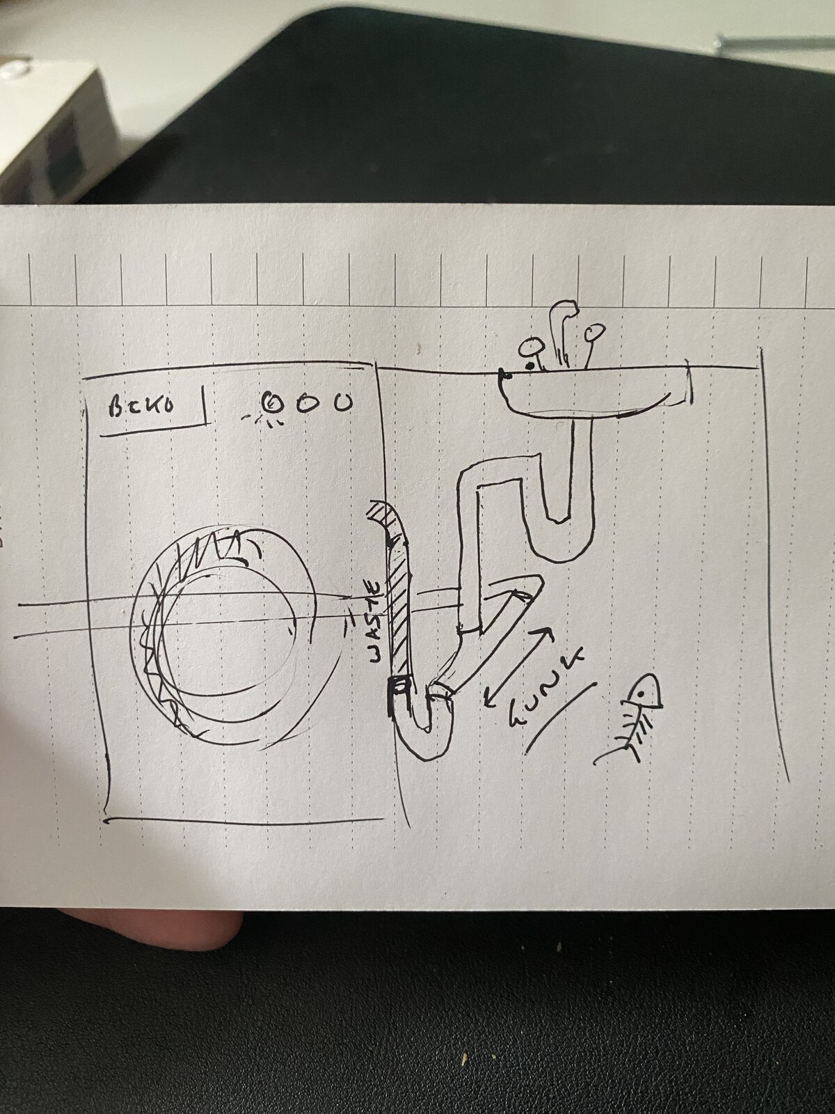

Here's a picture of the bit I took off, put back in place - thought it was a u-bend but maybe not then?
And a diagram.

Thanks for the photo.
it looks like a mess, but I admit that I am not a plumber.
you are correct that it is a u-bend.
Unless/until corrected by a plumber, I am working on the assumption that some of the water from the sink will rush in to the u-bend for the washing machine. Some of that water will be quite fatty/greasy.

The U bend for the washer, needs to be located higher than the near horizontal pipe it discharges into. At the moment, the water debris exiting the sink, is back flowing into the washer U bend. Who ever installed that as is, didn't think it through properly.
I would replace the (as it is now) U bend with an elbow, then a short vertical section up to a U bend, leading then to your washer discharge point.
Check your other washer, it may have a similar problem.
it's great fun guessing what heights the pipes and connections should be, might be, and are.
The U-bend on the standpipe is too low, causing water to run back into it.
If it was higher than the outlet pipe that probably runs to the wall under the sink, water would not run back into it.
