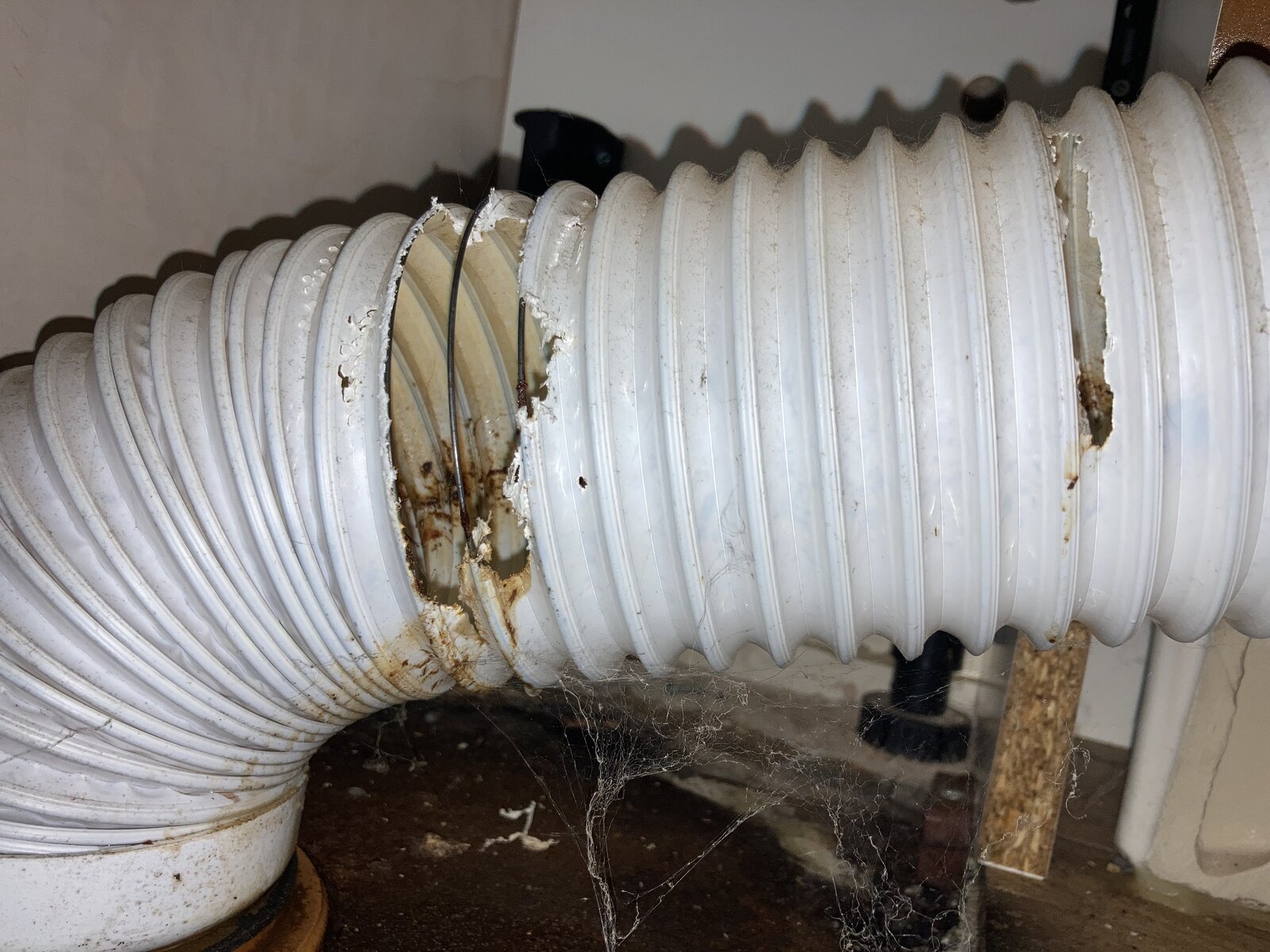

While investigating smells from the downstairs WC I found the flex pipe hose has disintegrated in three places.
It has been installed for about 6 years. Is this a problem with these hoses, or is there something else I should look for? Thanks.
You can buy a one way valve that prevents rats from entering the flexi pan connector, from the drains. It fits onto the end of the pan connector.
Think Macalpine call theirs a rodent barrier.
Best find a permanent fixture using solid soil pipe, even rodents can lift rodent barriers. Sorry, McAlpine, but they do.
Definitely Ratty McRatface having a nibble. They can climb out of toilets too.
Food for thought.
Don’t leave your nuts dangling! So Confucius say!
Easy remedy for chewing is hard pipe it. A flap helps but an interceptor may be a good idea.
Get a decent drain guy in and maybe pest control.
