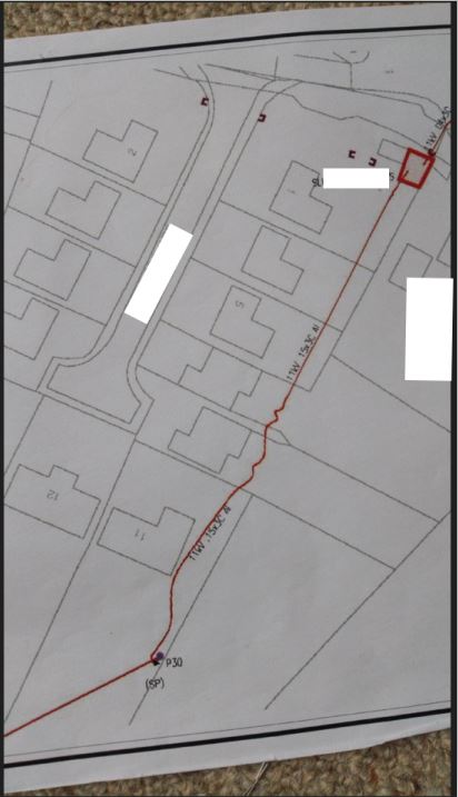

Thanks JohnD. I have the original easement which takes the form of a binding conveyance between original owner and Southern Electricity Board in 1967. This was for the transfer of land for the substation at the bottom of the close along with the connecting underground/overground cables, poles and ducts running across the other parts of owner's lane. They say that because the easement says 'approximate route' they can and did stick the cable where they like and its my fault the wall fall exposed the cable. This is a comparison of two images (we are house nearest the pole). Original easment - looks more or less tight to the boundary to me - running north (up) from the pole. The second image is the actual line of the cable...all over the show. Now to me that doesn't look enough of a match to be called 'approximate' as I would think approximate would mean any route within a defined/hatched corridor...otherwise whats the point in having a plan. I'll take other views gladly.
It seems to me that the original plan put the duct close to the boundary where it would be clear of the buildings
but the as-dug is too close to the buildings. And does not look reasonable
I knew of incidents occurring where people worked off the plan and hit cables that did not correspond with it. AFAIK they were rerouted.
this probably needs a person with legal experience of such disputes. I'm sure you will not be the first.
I notice that as well as the route not corresponding to the plan, SSE say it was buried at an unsafe depth. One wonders how it came to be done so badly.
One might reasonably say that the cost and inconvenience of putting right the poor installation should fall on the person responsible for the installation.

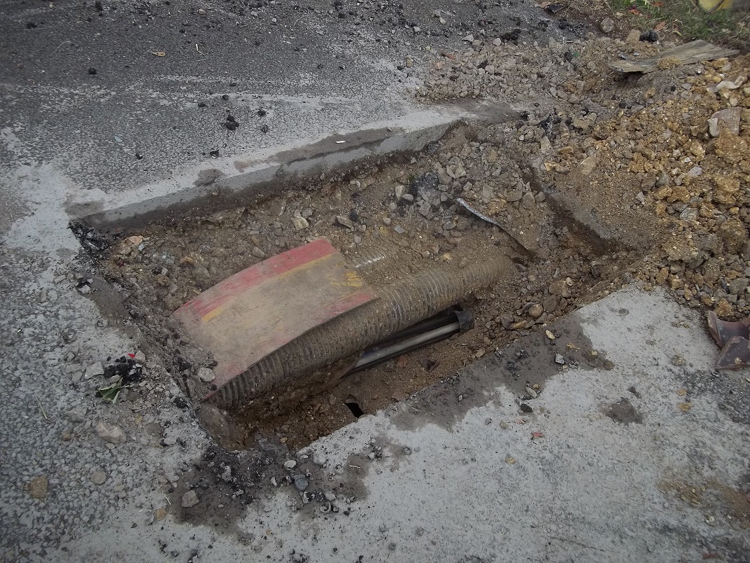

Close shave
Digger operator saw a fragment of the warning tile in the bucket and stopped
A fibre service work crew were digging to locate a telephone cable duct and hit the ducts for an 11kV main supply cable. This was today (24th June) about 100 yards from my house. Less than 45 minutes after the call to National Grid an inspector was on site.

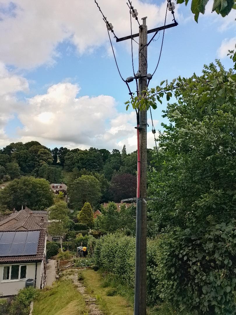

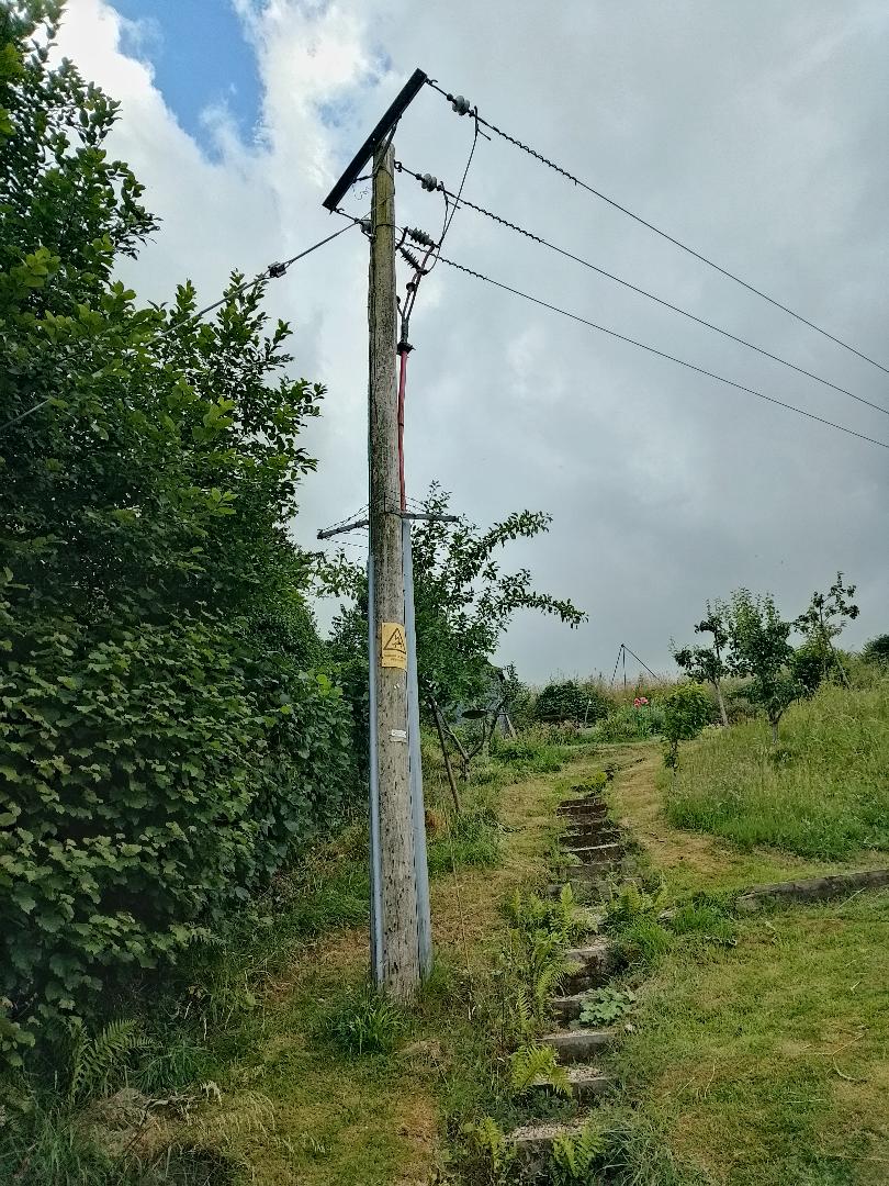

@oakysmokyjoky There are no photos of the top portion of the Utility Pole and as this whole topic/thread has just gained my attention and interest, I am curious as to the feeds up to and away from that UP. Next time you are taking photos, I'd appreciate some of the pole, its cables at the top and anything else concerning the UP . . thanks
PS .. I am a shareholder of SSE and just about to read the portion of the latest annual report concerning distribution.
Thanks for the photos. Yes, the 3ph 11Kv overhead does indeed drop down and then run underground to a transformer farm/substation somewhere to serve local LV supplies. IMO this must be a somewhat old arrangement not to have delta-star pole mounted trannies before serving a smallish community. It's situations such as this makes me glad my local supplies are all underground from overheads about a straight mile away.
