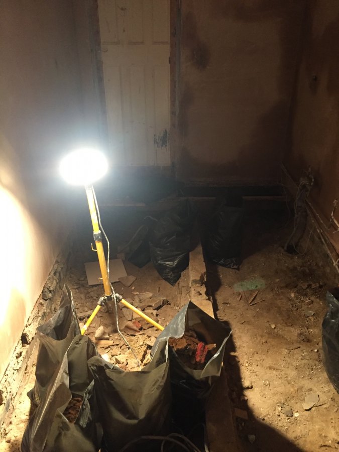

Hi any advice on replacing the joists that are embedded in the walls, one is an inside wall and the other goes into the inner wall of a poorly constructed cavity, house was built in 1938 and there is lots of mortar droppings in it

The joists have rotted with what appears to be damp rot and the floorboards appear to have woodworm or something too

You don't replace the whole joist, just the joist end. You'll need to widen the hole that the joist is in, then wedge up the joist from underneath, and cut away the rotted part. You want a replacement piece of joist in tantalised timber, at least 1.5M longer then the damaged part. You place the new joist alongside the old one, and use a couple of clamps to hold it in place. The next part is the tricky bit, you need to drill through both joists, ideally horizontally. I have an angled drill, and I use stubby drills. You need to use 3 coach bolts (no:cool: for each new joist piece, that are long enough to go through both joists, and then put a flat plate washer on the nut end, and then put the nut on, and tighten it up. Having wedged up the joist before you started the job, then the joist should stay level, and you check with a spirit level to the adjoining joists. You want to put a piece of plastic DPM underneath the joist end where it sits in the wall, and obviously, you've got to find out why the joist rotted in the first place. Was there earth up the wall inside, or is the ground too high on the outside.
If there's evidence of woodworm, is it old, or is there fresh wood dust around the holes. If you want to play safe, then get some woodworm treatment, a cheap pressure sprayer, and lift every 3rd or fourth floorboard, and spray from each side underneath each lifted board, then on top of the boards, not forgetting both sides of the boards that you've taken up.

The outer wall ends are rotten (Originally a sink there too before we lived there not sure if that contributed)
The rest of the joists are woodworm not as bad as the floorboards and a few of the joists are rotten and crumbling up to a metre from the wall
So basically I have a pit with a sleeper wall in the middle! I guess that changes things slightly

If the ends are chronically damp due to issues with the wall, you should really solve the wall issue first or keep the wood away from the wall. Consider digging the over site a little and building a foundation for a sleeper wall to keep the timber away from the damp.

Hi thanks for the reply I wouldn't say it was chronically damp and the inner wall certainly didn't feel damp there is certainly rot of some type I would hazard a guess and say damp rot there was lots of soil build up along the wall under the floor but not what I would of thought was excessive
There is only one air brick under the floor which is the size of 2 bricks on top of each other so there is no cross ventilation as such but the rest of the house isn't sealed from this room as all the walls below floor level are honey combed
There is a gulley type drain that is against the wall in that area which will no longer be used when kitchen is finished so I wonder if that's the culprit? It has flooded a few times when it has been blocked with leafs and is in the correct area

As above and yes that's fine to split the lengths over the sleeper wall, also best to wrap the ends that are inserted into the wall in DPM, first I would remove some of the soil build up and there would be no harm in laying a DPM over the soil as suggested, together with some more airbricks . as also suggested try and get some cross flow if possible
I thought I had a better picture this is after removing 6 bags of soil rubbish etc.
The walls have been plastered so that's why they appear damp but the area with the most serious rot is on the right if you look you can just make out a damp patch next to a bit of green expanded foam
This is exactly where the drain is on the outside wall, it was a bit built up with soil there
Also just remembered this is directly below a upvc window now bricked up
Could also be my liberal use of the hose pipe in there too disguising what is just dry rot and woodworm making it look like damp rot as there is a large ish hole there were the water pipe comes in?

You appear to have a timber plate that the joists are sitting on - completely remove the plate and dont replace it/them unless you wrap the replacement in a fold of DPM material to prevent contact with the brickwork.
Make a hole(s) in the brickwork & open the cavity and clean it out to at least below the joists/plate.
Make good the hole(s).
Lay a DPM across the whole floor.
Honeycomb the sleeper wall.
Install two 10 x 6 plastic air bricks in the outer wall.

Make sure you've got a good airflow on both sides of the wall. You're idea of cutting the joist in half is reasonable, but you still want to overlap them in the middle by about half a metre, using a couple of bolts - this'll stop any twisting and rotation.

The new joists are 1.6metres each side and the room is 2.2metres so there will be approximately .5metre overlap
Some joists are still in place in the picture, they do run left to right and only sit on bricks which are engineering in the outside wall, I do have some DPM somewhere so will use
