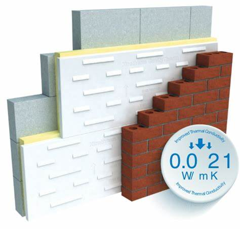

The latest Part L reg's are a 'mare in terms of size, cost and installation. Long screws are costing a quid each these days. Fitting the PIR on any job costs thousands now.
I've just completed my first catch-up extension since the 2022 Part L changes. Prior to the change, I could furnish a 4m x 4m, 100mm cavity extension with cavity insulation (Dritherm) at a cost of £132. The same cavity size today costs £1000 to furnish using Unilin PIR boards.
