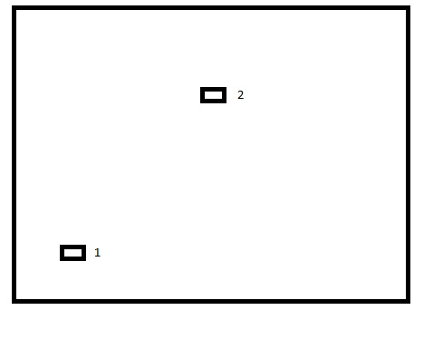

Afternoon all, wanting to wall mount a TV, and will need a double socket put in behind it.
I'm going to get some quotes from local spark's, and just wondering what peoples' opinions are on what would be a fair price to install a double socket into a drylined (dot and dab) wall? There is another socket which can be spurred off aprox 6ft away on the same wall.
Would do it myself, most difficult part will be rishing the cable through, but there are so many regs around this now I'm not sure if it's legal now. Is a spur off another socket classed as notifiable work etc? Is a minor works cert needed?

Extending an existing socket is not notifiable work. Strictly speaking, any electrical work should result in an EIC or minor works cert. There's no reason why a DIYer can't complete such a certificate, but few would have the equipment (and/or knowledge) to undertake the testing which is theoretically required after any electrical work.
If the socket from which you intend to spur is part of a ring circuit, you would have to confirm that the socket in question is actually part of the ring (and not already a spur), since 'spurs from spurs' are not allowed. The buried cable would have to be routed in permitted 'safe zones' (primarily, vertically or horizontally aligned with visible sockets or other accessories). Your new circuit would be required to be RCD protected - does the circuit from which you intend to spur already have RCD protection?

The house was newly built in 2015, and I (as the only homeowner) haven't done any spurring off this socket, so I would think I'm safe to assume it's part of the ring. I would still check though, don't worry. Regarding RCD, yes, the whole house is covered.
Without having to chop up the plasterboard and rewallpaper, how would one get a t&e from existing socket 1 on attached diagram to new socket 2 whilst keeping to safe zones? Even the sparky I spoke to on the phone said he would have to try and fish the cable through the dot and dab with rods?
Yep, something like that. The cable would have to either go horizontally from socket 1 and then turn a right angle and go vertically upwards in line with socket 2, or vertically up from socket 1 and then horizontally to socket 2. In either case, it will be difficult to be certain that the cable remains within those zones throughout it's length!

Or, if the floor construction permits it, down from #1, along under the floor, up to #2. Although if it does permit it then you almost certainly wouldn't need "down from #1", just come off the cable already under the floor. Could even extend the ring rather than spur.

Unless the electrician has access vertically above or below (in both planes) the new location, and has a 2-2.5m drill bit, and space to use it, then cutting holes will be the only alternative. There will be noggins, or noggins and studs, in the route - good news is that running through them helps keep the cable in the safe zone, bad news is that you can't cut a path through them without damaging the plasterboard.

Down from #1 + up to #2 Ξ up from #1 + down to#2.
My comments re cables under the floor might apply to under the floor of the room above.
But from above, how do you drill down through the noggin(s)?
Whichever way you prefer to pass cables through noggins behind plasterboard.
It's probably moot because the OP said it was dot and dab.
Without any damage to plasterboard and decorative surface finishes.
Probably not and I think the OP's drawing is putting the socket further up the wall than it really would be.
Sometimes, though you can see down behind the plasterboard from upstairs, so, as I said - may be lucky and find no noggins.
