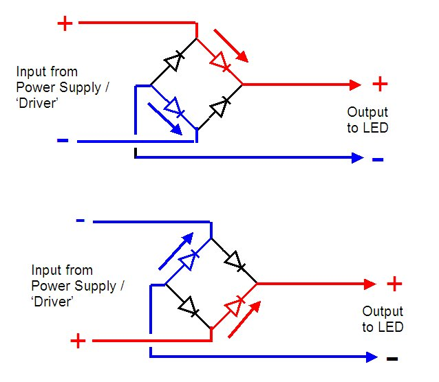

So if you connect dc supply the wrong way round from a driver, will the lamp will still work when the rectifier within the lamp is controlling the polarity. And the LED is a diode controlling the current flow direction (one way valve).
IE: + to - and - to +

As I said, they use a bridge rectifier (a ring of 4 diodes), like this:
As you can see, no matter what the polarity of the input is, the output (LED) is always the same (correct) polarity.
Does that help?
Kind Regards, John
Well done, JohnW happy new year.
I assume your drawings in turn, also explain how they run on DC even with the Alternating cycle of an ac supply,
Just going from the top drawing to the bottom drawing and repeating again and again so many times a second

Well done, JohnW happy new year. I assume your drawings in turn, also explain how they run on DC even with the Alternating cycle of an ac supply, Just going from the top drawing to the bottom drawing and repeating again and again so many times a second
Exactly - that's why the same lamp can work on AC or (either polarity of) DC ....
