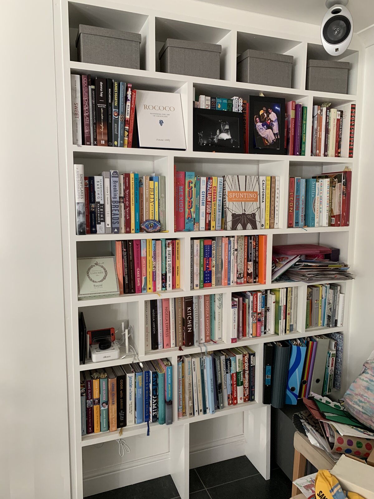

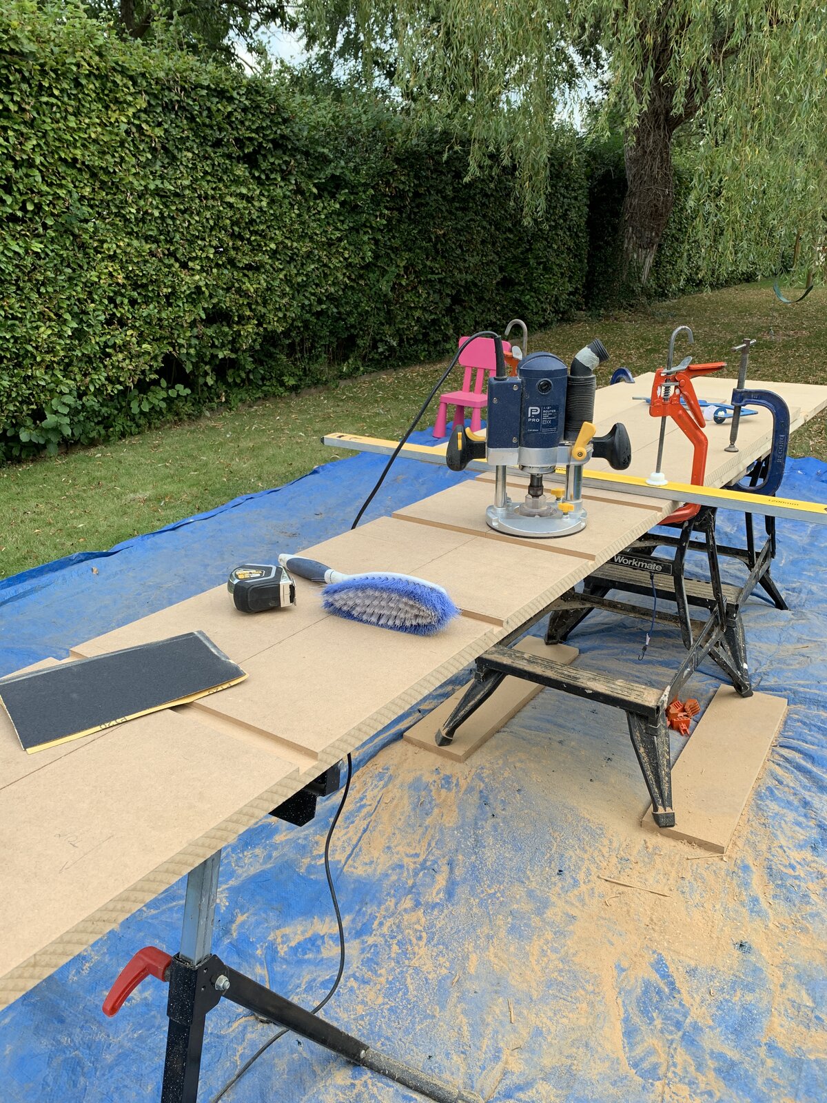

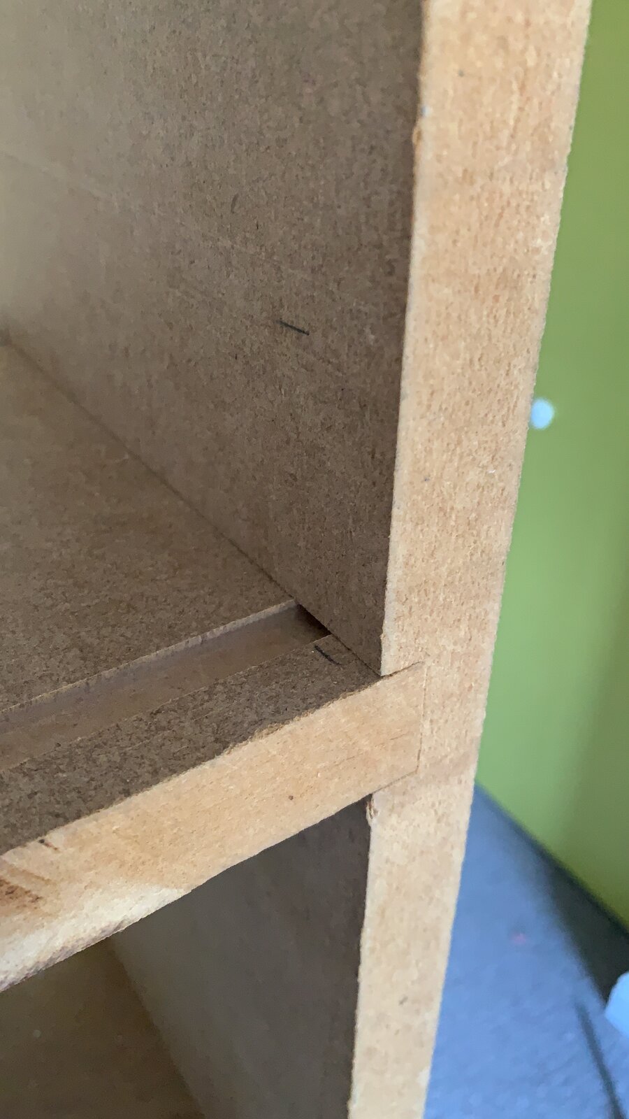

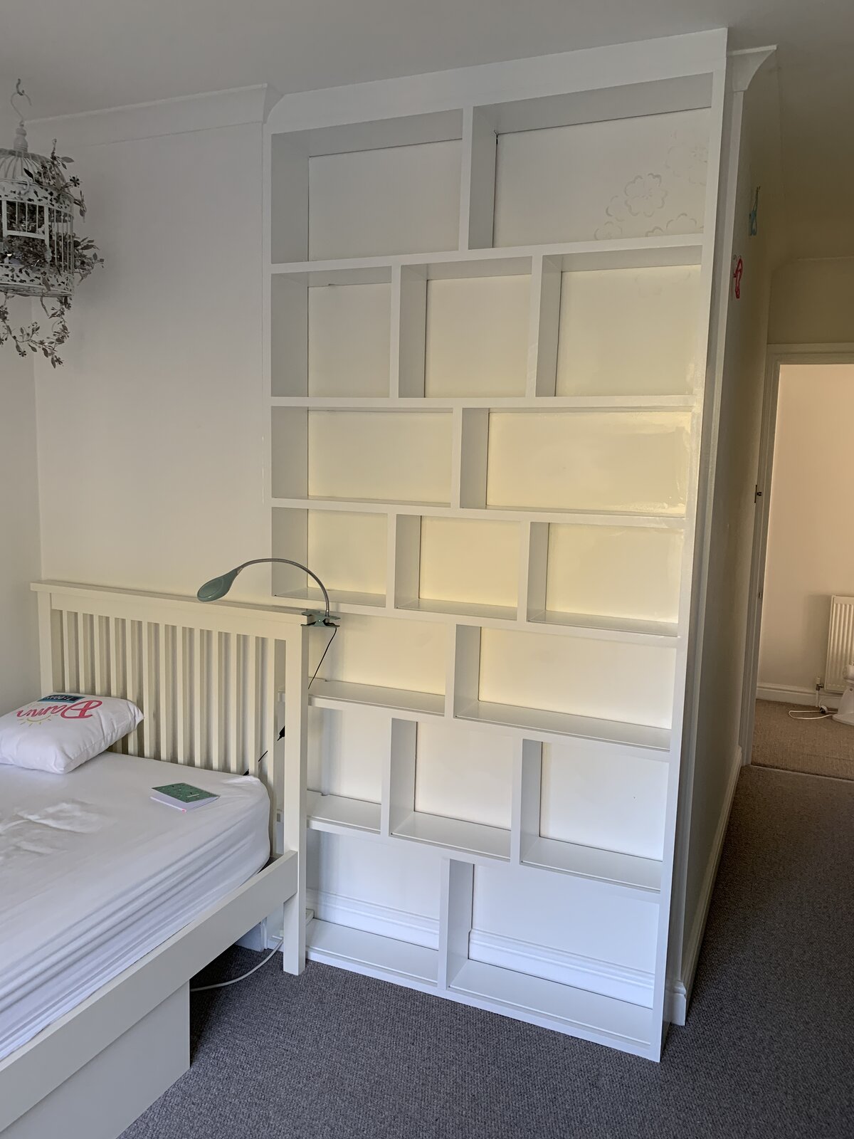

My first project is another built-in bookshelf (see below). As you can see from the pictures, I tend to router channels to make it more sturdy, and to stop books slipping when stored on their side. I'm a total beginner but theses have proved reasonably successful. This time I'm wondering if there is a more efficient way to do the channels, that doesn't involve a straight edge (spirit level) and clamps?
My next project will be a set of fitted draws/cabinet either side of our front door. I don't know whether to buy Ikea draws and cut them to fit, or make my own from scratch?
When it comes to ripping wood I tend to use a router with a straightedge (very slow), or a jigsaw. I don't own a circular saw but have again borrowed one for this purpose in the past.

As a diyer I researched all the expensive woodworkers benches, and found that flexibility was more important in practice. Get your panels cut down by the supplier so you can trim to size “on site”. A pair of trestles (or work benches) with a panel on top, are more flexible than a static wood working bench. A wide range of good quality clamps will cover most situations when used with a circular saw and router. Get a commercial grade vacuum (Nilfisk do a pretty cheap one) with hepa filter, it means you can work in the room for those tweaks and changes that are needed, and also prevent the garage being covered in dust. Use cordless tools wherever possible, including trim routers. They make a huge difference. I invested in the makita platform, the quality of their tools is in different league, but bosch, dewalt and milwaukee all have good ranges.
Be prepared to spend time inventing and building jigs for accuracy and repeatability.

Interesting point on the vacuum, I have an old Henry, I wonder if that would work for the smaller jobs? When routering MDF in a kids bedroom, I would still feel more comfortable doing this outside as it produces insane amounts of dust.

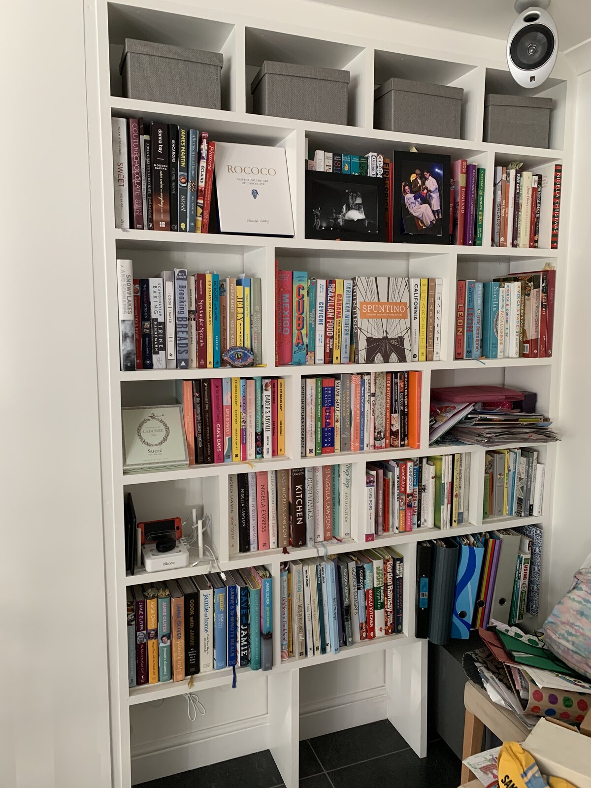

Appreciate your positive comments on my work as it is mine. I basically built a bookcase for my wife's cookbooks about ten years ago in the kitchen. I didn't want crappy brackets and shelves on the wall that would bow, and my wife wanted some books that could be turned on their side to display (see below), it worked out really well. Now everyone wants one in their room :)
My first home made 'Bench' was a 1.5mtr length of secondhand kitchen worktop with a piece of 3x2 screwed underneath for additional strength. Supported at one end by a cheapo workmate (Typically https://www.amazon.co.uk/Silverline-TB01-Portable-Workbench-100/dp/B000LFVGW0/ref=sr_1_10?keywords=workmate+benches&qid=1698658995&sr=8-10&th=1) at one end and an office underdesk cupboard at the other.
I've used that for 10 years.
Latterly I've added, not replaced, a MFT style workbench - I suggest that will be most useful for you.
Do look at Peter Millards Utoob presentations for suggestions on how to make the best use.

Track saws are popular and effective, people put 8x4 mdf boards on large sheets of rigid insulation and cut them outside, seems like a practical approach. Still use a home built t square of mdf which accepts the edge of the saw blade on the cutting line while automatically lining up the saw base to the straight edge.
