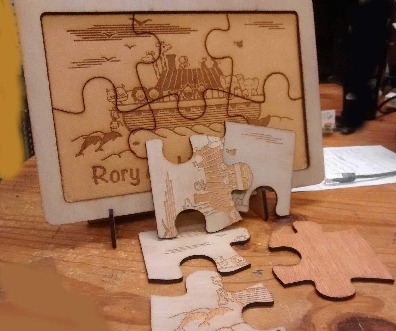

You can work from a pdf file
like this, which is about a4 size: Started with 16 pieces in the jigsaw , then someone said, hang on, he's 1 year old :rolleyes:.
So it got 6
Pieces are 4mm ply, behind is mdf. The picture is all laser engraved. 60W laser.
