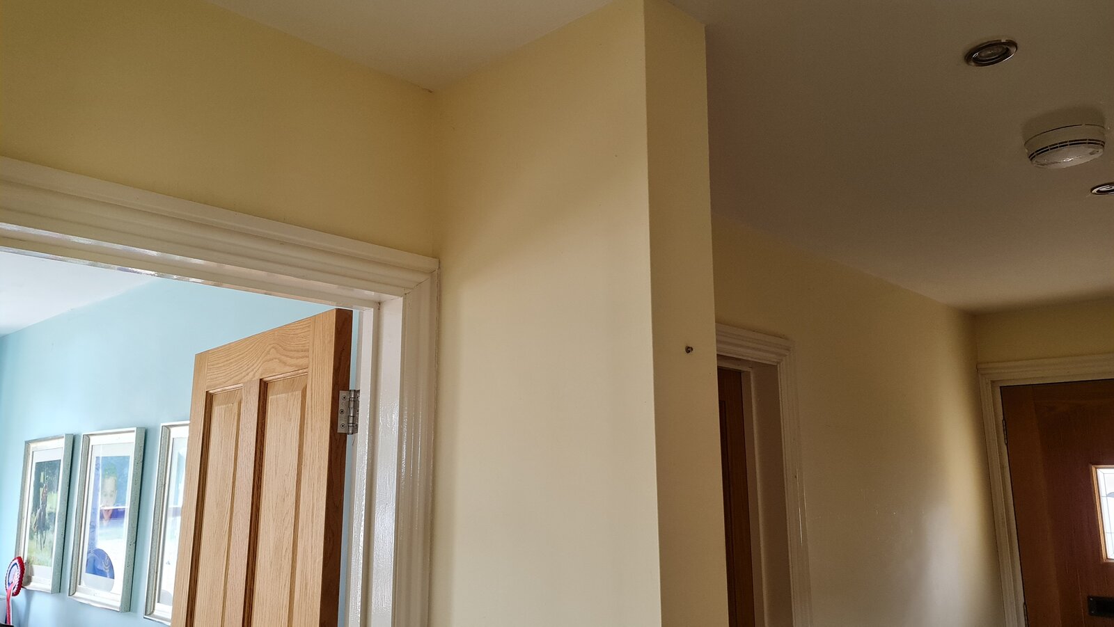

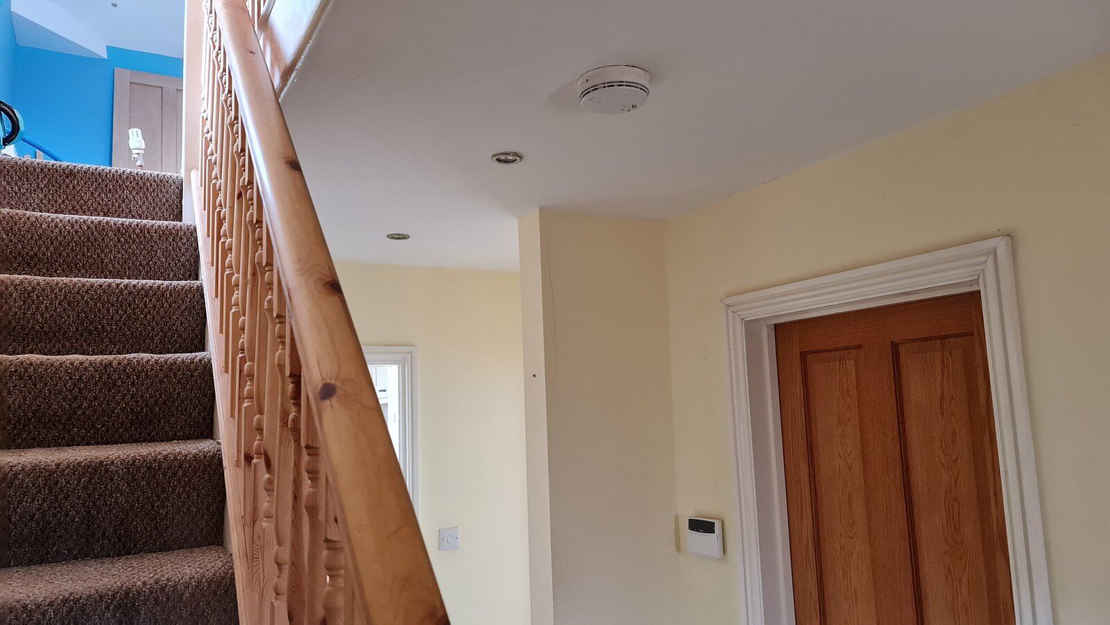

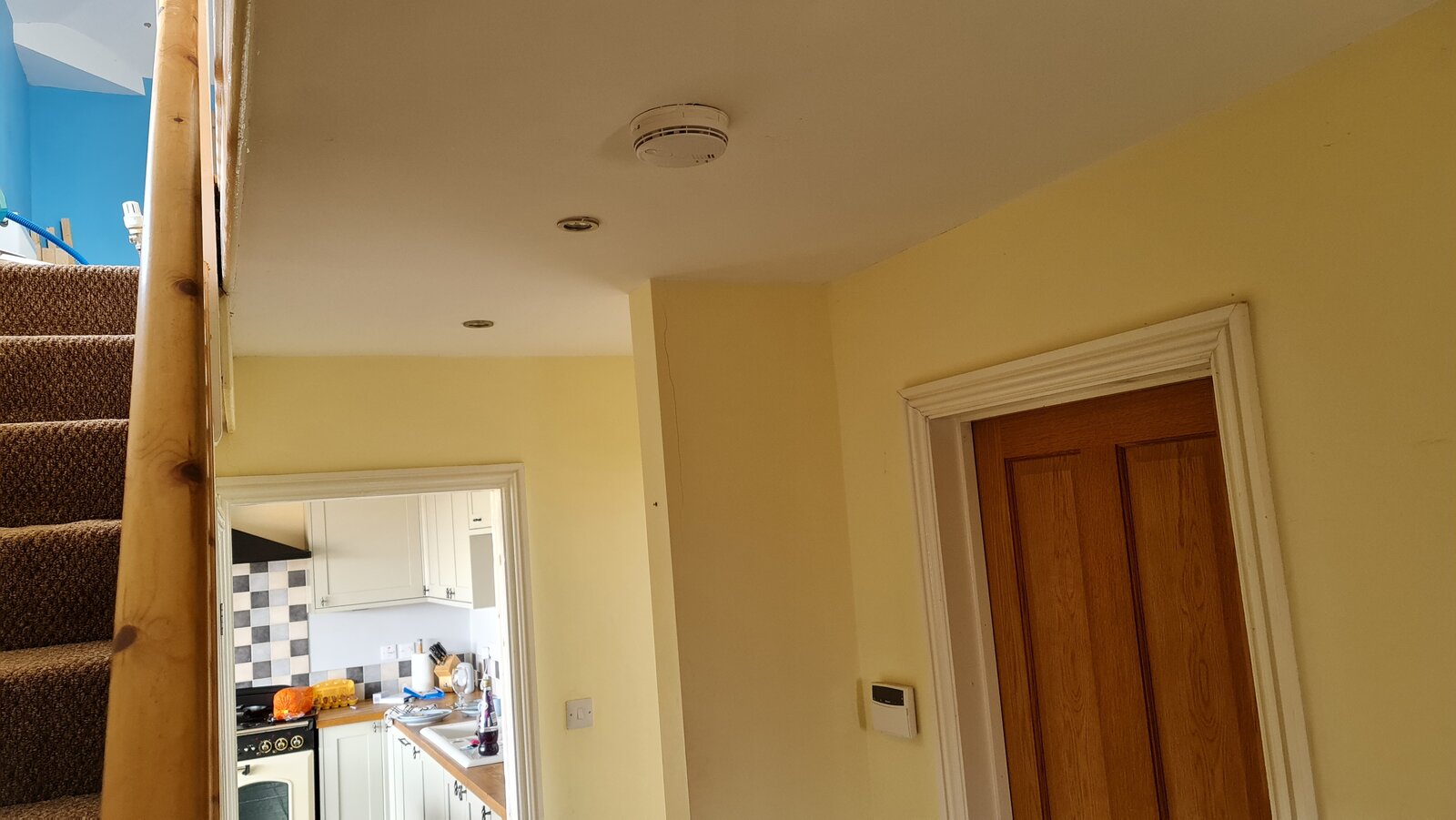

Hi all
Iv attached 3 pictures.
Opposite our stairs is a jut out of wall in the hall.. the piece of wall continues from the dinning room. We want to remove it. But im guessing there is nowhere for an RSJ to rest both ends on (just 1 end).
The wall inside the dinning room is a stud wall upstairs is a brick wall. So I guess there is a lintel there resting on the jut out of brick work in the hall. The little jut downstairs in the hall is brick... is there anyway we can remove that????maybe if we built the main room wall out of block???? Or did a block section if not the whole wall??? But can you then have an overhang of lintel with nothing under it or is that not allowed.
I hope this makes a tiny bit of sense with the photos. I won't be doing this myself but I want to know what would be involved so I can estimate a price and don't get ripped off.
Hope someone can help me

You can overhang a steel beam, as long as the overhang isn't excessive in relation to the whole span.
From what you say, I get the impression the brick wall in the hall is what is supporting the steel and the brick wall above - if the blue wall is a stud wall, then I don't think you'll be able to remove the solid wall in the hall ... unless there is enough wall still to support the steel, but, if that was the case, it probably would have been built differently ...
Yeah. I'm thinking we could take the stud blue wall down and do it back up in block... putting in a new long lintel across... so we can remove that part of the wall sticking out in the hall.
Or, remove the brick wall above - although the roof might be sitting on that ...

That's another good idea. How do you tell if the roof is resting on it. Is that dependant on the direction of the joists or any tell tail signs I can look for.
If I can work it out... then maybe just get a bricky to take it down...
Go up in the loft and see if there is a wall plate / wood sitting on it, although likely something would straddle it ....

Take a look in the loft - A large V in the roof timbers, with the bottom end of the V sitting on and above where the wall is, suggests the wall supports the roof.

I'd do a bit more investigation first, or rather get an SE to have a look - the existing wall with the two doorways might be enough to support the beam, possibly with a steel post set into the blue stud wall or some blockwork/a structural stud wall in place of a section of the stud wall to form a "T" - the reverse of what you have now. I certainly wouldn't be demolishing the upstairs wall.

Yes the old couple had knocked it through before. When we moved in we extended the house for a new living room so we split the room into a dinning room (blue room) with office on the other side.
