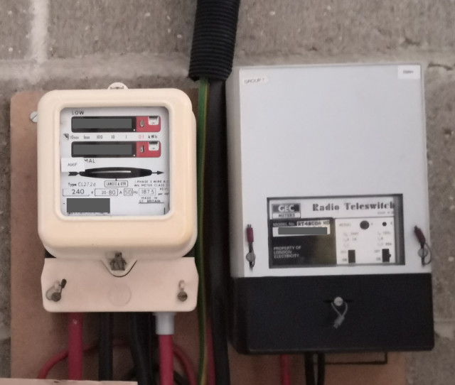

I haven't replaced my meter yet. Does the RTS turn off at the end of June affect lights and sockets? I don't use electric for heating. Will the turn off just means I won't get the economy 7 off-peak rate, or does it mean I won't get any electricity whatsoever in the off-peak hours? Thanks.
The RTS only provides power to off peak heating and off peak immersion heating through the separate consumer unit provided for those devices.
It sounds like you no longer have those devices? So the RTS switch off won’t affect lights and sockets.
If you aren’t sure, post pictures of the area where the meter is and of the consumer units etc.
PS Make sure you aren’t still on an Economy 7 etc tariff, and don’t need it. You may be paying over the odds for your 24/7 supply. Talk to your energy supplier to get that changed.

The hot water tank has immersion heater in it. But it is never used because the water and central heating are heated by gas. I am not sure if I have economy 7. When I send in the meter readings, I have NORMAL and LOW readings. The sticker on the RTS says GROUP 7. Is that economy 7?
Your electric bill will tell you if you are on E7. Or similar. How many fuse boards have you got. Picture of those with the cover flap open needed.

RTS Group number refers to the 'blocks' of meters that are controlled together by the different energy companies.
Get the meter changed. Even in 'dumb mode' smart meters can do some time related switching to control the household in a very similar way to the RTS.

I never had any devices using the radio signal. I changed the tariff to normal so when I give a reading the low and normal are just added up
AFAIK it will freeze in day or night mode, depending on when the signal is switched off. I'm in the same position, so I moved to a tariff (Octopus) with same rate per kWh day and night. Then it clearly doesn't matter which mode it freezes in (usage in the other mode zero).
