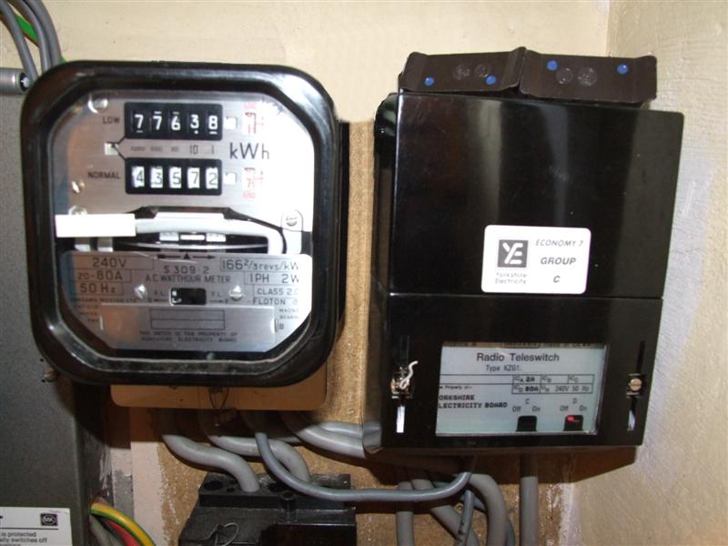

RTS currently will / should be switching the heating off peak circuits on/off in your home if you haven't changed the RTS meter to A N Other meter type.
If it stops switching you will have no heating live without an electrician by-passing something to connect up the two separate sets of circuits in your home. Regardless of electric tariff.
{A picture of your metering bits will confirm if RTS switching kit is still there.}

Most will have two meters as shown in this energy saving trust link https://energysavingtrust.org.uk/wp-content/uploads/2025/04/rts-meter-example.jpg.webp

Here was are responding to @DiyNutJob we are not really worried about any other systems, only his. He asks "Does the RTS turn off at the end of June affect lights and sockets?" simple answer not it does not. @Mottie made non-useful comments, but @Taylortwocities in #3 gave the answer. Plus extra advice and a request for pictures to confirm.
I rambled on, maybe I should not have? And @DiyNutJob posted pictures of his meter. @Taylortwocities again very good post referring to the bill, and asked for more pictures.
@Rodders53 came in with some good background information, and @Harry Bloomfield repeated @Taylortwocities for more pictures and also like @Taylortwocities referred to the bill.
@endecotp pointed out one could be over paying if times are wrong, and @aveatry referred to repeated adverts and letters, and @fixitflav and @Harry Bloomfield talked about rumours as to what may happen. @flameport then explained, as only he can, what is inside the units, and pointed out it is a very real problem, and I pointed out there were threads where this had been talked about in more general terms.
But we have not seen a picture of the consumer unit/s, however it does seem as far as @DiyNutJob is concerned unlikely to lose power, the only question is will he be overcharged. No real answer can be given until we get more information, it will be interesting to see what the suppliers do if someone is overcharged due to them not changing the meter on time, but I would think nothing, when I look at my bills.

BUT that meter pic is badly out of focus... and doesn't show enough of where the tails come from and go to (DNO cutout, consumer fuseboards etc.,.) imho...
Landis & Gyr two register meter... model type C12/2d? CI 2/2d? or something. Google finds nowt for me.
Bound to be well out of calibration and therefore overdue for replacement. (No date label(s) showing though; have they fallen off / been removed?)
Replace asap and all possible problems wrt RTS will go away.
