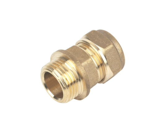

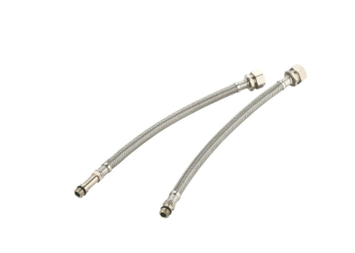

I am referring to the flexi tap tails like this:
where one end connects on to a fitting like this:
This uses a rubber seal connection as I understand it.

Just a light smear of silicone grease on the o-rings on the male ends to help them slide into the tap end is always a good idea and then just as tight as you can get them by hand. The female end doesn't need any. You have pictured compression ends on the tails, are they more like these with female ends?
th
If you are fitting them to the 1/2" end of the coupler, then hand tight and a 1/4 turn is all that should be needed. The 1/2" male end has a flat mating surface so shouldn't cut into the washer.
Yes, that’s the end on the flexi tails. Isn’t that the same as what I posted?
The female end of this goes on to the compression fitting I posted. It’s not a coupler as it has a flat mating surface.
Nope, your pic had compression ends on them but not to worry
It's called a 15mm compression to 1/2" straight coupler ;)
Unless you tightened it up like 2+ turns past hand tight I wouldn't worry about it. As the male end is flat it shouldn't have cut the rubber seal and if it's still dry then should be all good
